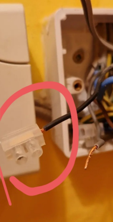

As before then, link the black wire (just for clarity - previously linked to grey at thermostat) to the load L terminal of the FCU and see if everything is still controllable!
We eagerly await the results!
Yikes... Linking up the black wire didn't work.. The boiler won't kick in even on manual.

I would put the cables back, and then for proof, keep the thermostat off, but bridge L and terminal 3 on the back plate, if the heating is controllable after that, then we know the cable tracing may be the problem.
If it doesn't work after putting the cables back, a connection may have been disturbed during the investigation.

So…I’ve just been back to the house and the cable from the thermostat to the FCU is wired thus:
  • Black wire (sheathed blue) at Neutral in the Thermostat goes to Black (sheathed blue) into the FCU load.
  • Brown wire at Live in the Thermostat goes to Brown FCU load.
  • The Grey wire (sheathed brown) at the thermostat goes to the chocolate block (in the FCU) connection to the black wire that goes to the boiler.
Hi there.. I've managed to get back to the house briefly and have spent longer belling out the wires. I was wrong about the above Brown wire in the thermostat. It's actually linked to the call for heat (CH On) in the timer switch.
The other 2 descriptions still stand.

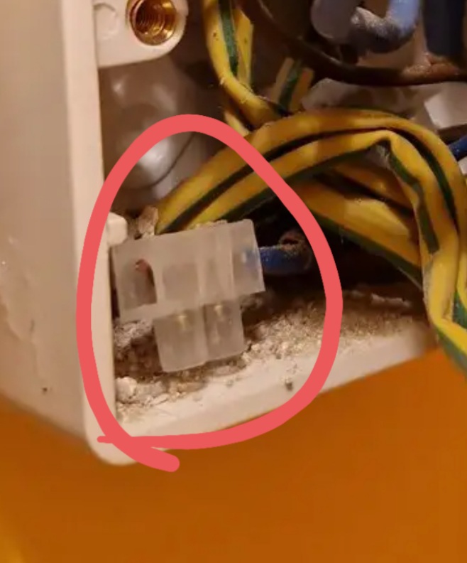

Great, this connection?
If so, that's more like it!
All you should need would be to link this terminal block, and the black wire to the boiler

Great, this connection? I think so yes, although the various chocolate blocks have now been moved around to get a better look at things.
