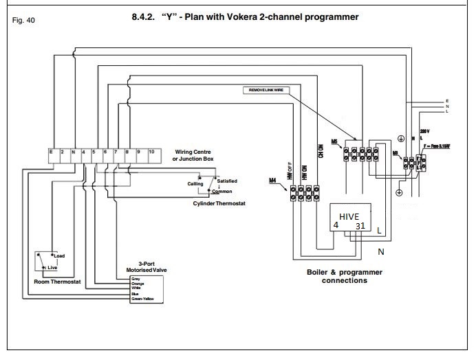

If I change to a 3 way can i use the existing wiring (I think/hope it maybe 4 Core) or do I need to run additional Wiring to the boiler to run this solution?
There's quite a bit of extra wiring to do, to the motorised valve and also the hot water cylinder thermostat. But remember the diagram below? It's the Y-Plan from Figure 40 from the manual you posted. But I've modified it slightly to show the Hive connected. This is what you would end up with.
Thanks Stem for that Really Appreciate all your Help. Im going to get a plummer in to sort out the System with a Y Plan solution.
