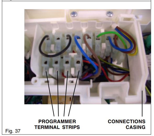

The 1st Pic is the Cable from Jnk Box to the Boiler
The 2 black cables 1st one is live and send one is switched Live from the timer

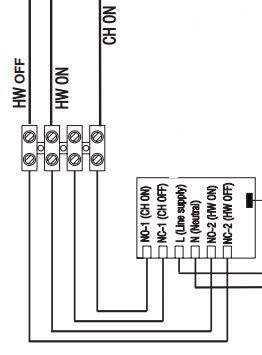

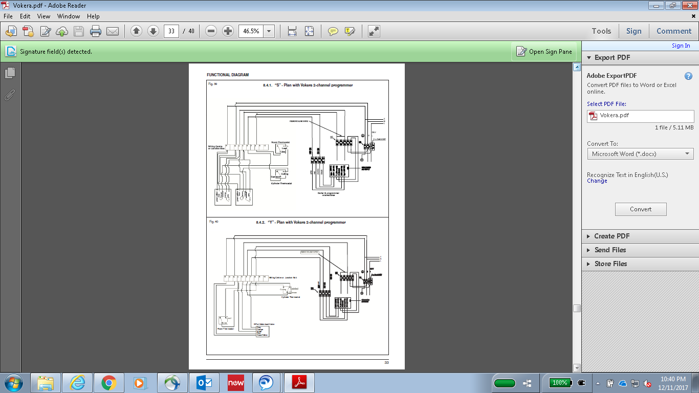

OK, so you say you have a 'Y Plan' with a single 3 port valve, and the large diagram you have posted clearly says "Y"-Plan with Vokera 2-Channel programmer, so if that drawing is correct, and represents actually what you have, then you will see in figure 40 a small terminal block connected to an inbuilt programmer which I have copied below.
The markings on the wires (in the top left) correspond to the connections at the Hive Receiver, [You need the dual channel version of it] so would connect to it as follows:
Wire 'HW off' = Hive terminal (1) 'hot water off'
Wire 'HW on' = Hive terminal (3) 'hot water on'
Wire 'CH on' = Hive terminal (4) 'heating on'
The Hive receiver also needs a 230V supply to power it, this connects to the boilers main N, L & E terminals.
The 3 wires HW off, HW on & CH on, should be removed from the existing timer and only go to the Hive receiver. However, the 4 wires from the existing programmer will still be live, and so should be kept separate in 4 separate terminals to isolate them anything else.
Please check carefully to make sure that the wiring in the manual you have posted above does correspond to what you actually have, before proceeding.

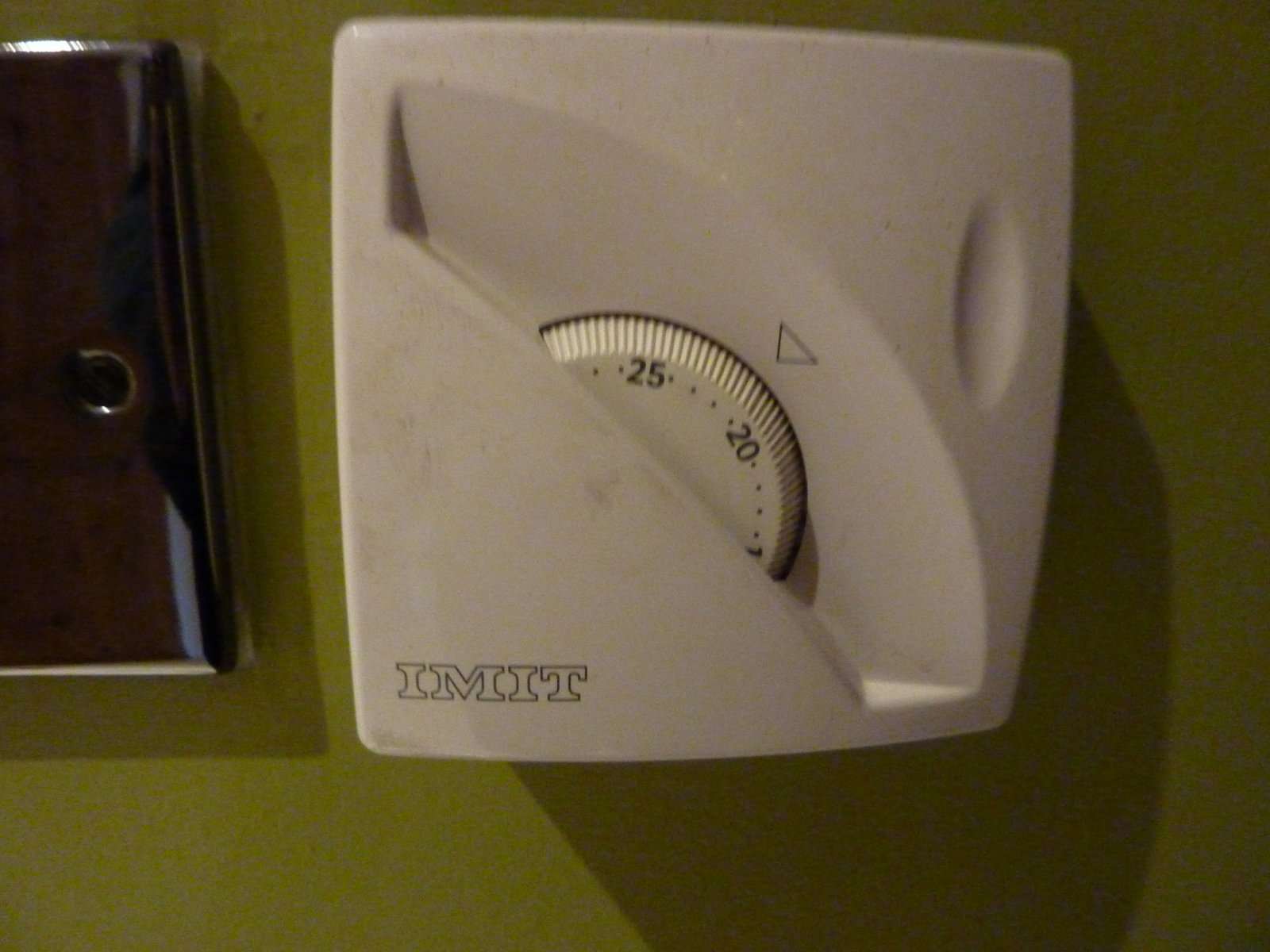

On the Thermostat
1 - First Connection is brown which is the switch live on mine.
3 - second connection is empty
2 - third connection is Black Live
Blue is not connected just in a white connect block
I google the thermostat wiring below IMIT TA.3

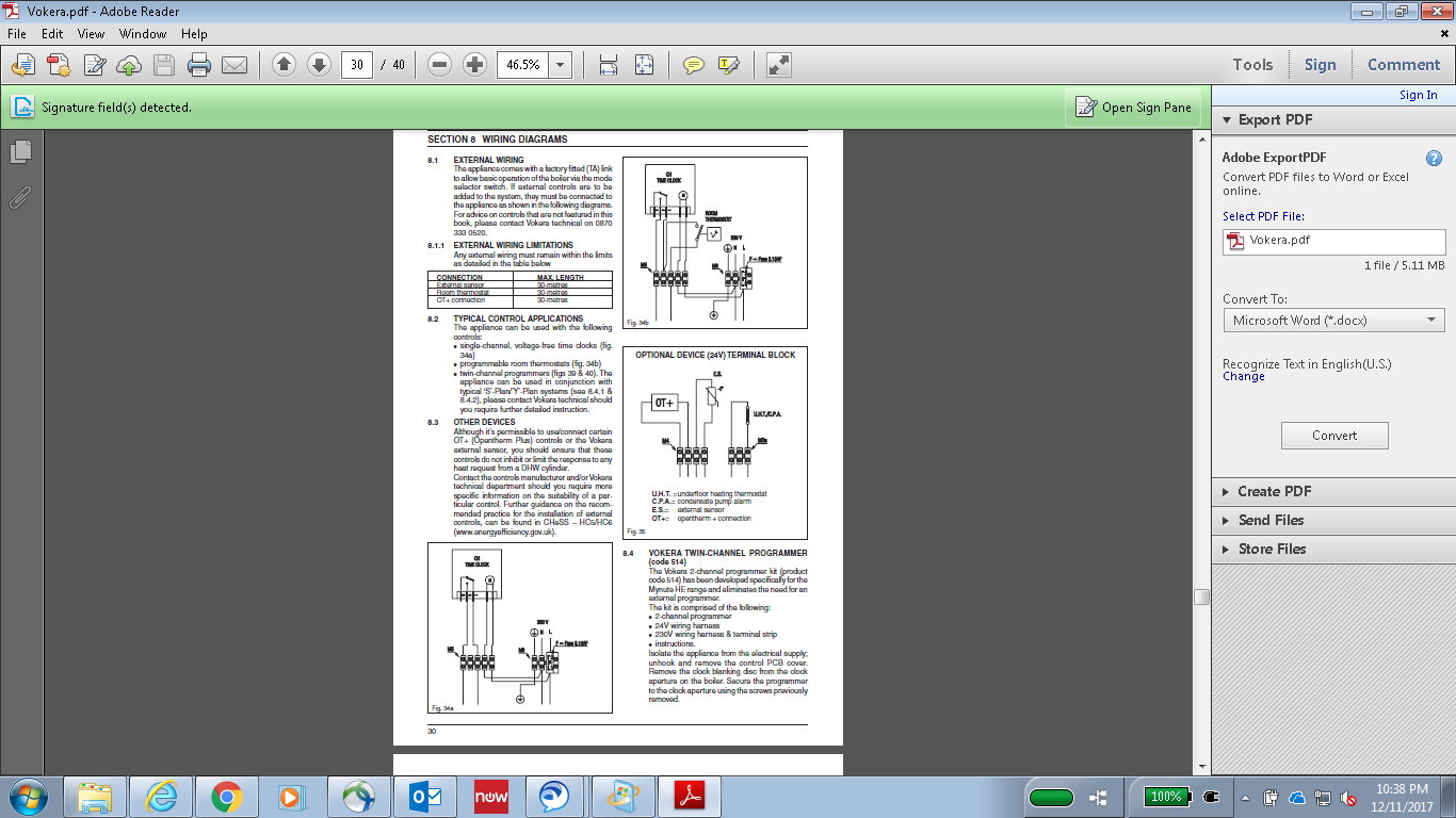

Just reading the manual. The 4 Gang connection block in your pic I cannot see it in my boiler, So do I need to put one in and then connect the wires as per diagram and then to the hive ? Also I cannot see any connection from the thermostat to the Boiler (I think they did a botch job) It looks like just a switch for the Valve. ?
Gary
Actually it's from the diagram that you posted, which I assumed applied to your boiler. I just zoomed in on the bit that applied to connecting the Hive. ;)
As I said before I don't have any knowledge of your boiler. and could only offer my original advice based on your wiring diagram. If your boiler isn't actually like that, then I can't help I'm afraid. Unfortunately photos of wires without any markings doesn't help. It would be a bit like me showing you a photo of a road junction you have never seen before with out any visible sign posting and asking where each road goes.
However, if you can find the correct wiring diagram for your boiler that represents what you actually have, then I might be able to help.
The room thermostat is easier, the wires in terminals 1 & 2 should be connected together either at the thermostat, or by removing the two wires from their origin and then linking together where they came from. But you should check that it is actually connected first. Does it work presently? Although this bit is irrelevant at the moment if you can't connect the Hive in the first place.

The docs Im posting are from the Vokera 35HE install manual so it should be correct
I Just want to rip out the Thermsotat and Timer if I can and just use Hive
But it doesn't seem to be correct. When I referred to the drawing that you posted from the aforesaid Vokera 35HE install manual, you replied with..
The 4 Gang connection block in your pic I cannot see it in my boiler.
I didn't think the manual you posted was right for your version of the boiler, because if you remember I queried the fact that there was just what looks like a single timeswitch on the front of yours and not the facility to have separate time control for the heating and hot water. But the title at the top of the drawing from the manual states "with Vokera 2 channel programmer" which is what I would have expected.
Maybe there have been different models of it produced over the years.

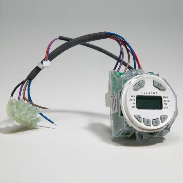

There are 2 timers you can get for this boiler The Vokera 2 Channel is a digital timer or
you can use instead of the Analog one.
Thats the 4 gang connector I think there referring to there is also a connection onto the PCB.
That programmer looks more like what I would expect to find. A programmer with 2 channels, one for the heating and one for the hot water. The single channel timeswitch would probably be meant for a system that only has only one use, such as just heating, without a hot water system connected.
