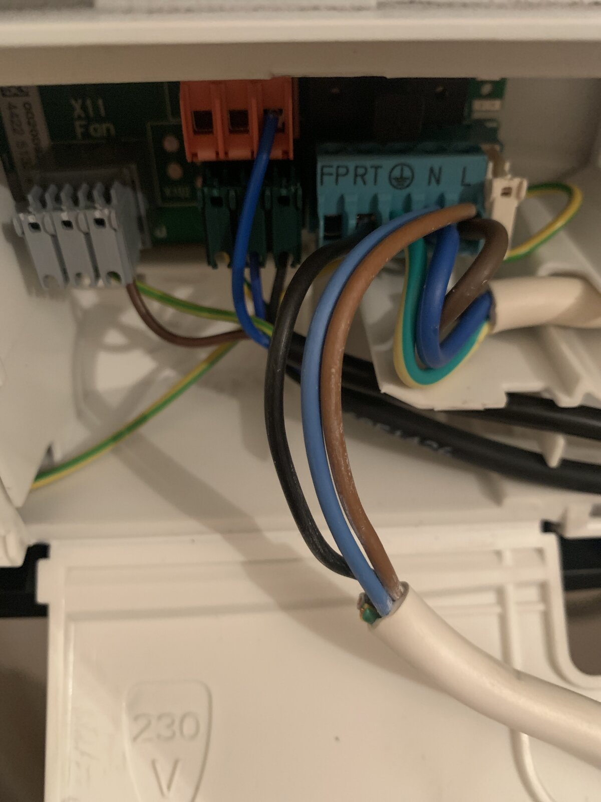

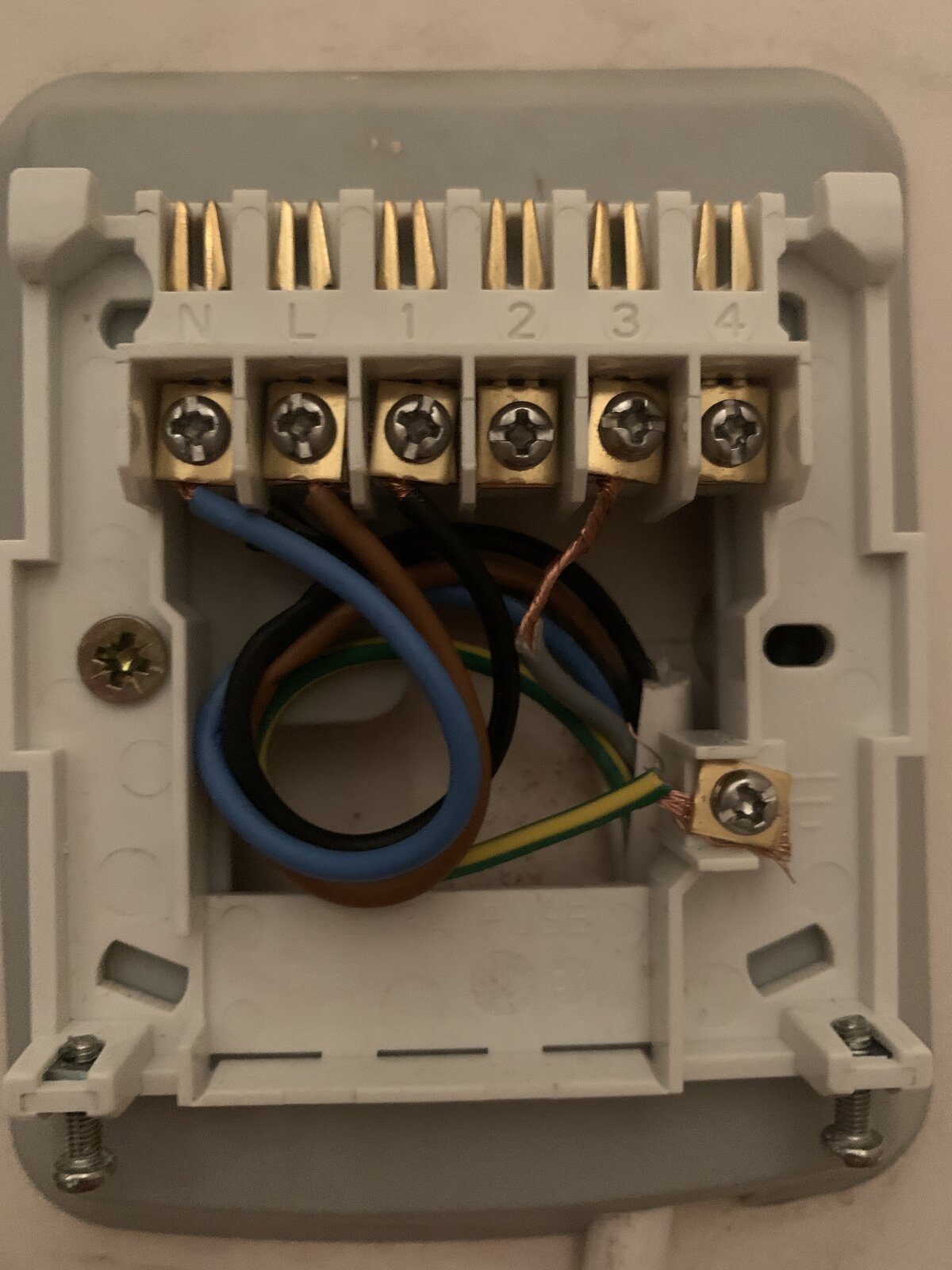

I have today wired up the Hive thermostat, receiver and hub.
Connected up the wires how they were on the old receiver and now the boiler is not working. Works from the main thermostat to receiver, but doesn’t action the boiler.
Have now taken off the plate on the boiler and can see that the actual grey and earth wire has been cut..
Please help!

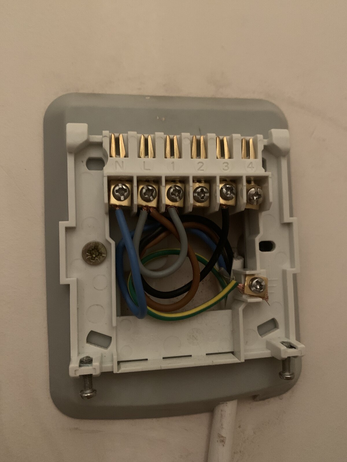

Put the black wire in 3 and a link from L to 1. And get rid of that grey wire that has been stripped back far too much.
image.jpg Thank you John.
Is this now good to go? Don’t want to be blowing up ha ha!
Also, do I not need to do anything with the earth wire on the receiver has this has been cut in wire at the boiler ?
