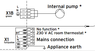

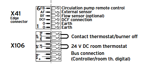

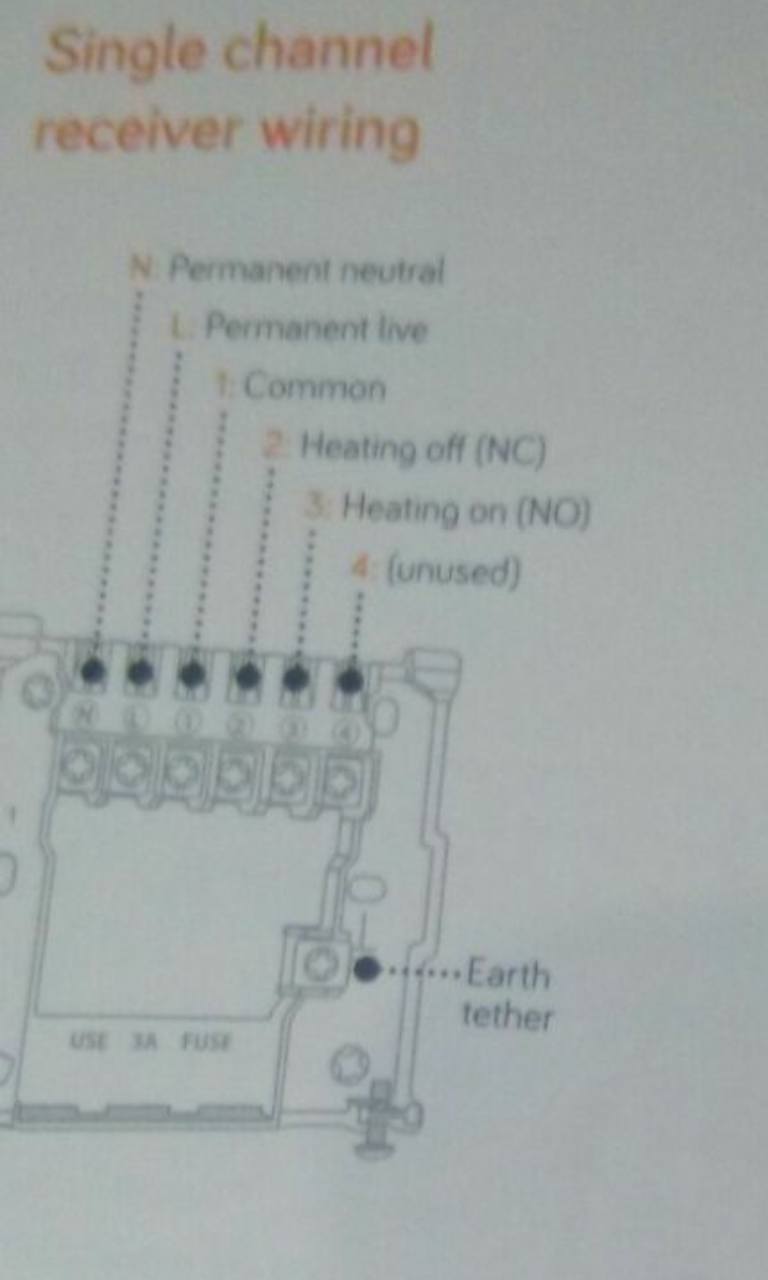

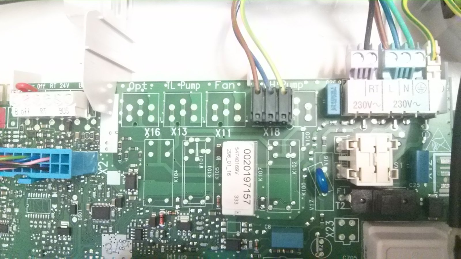

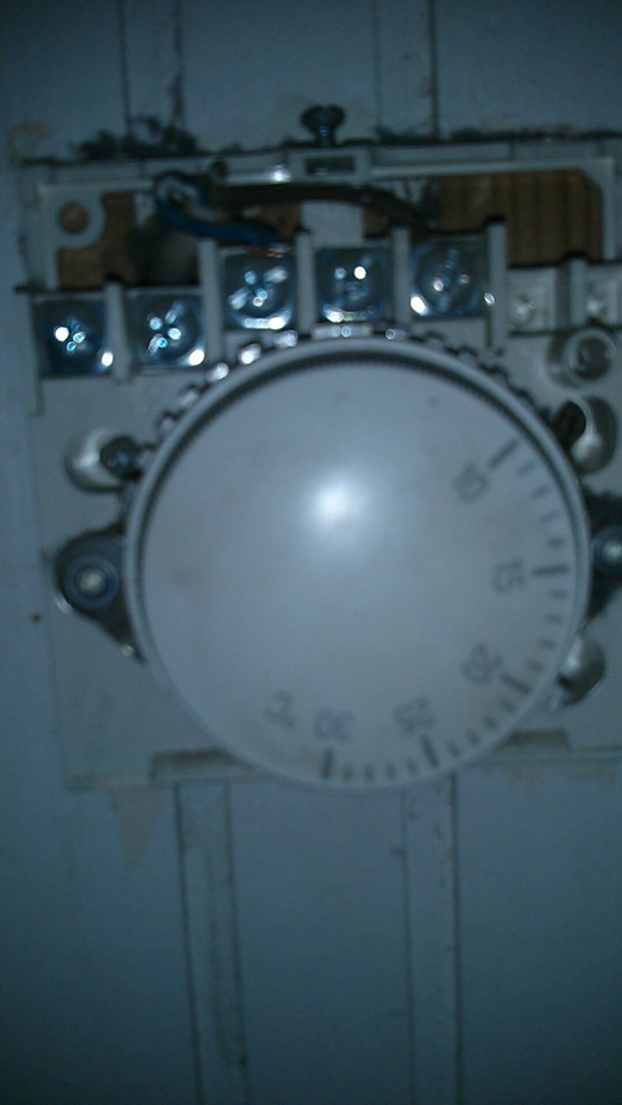

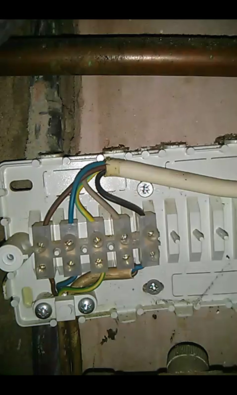

hi was wondering if anyone can help wire up this hive Thanks.
1st picture is of the boiler wiring.
2nd picture is what's coming from the 3amp fuse power to boiler.
3rd picture is of the current heating control.
4th picture is of the hive diagram.
boiler is vaillant ecotech pro 28
thanks

Looking at the instructions I have found it would seem there are two options the eBUS would be best but your would need Nest not Hive to do that, and other is 24 volt but it does not seem the existing thermostat is 24 volt so some thing is wrong, however from what I am lead to understand after the junction box is opened it needs some gas tests, so likely you will need a Gas Safe guy to sort it anyway. However it seems to me wrong if you need to pay some one to fix it, to use a cheap and nasty Hive, may as well fit a proper modulating type.

The grey wire in photo 2, where does that go and what is it connected to?
The easiest thing to do is to wire the following as I have a very similar setup at home:
  1. Buy some 4 core flex
  2. Disconnect the black and grey wires in the boiler coming in from the mains flex and safely terminate them.
  3. With the new 4 core flex
    1. Take the brown wire of the 4 core flex and join the"Permanent Live" terminal of the Hive receiver to the "L" terminal with the existing brown wire inside the boiler.
    2. Take the grey wire (sleeved blue) of the 4 core flex and join the"Permanent Neutral" terminal of the Hive receiver to the "N" terminal with the existing blue wire inside the boiler.
    3. Take the Yellow/Green wire of the 4 core flex and join the "Earth tether" terminal of the Hive receiver to the "Earth" terminal with the existing Yellow/Green wire inside the boiler
    4. Take the black wire (sleeved brown) of the 4 core flex and join the "Heating on (NO)" terminal of the Hive receiver to the "RT" terminal inside the boiler
    5. Make a short link between the Permanent live terminal and the Common terminal inside the Hive receiver.
  4. Remove the old thermostat, terminating the wires in a thin 16mm single gang surface mount box with a blanking plate.
(If you wish to not have a back box with a blanking plate where the old thermostat was, trace the old thermostats wires back and then disconnect and remove them at the other end. Then trace each core of the disconnected thermostats cable at each end with a multi meter that has a continuity function and a long piece of wire to make sure you have the right cable disconnected.
It may be the right most cable coming in the bottom of the junction box in photo 2 what feeds your old thermostat, but I can not say 100% for sure from your photos.)
Regards: Elliott.

thanks for your help with give that a go soon and report back

do I need to do anything with the red looped wire 1st picture. thanks
