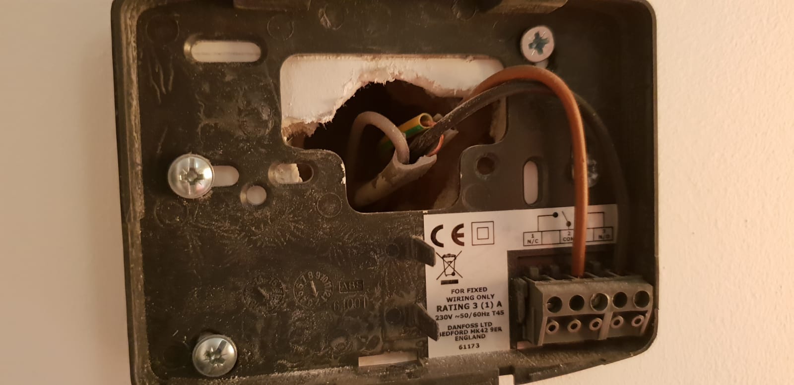

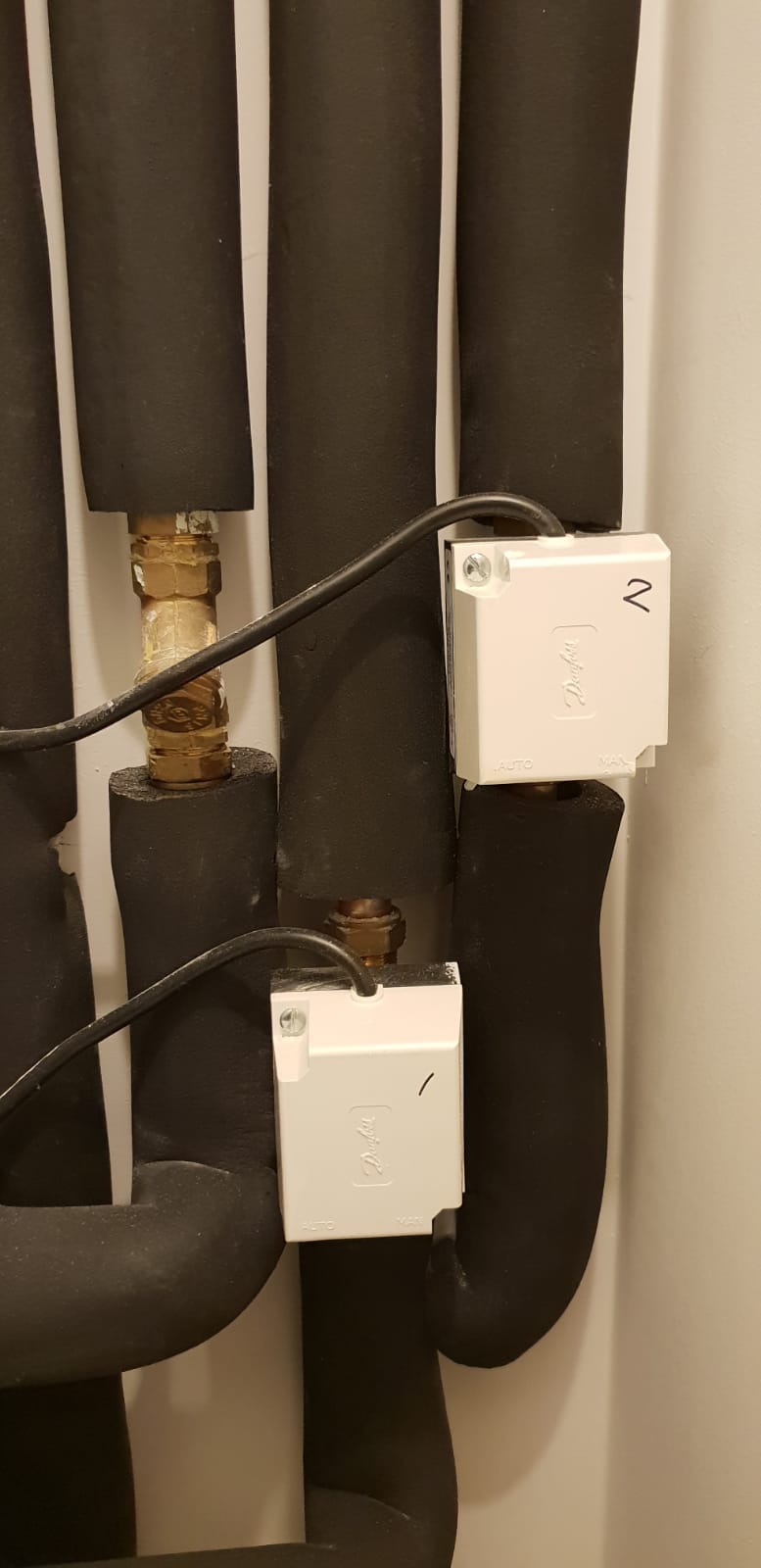

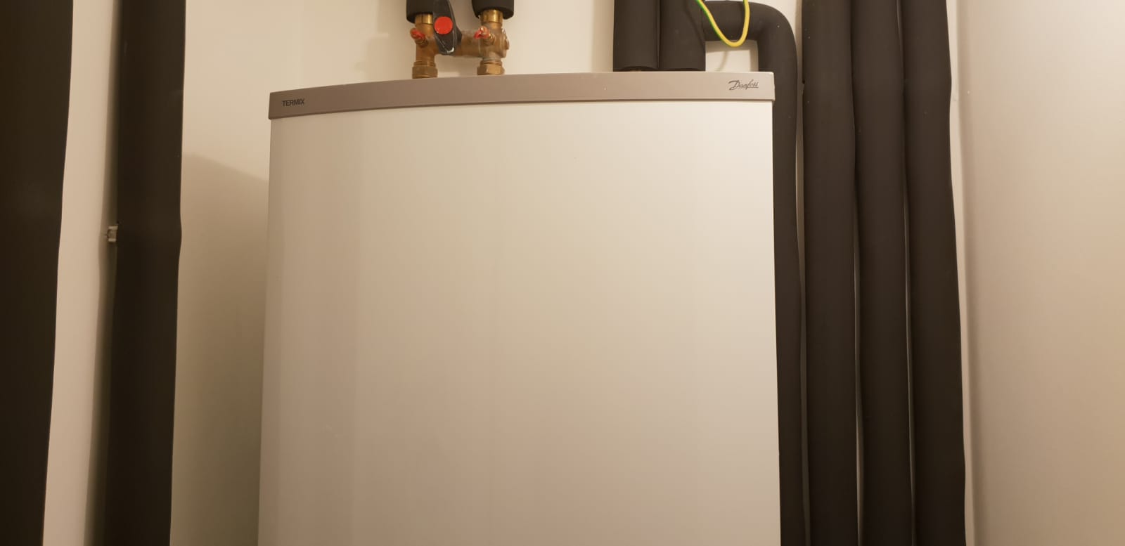

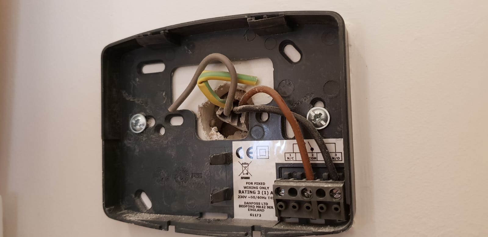

I currently have 2 Danfoss TP5000 (one for living room kitchen and the other one for the rooms) and 2 motor valves.
I couldn't found the controller probably is located somewhere in the boiler itself.
Please see image.

Boiler:
The cables behind the two Danfoss TP5000

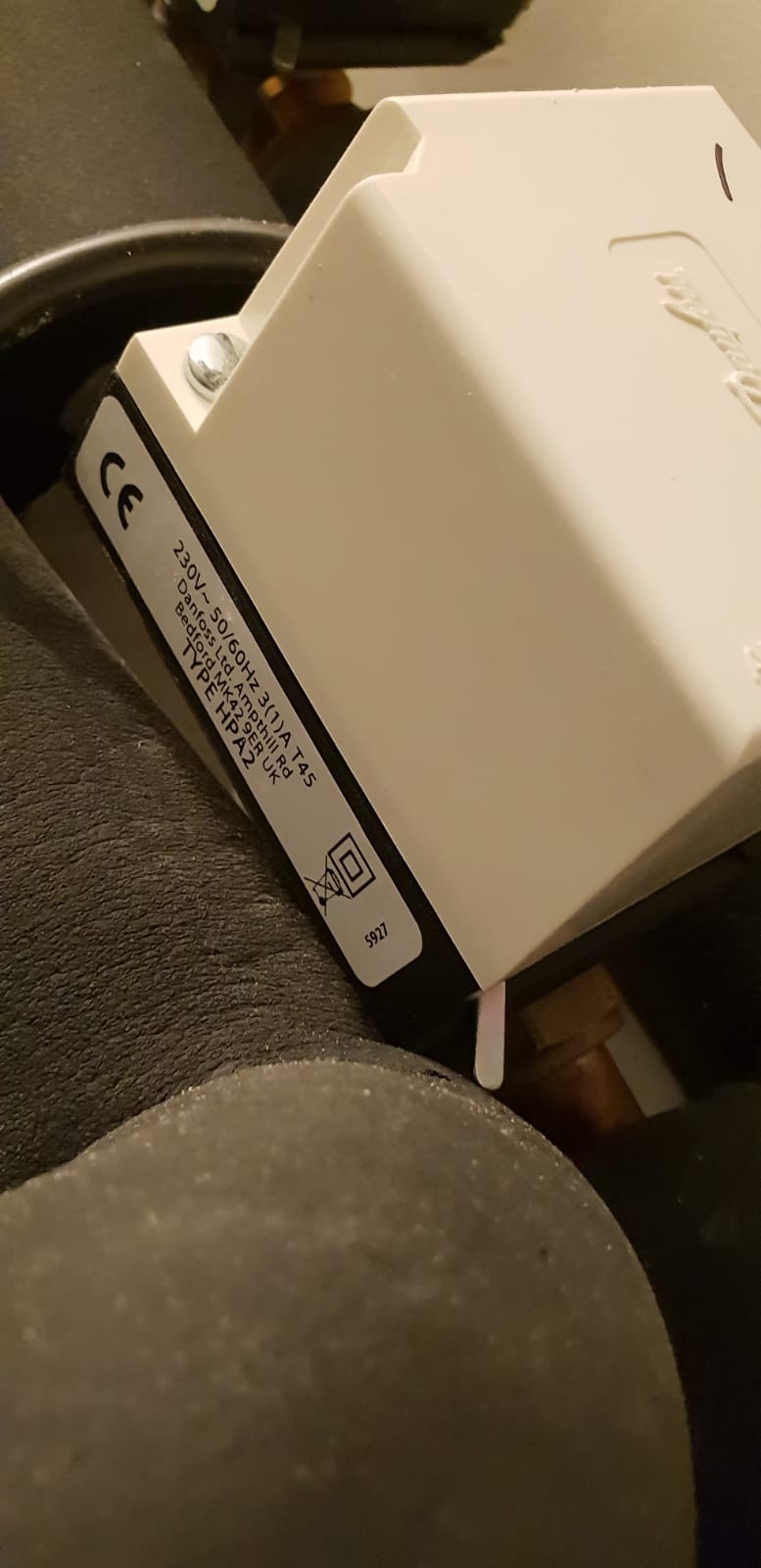

The Motor valves

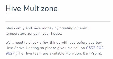

I would recommend calling Hive direct, they have a special advice line for this very thing. I have posted the details for you below. They will ask you the relevant questions and recommend a product. In addition to the heating, they will want to know about you hot water system, if you have a combi boiler for example, or hot water cylinder.
Once you have the product, because you have a working knowledge of electrical circuits, it should be fairly easy for you to wire them in. Each thermostats is just a simple 'on' & 'off' switch, and you will be replacing an 'on' and 'off' switch with another 'on' and 'off' switch.
