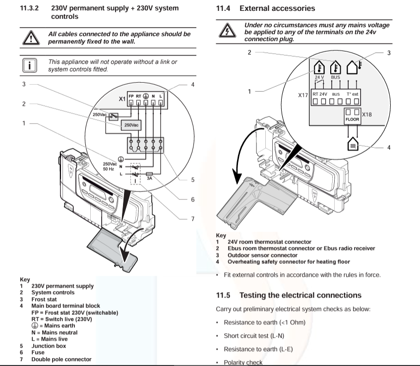

Agreed, it's very clear. Obviously installer didn't know that the dual channel hive is internally bridged and sends a 240V SL.
Rab, 4 tags on the back plate, twin channel. Only a fool would assume it is not 240 volts on NO or NC since there is no C

Honestly @TheEraser , even with the "the receiver should only be sending 24v" comment - no receiver even sends 24v - they are either a 240v SL or they are dry (0V) contacts, they don't 'send' anything they only throughput the signal from the boiler. He owes you the cost of 2 boards plus any time he charged for - it's a full refund IMO.

I think you just need to play hard ball if he moans about it. Tell him you'll get an independent survey and HIVE in but you have been made aware that the HIVE is working as it should and that it was all him that -
a) should have known that it was the wrong HIVE for the boiler and if he then wasn't familiar with it, shouldn't have even attempted it and should be anywhere near boiler controls
b) continued on regardless and then wired it incorrectly and the correctly working HIVE sent a 240v SL into the 24V low voltage side of the PCB and fried it
