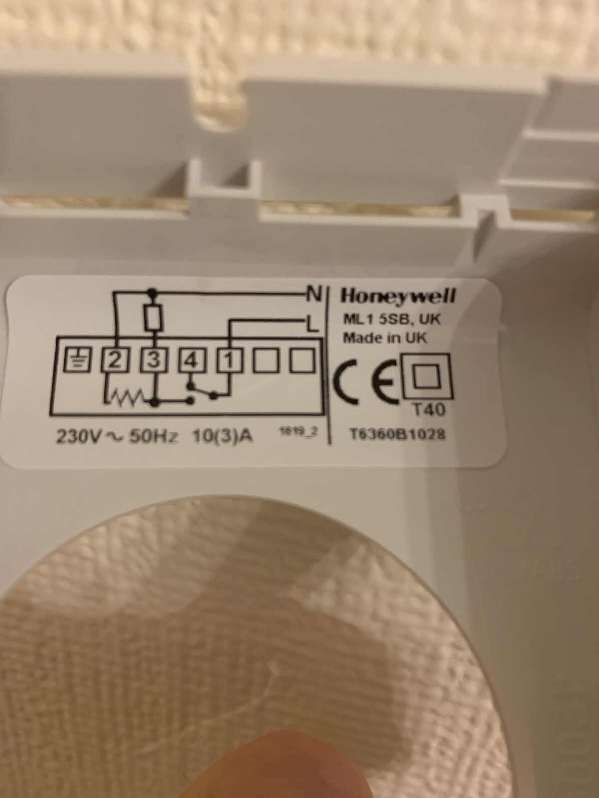

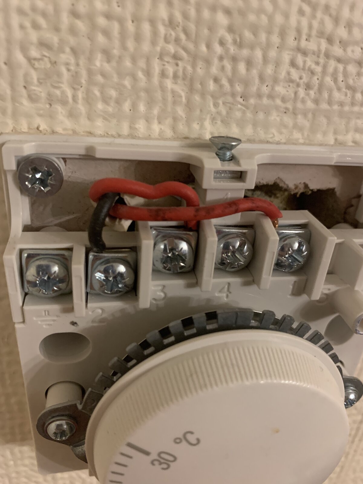

Thermostat is Honeywell T6360B 1028 and it has three wires connected to it:
terminal - wire colour
earth - none
2 - black
3 - red
4 - none
1 - red
5 - none
Cables from the thermostat end up in a wall cavity where the EP2002 controller was installed. In there they were twisted 1-1 to another three wire cable which again was going back into the wall. I assume that it was going to the PCB on the boiler. In order to investigate and identify the cables (as two are red) I had to untwist them and then connect them again using Wago connectors.

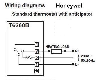

1. The wires in the Honeywell T6360B thermostat terminals are:
In your case:
Red wire in Terminal 1= Live
Black wire in Terminal 2 = Neutral
Red wire in Terminal 3= Switched Live
2. Trace the thermostat cable back to its origin. Unfortunately as I said before, where it’s connected depends upon the preferences of the original installer.
3. Take take a photo, or make a note of where the red wires that go to the existing thermostat terminals 1 (Live) & 3 (Switched Live) originate from
4. Disconnect all of the wires going to the old thermostat and remove the cable and thermostat.
5. Insert a wire link between the terminals where the Live and Switched Live wires have just been removed from, so that they are now electrically joined together.

As a temporary measure I will place connector box into the cavity where the EP2002 was and connect both red ones (Live and Switched Live) in there. That would allow me to deinstall thermostat for now.
Next weekend I will try to trace where those wires originate from. I have an idea where it might be but there is no access to this space :( at least I'm unable to find it now. Cables from pump and valves go there so I treat this as an indication that it might be a right assumption that this cable ends up there as well.
