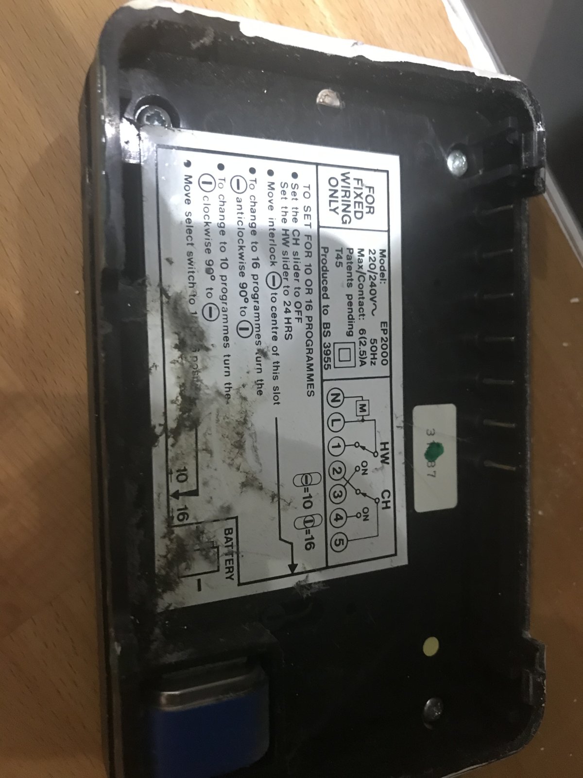

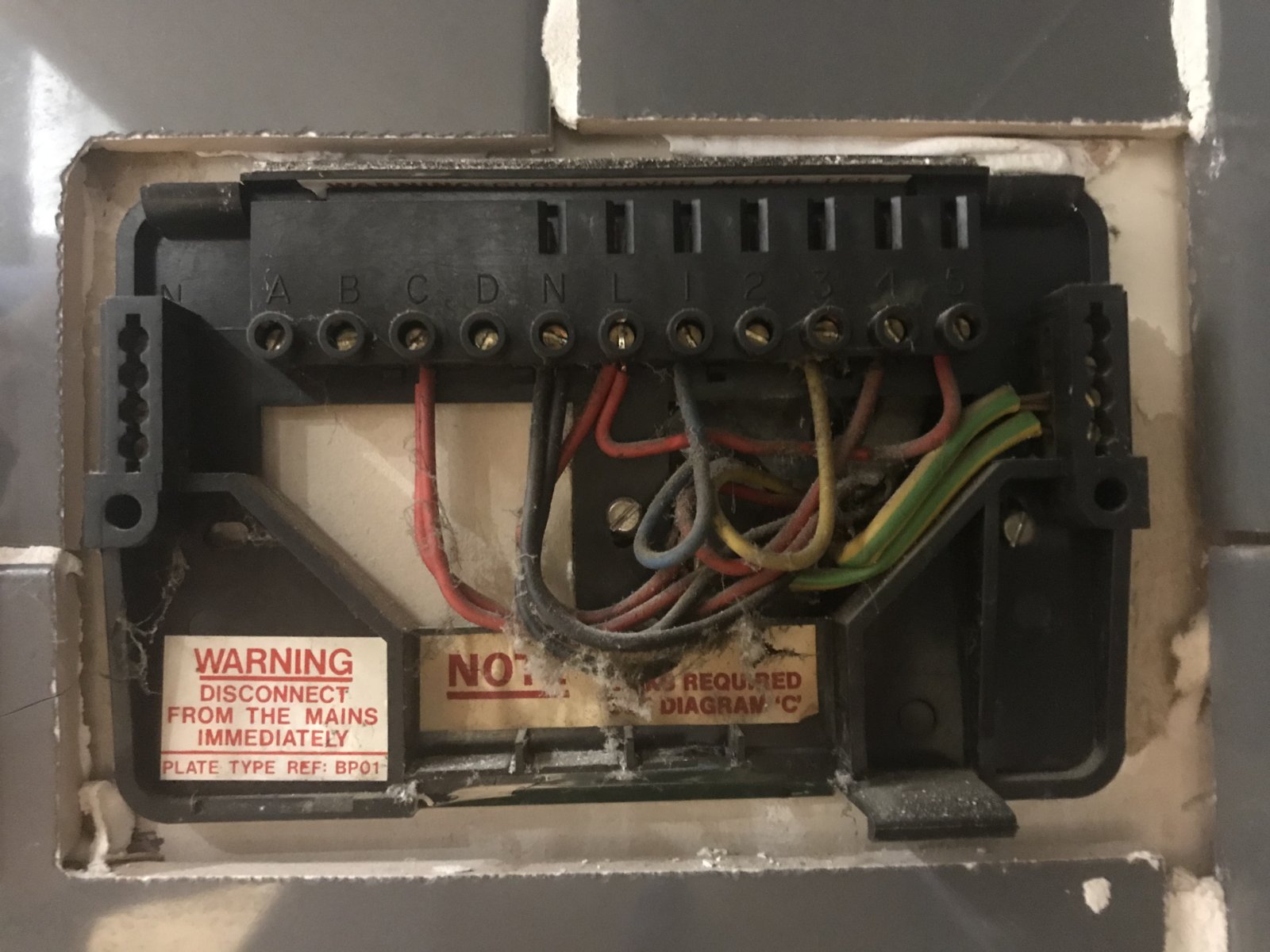

I’ve recently bought Hive and want to have ago at installing it myself. I have a basic understanding of wiring and once I can figure out what does what on my old programmer I'm sure it’ll be fairly straight forward.
Can someone explain to me what (if possible) these wires are doing?
Thank you.
N and L are self explanatory.
1 is HW OFF
3 is HW ON
4 is CH ON
5 is Common
