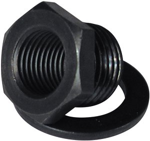

When you need to have two holesaws with both the different thread sizes on the same arbor, you want this...
http://www.starrett.co.uk/shop/hs_accessories/oopsarbor/
http://www.amazon.co.uk/Starrett-OOPS-Arbor-Hole-Enlargements/dp/B001LFBJKS
If you then added the little thread size adapter thing you get in holesaw sets...
...then you could have two of the larger size threaded holesaws on the 'oops' arbor.
Gaz
I dont get that, in the picture it has little and big thread, so why cant you fit any of the two thread size holesaws
You can fit a 20mm holesaw inside a 70mm holesaw with their different thread sizes should you want to do so with the reload bosses.
Rf can you fit say a 50mm and a70mm with the larger threads on to that RELOAD, I forget now
that starrat oops arbour looks like you can, yet the text says you cant
Yes the boss has enough thread so you can fit two holesaws with the larger thread pattern inside one another on the same boss.
