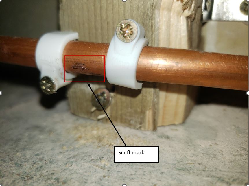

Scored 10mm LPG pipe
13 Feb 2025
255
6
I have accidentally scored (with the drill chuck) a live 10mm LPG pipe. I checked and there is NO LPG smell and I cannot hear any leaks. See attached pic with annotated area where scuff mark is. The black bit is NOT a hole just black score.
The LPG pipe is just used for a gas/electric cooker and is under a kitchen cabinet.
The 47kg LPG gas pipe is about 8m total starting at 15mm 7m copper (outside the property) then terminates to 10mm 1m long (inside the property).
If the 10mm pipe scuff cannot be repaired then I could drill a larger 20mm hole and fit a new 15mm pipe (from outside to inside) then connect up to the gas/electric cooker. The same 15mm copper pipe could then be T-eed (T'ed) off to run another 4m to the gas cooker in the lounge.
So my 2 options are
1) Repair the scuff. Maybe get a LPG/gas engineer to clean then put lead/solder?
2) Drill a 20mm hole (from inside to outside) and fit another 3m 15mm gas pipe then pay a LPG/gas engineer to connect up the new 15mm gas pipe tail?
Which one?
Advice please

Option 1
I've repaired worse than that.
As mechanical damage goes that's a bit meh - try harder next time! :)
Forum rules are no posts that might encourage DIY gas work.
Yes, a Gas Safe person who can work on LPG. Simple fix though.
I arranged for a gas cert engineer to come round. They tested for gas leak (think they said a monometer) and there is no gas coming out they said it was fine as is. I arranged for them to come round again and drill a bigger hole through the wall to fit a 15mm copper pipe through upgrading from the 10mm. They never turned up. I think drilling a 22mm hole through a 2 walls + stone cladding put them off. So I'm going to drill a bigger 22mm hole through the wall myself. Then get another plumber to come round.

If I struggle to get a gas cert engineer to come out and repair what temporary fix should I put on the scuff to 'shore up' the scuff? Bear in mind the gas safe engineer did say there is no leak. Belt and braces approach really to make sure.
He also said it's fine as it is. So why worry unnescasarily
Just leave it. If it worries you that much get him out now to repair it.
Fair enough
I'm going to drill a larger 22mm diameter hole through the exterior-to-interior-to-kitchen wall to allow, in future, a larger 15mm LPG copper pipe to come through to feed both the cooker and tee off to the lounge fireplace
Should I put a sheath in the resulting hole? The gas cert engineer said he uses 22mm copper pipe (acts as a sleeve) to sheath a 22mm hole before putting 15mm pipe through.
I have either 22mm copper pipe or 22mm hep2o (plastic) pipe, which should I use to sleeve the resulting hole?
Either one, but the fitter might have a preference.
