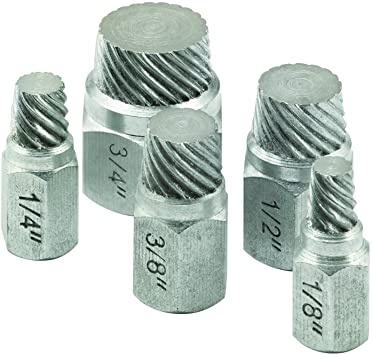

My ones are something like these. Snap-On I think - I've had them years and they work well. Never had one break on me.

I`m waiting for these one
https://www.amazon.co.uk/gp/product/B00AIJ0VDE/ref=ppx_yo_dt_b_asin_title_o00_s00?ie=UTF8&psc=1
But if you guess that are too long and can snap ca try to get the short one like yours. Do you have any link where can get them?
