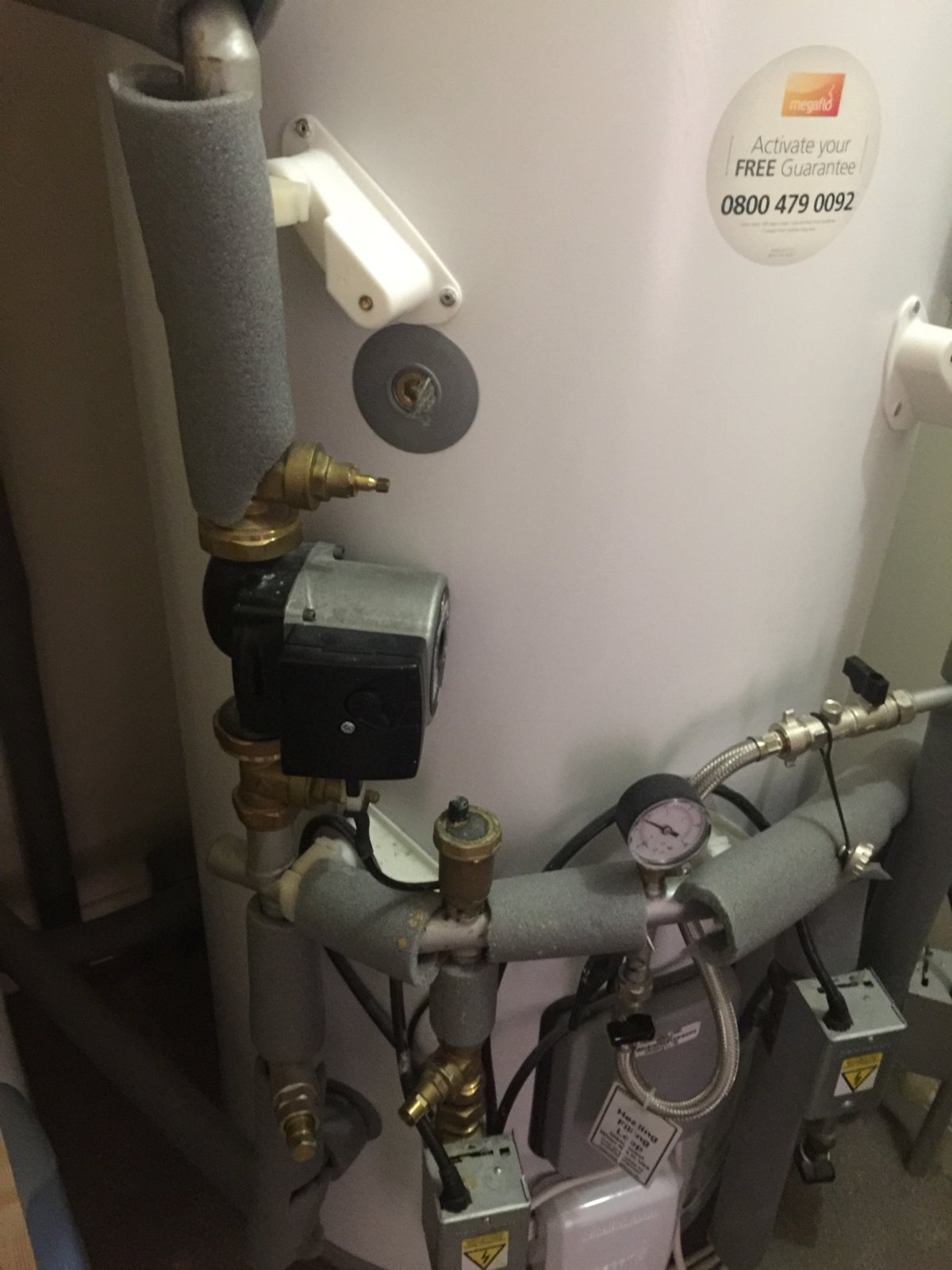

I’m thinking of going for the Honeywell Evohome in my house and while I understand the logic behind it I’m struggling in what I need for it to work seamlessly in my house with my current heating and water setup.

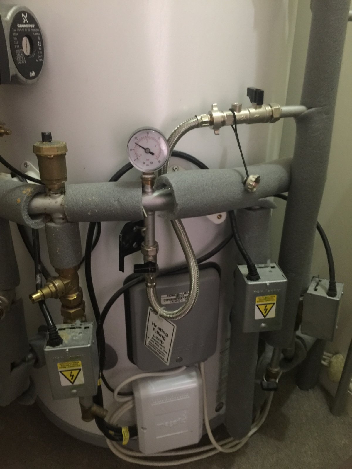

I have an unvented water cylinder in airing cupboard and a potterton promax SL boiler in cloak room downstairs. The water cylinder has two Honeywell zone valves (one for downstairs and one for upstairs heating). There is also another valve as you would expect for the water system. I see you need the relay box which comes in the kit to connect to the zone valves - would I then need two of these to connect to each of my valves?
For the hot water Evohome kit I see you can get a sensor that actually goes in the cylinder - there seems to be a blanking plug on the side of my cylinder in the picture below. Is this to allow for something like an extra sensor to be immersed in the tank?
The zone valves at the moment are controlled by danfoss controllers (one downstairs and one upstairs). The downstairs controller also has a temperature sensor in the lounge as the controller itself is right by the boiler in the cloakroom. Just trying to get my head around how it would be set up (understand the TRV side of things on the radiators) with my system and if it is even possible as it’s not cheap but if it worked properly would be very beneficial in our house and for our lifestyles.
Here is the unvented setup in airing cupboard upstairs and in second picture you can see a brass blanking plug (I think) - is this where I could locate the sensor for the water probe?
Thanks for looking

I’m looking at individual room temperature control for all my rooms and getting rid of my old controllers in the house.
