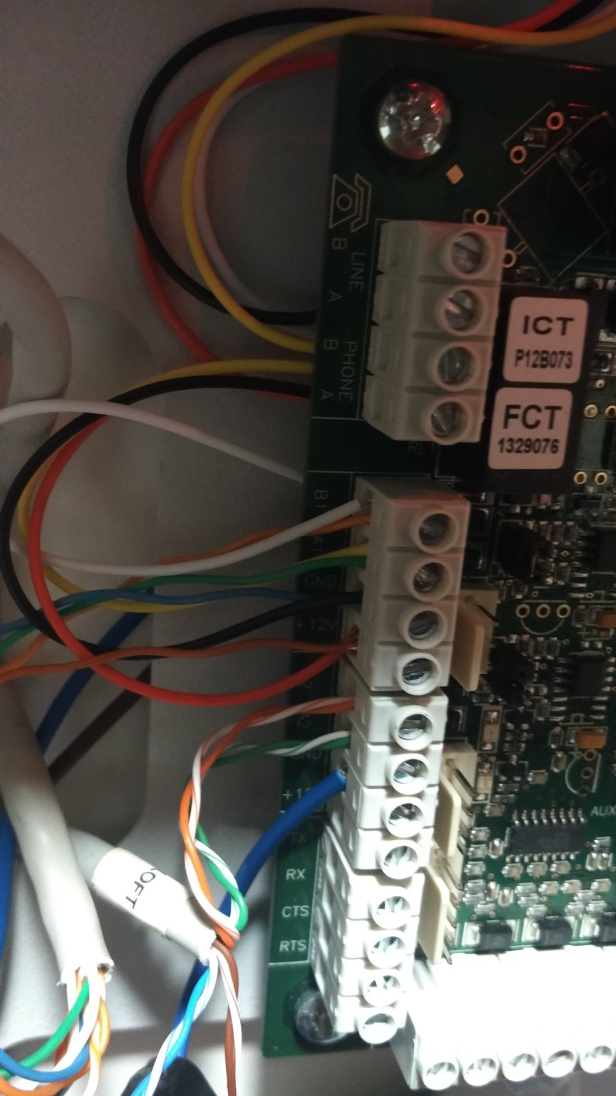

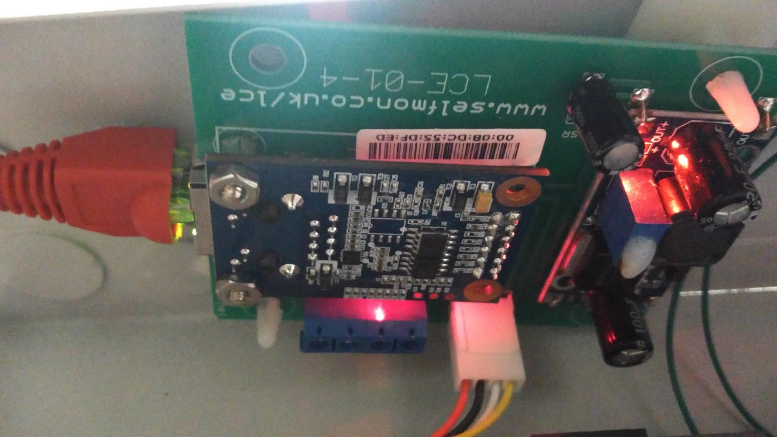

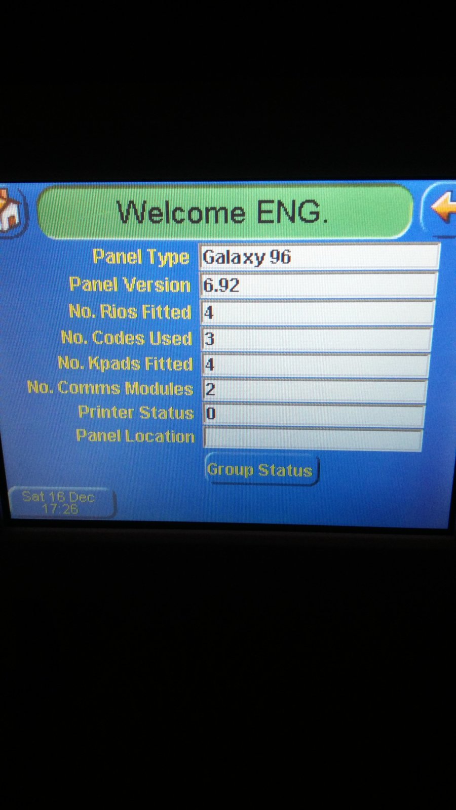

Setup is in images below...
IP is set to 192.168.1.251
Gateway is 192.168.1.254
Subnet is 255.255.255.0
Can't see it appear on my router as connected devices but the cat5 cable is working fine for my laptop
I have two touch centers and one Mk7 , so 3 physical keypads, 4 are showing on the system (if I've understood correctly) so keypad side seems fine, but not network side.
Lce is showing two red lights plus solid green network +flashing orange.

I think you have yellow and white the wrong way? Yellow to B. It's actually easier to wire the lead into the screw terminals of the LCE module, then just plug into the header on the Dimension PCB (next to the terminal screws).
Sorted that issue... Not sure on the wiring colours, manual shows a yellow on back page, in the end I just used a piece of cat5, a to a, b to b and + to +, - to -. Went into and out of engineering and found new module, pinged from laptop and found something at the end.
The lid of the box has a label inside that details the cable colours. In your case white is A and yellow B. Anyway, hard wiring straight across is fine too. If you can see the module, then try connecting to it with the SelfMon Virtualkeypad app for iOS or Android.
