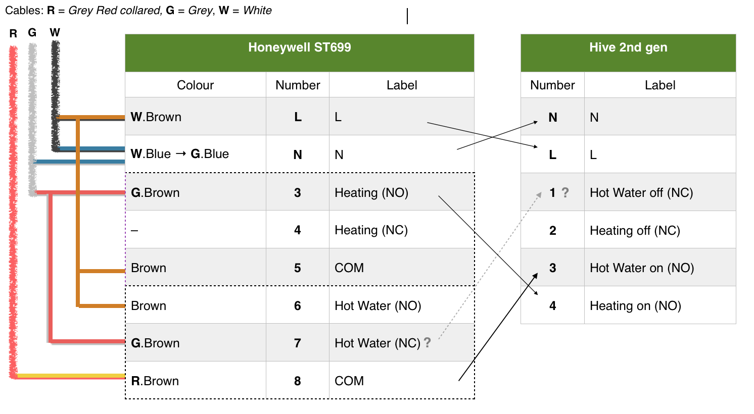

Both the HW and CH are currently working -- it is a gravity feed. The system does not have any thermostat. I am not sure which pump and valve are linked (hard to reach).
Looking at the ST699 manual, it would seem it was setup as follow:
I understand that the COM would no longer be required -- not sure about terminal 8/6.
Can these be rewired to fit the Hive?
If it is as the drawing there, it is possible to alter the wiring to fit the hive, then set the hive to gravity mode.
However, I'm concerned that the existing wiring is unsafe and not suitable for continued use...
It looks messy but it is safe. Cables will be replaced by a 5 core flex + new junction.
But as it stands, would rewiring as follow work:
L -> L (W.Brown)

8 -> 3 (R.Brown) HW on
Sorry I was mixing this with another thread :oops: There are so many poorly wired heating systems on here it is hard to keep up...
That is correct except for the connection to HW off, that terminal should be left empty. When you set it up you need to set the hive to gravity mode or the boiler wont come on when heating is selected.
Also make sure there is no inner insulation visible like there is now, and that the bare earth wires are sleeved with earth sleeving and all the earth wires are properly connected together.
Thank you Echo! Still 5 core so that should be good hopefully. Wil try today.
The ST699 two modes were set as CH+HW (i.e. CH is also HW) and HW-only. With the Hive and the wiring above, will CH also heat the HW?
I am new to gravity system generally -- very impressed by how efficient and strong it feels. Does it make sense to replace such system by an unvented?
Yes that's right (Make no connection to HW off though), with the setup you currently have it will not be possible to have heating without hot water. You mention a valve, where is this connected? If it is plumbed as a C plan with a 28mm 2 port valve in the pipework to the cylinder, it will be possible to have separate heating and hw control. If there is nothing to stop the boiler circulating hot water to the cylinder when it is up to temperature it will not be very efficient, new systems are required to be fully pumped to meet Part L of the building regulations.

Maybe 3 needs to be on 1 (hot water off) and hard link 3 to 4 instead? That how the ST699 seems to have been wired.
No, the old programmer had lots of extra connections because it did not have a gravity mode option. All the extra connections allow the boiler to switch on when hot water is selected, without starting the heating pump. and for the heating pump and boiler run together when heating & hot water is selected.
