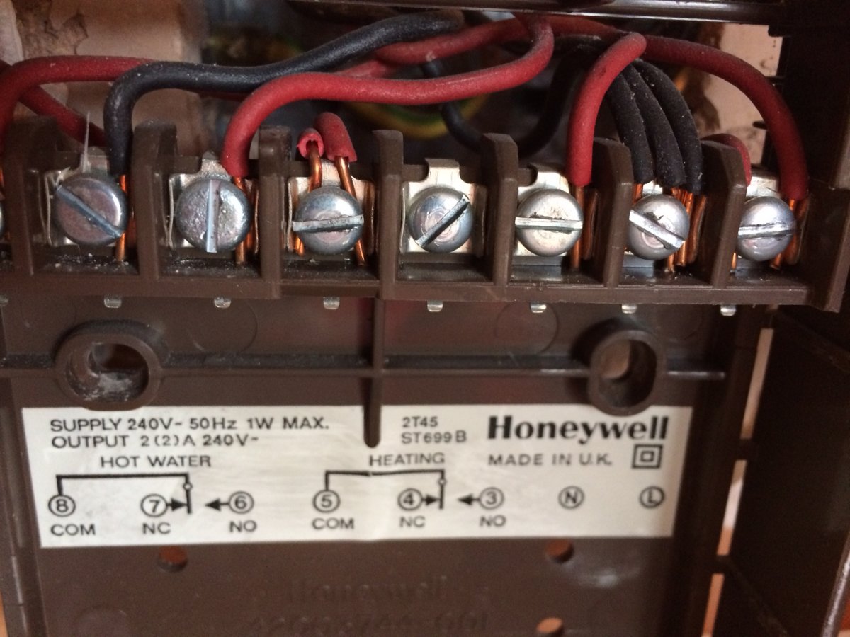

So I have a Hive 2 HW and CH system. It is to replace a Honeywell T45 (they seem to go under all sorts of names ST699 seems very common(?!)) programmer located next to the boiler, a thermostat located in the hallway, and an ageing 20 year old ideal classic boiler located in the utility room with the programmer. This programmer controls both the HW and CH.
Removing the facia, this I what I have
Now browsing the Programmers manual it looks like I have a W-Plan setup? (page3&4)

Now rather that bore you with my theories and make you think what the hell is this guy on about, ill cut to the chase, below is a numbered wire version of what I currently have (1,2,3,4,5,6,7), would one of you be so kind to simply state which of my numbered wires go to the corresponding terminals on the Hive programmer (N,L,1,2,3,4) along with any wires that need removing?
Thus far I am confident the two live link wires will go in the bin hence the lack of numbering.

(ST699) Wire Number – Hive2
(L) 7 --------------- L
(N) 4,5+6 --------- N
(3) 3 --------------- 4
(4)
(5)
(6) 2 ----------------3
(7)
(8) 1-----------------1 or cap it off?
Hive terminal 2 remains empty. What do I do with the stat?

Have you read the instruction manual for the Hive? The Hive manual is very well written and covers S plan heating and what to do with the stat.
I am an IT techie by trade
No offence, but from experience, reading that line sounded alarm bells in my head. The more I read you post, the louder the alarm bells were ringing.
How did you come to that conclusion when the wiring you have is very different?
Tank area with pump and what look like 2 diverter valves(?)
How would valves with only 2 pipes divert?
Where on the w plan diagram does it show 2 valves?
is there anything I need to do with the existing TS located in the hallway?
It tells you in the instruction manual. You even provided a link to it!
I and I'm sure others, will be more than happy to provide assistance, and help you learn. Providing you look at and follow through the S plan wiring diagram, look at the Hive wiring diagram and read the installation manual in full, and look carefully at how your programmer is wired.
If you do all of these things there is no reason why you won't be able to come back to us with your wiring numbers list and what you intend to do with the old stat and its wiring, so we can confirm that you are correct. Do not keep guessing the wiring. Your wiring guesses up to this point are still wrong. Incorrect wiring can easily damage the Hive.

I have a Honeywell ST699 programmer with Y Plan system. I would like to clarify the wiring arrangements for each terminal on the Hive receiver. Advice would be appreciated please. On my arrangement the Live feed to the programmer is linked to Commons on Heating and HW.
The terminals are marked the same on both the Hive and ST. Simply connect the old heating NO to the Hive heating NO and the same with the hot water NC and NO. There are no COM terminals on the Hive as those connections are already made inside the Hive. N to N and L to L.
If you have an existing room thermostat, you will then need to find where it is wired back to, usually a junction box where the 3 port valve is. The old thermostat cable needs to be disconnected and a wire link fitted between where the live to the stat was and where the switched live from the stat was. To help you find the right cable, it will be the only one connected to the white wire on the 3 port valve.
Thank you - very helpful. Just to be clear, there is a red wire which leads to the Hot Water COM terminal (see photo - which must be permanently live as there is also a link to that terminal from the Heating COM terminal which is in turn is linked to the Live terminal). What do I do with this wire please?

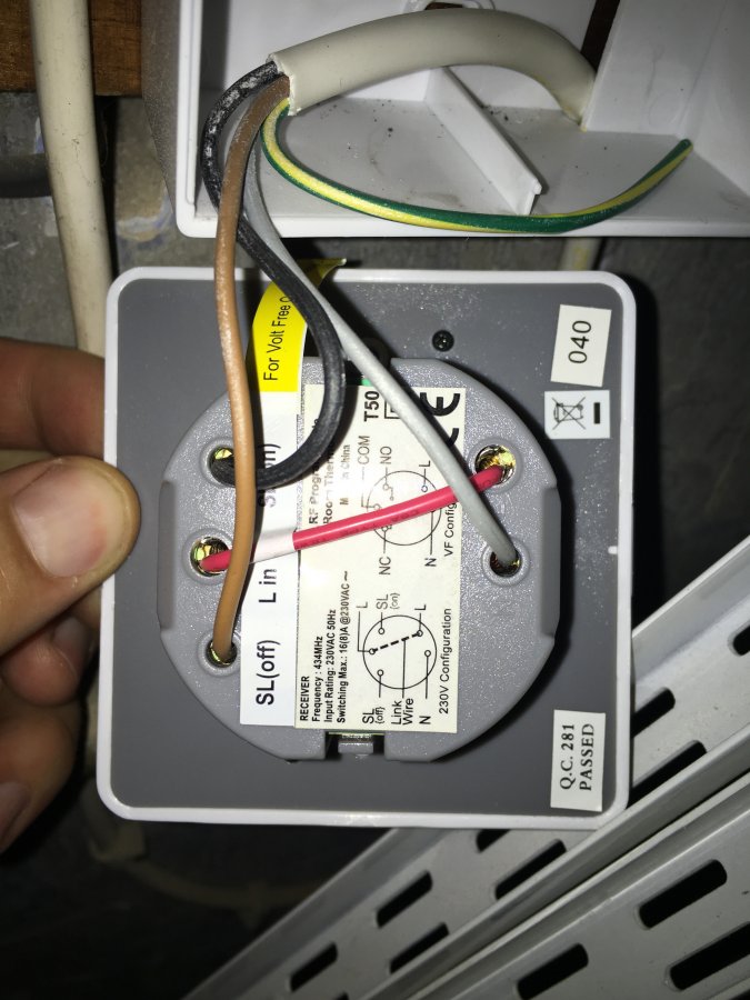

Hi Echo,
I have just found your posts while preparing to install a new hive. I have a baxi 30HE Combi, HRFS1 wireless stat (also known as a t50 I think).
The HRFS1 has: SLon SLoff Netural and Earth (earth left coiled up)
From the above I connect the SLon and SLoff to the same on the Hive terminals (3 and 2).
Neutral to Neutral
Then link out Live and Com to match HRFS1?
Is this correct or am I missing something :?:
