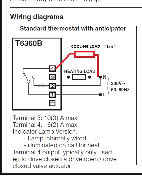

I have just put in a extraction fan in a window to drag out hot air, I have a T6360 for control so switching on fan when it’s roughly 22c, is this the correct stat and what wiring
Would I need to do ?
