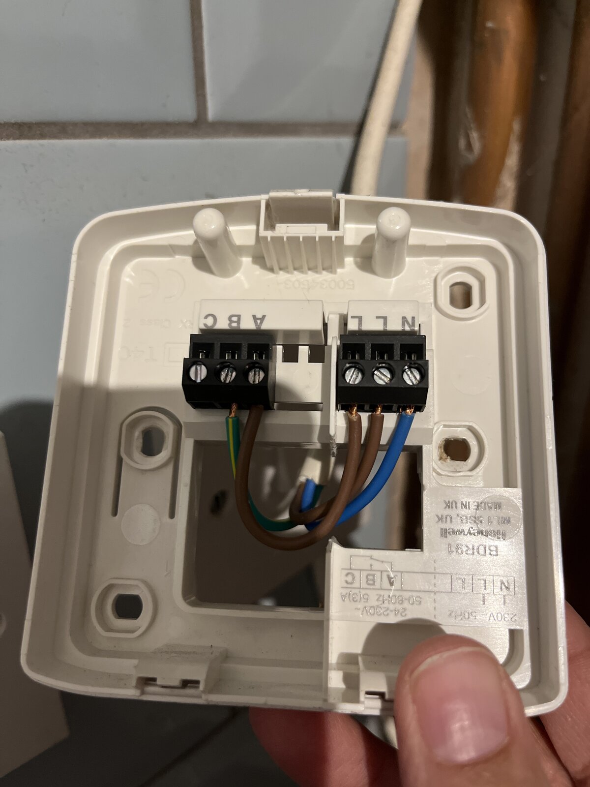

I’ve just bought the Hive Mini and I’m trying to switch the receivers
My current one is a Honeywell wired up as seen here….

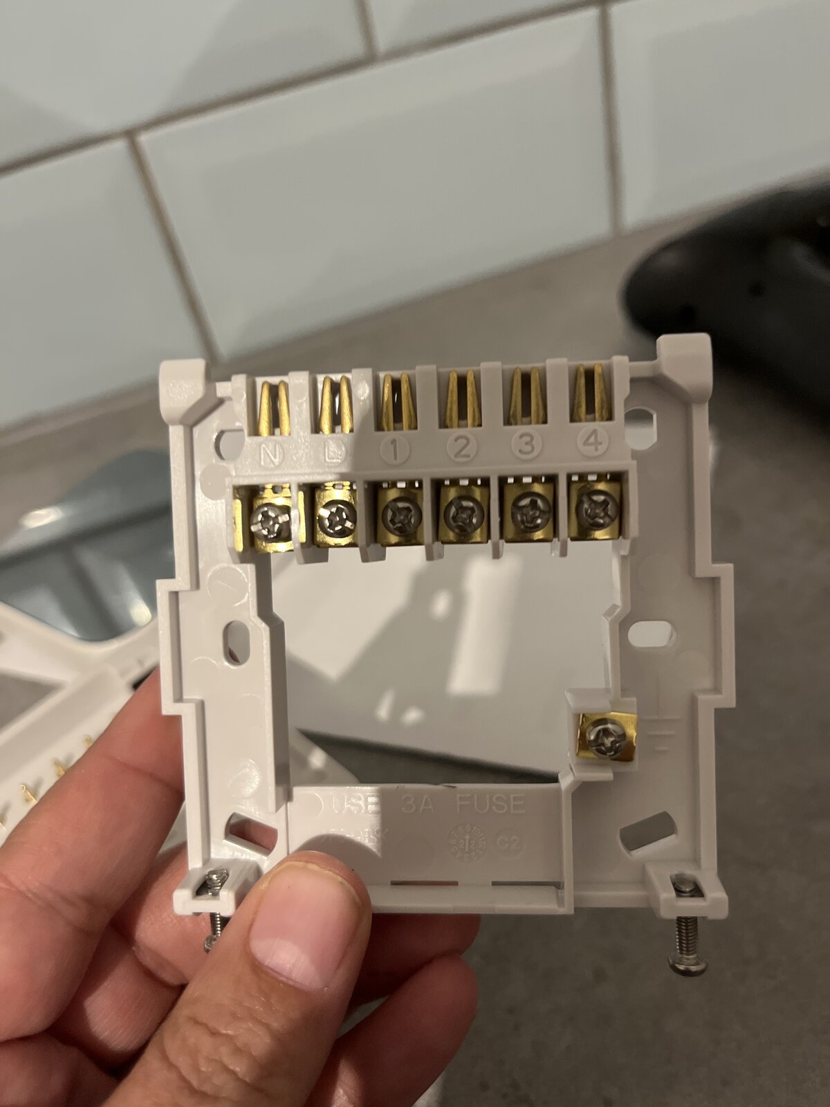

Can some please tell me where exactly each wire goes in the hive receiver as that is marked N L 1234 not NLL ABC
Thank you
Someone’s been naughty and used a cpc/Earth wire for a live wire. L to L, N to N, take the link from L to A and put it from L to 1 and use the green/yellow (cpc/earth) in terminal 3.
