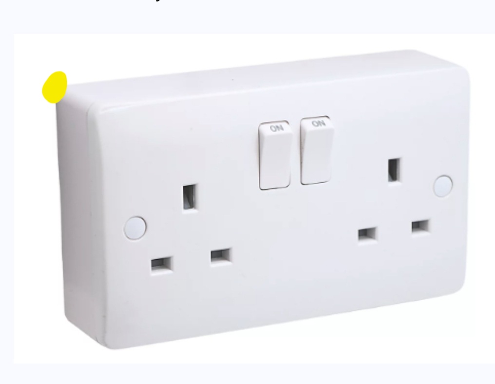

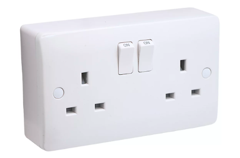

I must admit that I`ve always reckoned the zone was actually the socket faceplate and no more, that would also be reliant on using the smallest possible which would actually be the standard size.
As you say, I suppose it'd 'debatable'. However, from the (non-electrician) person with a drill or hammer/nails in their hand is probably likely to go by "what they can see" and if that is actually a 'finger plate' (which they might well not even realise is not part of the faceplate), that's probably what they will regard as defining the 'zone' (if they've heard of such thingsI must admit that I`ve always reckoned the zone was actually the socket faceplate and no more, that would also be reliant on using the smallest possible which would actually be the standard size. If someone was using larger sockets I would not include that in my way of thinking even if installed from new on a rewire but I do see how that might be argued.
True, provided one didn't mind an extremely tight 90° bend in the cable.The sockets/accessories, are always little larger than the box behind it, so in your troublesome example - you would still have some space around the perimeter of the box, in which to 'sneak' a cable around, and safely back to the middle of the safe zone.

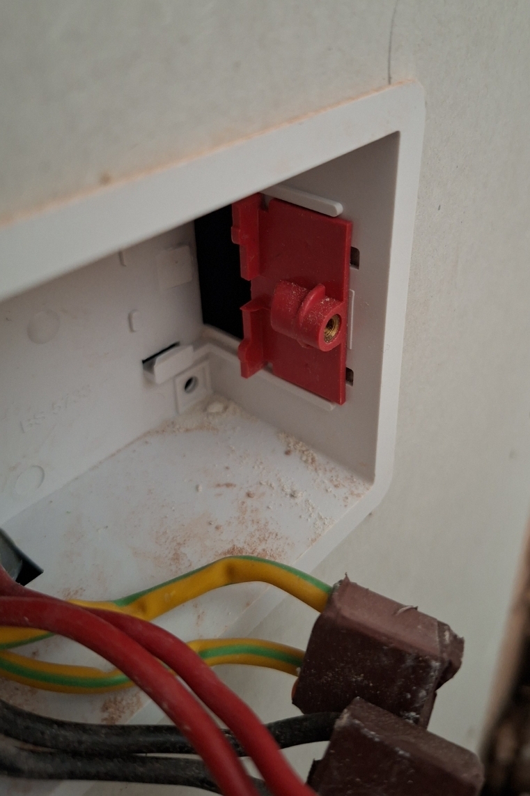

The brick wall which, as I've explained, rendered it totally daft that I had contemplated using a plasterboard box in the first place, would (without a lot of brick-destroying effort) preclude using 'a deeper box'.Use a deeper box you can go side entry....
Yes I agree, that is my position, the standard socket, the smallest permissible one that could fit sets the zone boundary therefore whichever BS rated socket fits the box and is ever likely to be used sets the zone dimensions.The sockets/accessories, are always little larger than the box behind it, so in your troublesome example - you would still have some space around the perimeter of the box, in which to 'sneak' a cable around, and safely back to the middle of the safe zone.
I'm not totally sure about that. I'm going to ask this question in two stages ....Yes I agree, that is my position, the standard socket, the smallest permissible one that could fit sets the zone boundary therefore whichever BS rated socket fits the box and is ever likely to be used sets the zone dimensions.
Oversize sockets would not normally dictate the zone unless one could be absolutely sure that in all events that oversize socket size will be maintained. That would be impossible to ensure with any certainty.

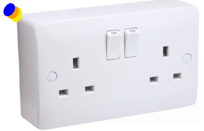

I totally agree, but only because of the application of common sense to what would otherwise be a 'strict rule'.. The problem then becomes the question of 'where does one stop?' - if we agree about your yellow mark, what about my orange one, or my blue one, or ..... ?If you were to drill where I marked yellow you would need locking up...
