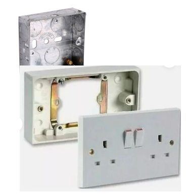

Horizontal safe zone with 'dry lining' back boxes
I'm not totally sure about that. I'm going to ask this question in two stages ....

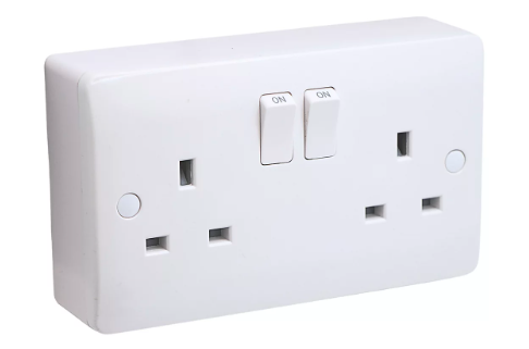

... firstly, if you were a man with a drill in your hand and saw this on a wall, would you (like, I imagine,most people) believe that this accessory created vertical and horizonal 'zones' (where you should not drill!) equal in breadth and height to the breadth and height of the accessory?
Yes I would take the dimensions of such as dictating the zones John.

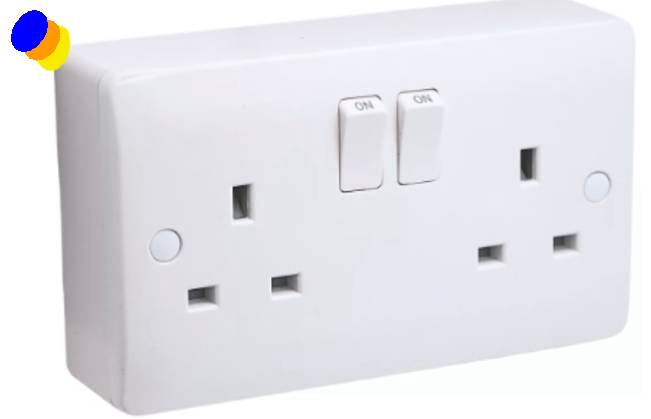

I totally agree, but only because of the application of common sense to what would otherwise be a 'strict rule'.. The problem then becomes the question of 'where does one stop?' - if we agree about your yellow mark, what about my orange one, or my blue one, or ..... ?
'Knowing where to stop' is always an issue with potentially 'creeping' applications of common sense. Take speed limits. We might agree that driving at 71 mph in a 70 mph zone is not something to worry about. So if 71 is OK, then what about 72? - and if 72 is OK, what about 73 etc. etc :).
However, this wasn't my point. I'm waiting for ebee to answer my "Question 1" before I move to Q2 ;)
Yellow 20 years
Orange 15 years
Blue 10 years
I imagine you would, since I would think that virtually all of us would say the same.

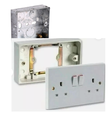

However, what if I did a bit of dismantling, and revealed that the below was what was going on? We would hopefully still be agreed that, as with the first picture, the visible accessory would still be defining the zones, but ("Question 2" !) this does bring into some question your view that 'the box' define the zones, doesn't it?
Yellow 20 years .... Orange 15 years .... Blue 10 years
What are they - the periods you think one has to wait until someone penetrates the cable with something, or what? If that's what they were meant to represent, I'd be tempted to multiply them all by 5, if not 10 or more ;)
Sorry if I have not defined my opinion clearly John.
No - the faceplate self actually defines the zone itself as the faceplate makes the object the socket/switch or whatever it is.
That is the determination and as long as we work to the minimum dimension of any number of proprietary faceplates to a recognised standard then all well and good.
If I, or anyone else scribe and plan using the backbox and use the difference as a demarcation zone then all well and good we still use the faceplate dimensions as the determination for zone.
I think that is all we can do and is reasonable.
I do realise that some people use say a top or bottom hole in a metal backbox with or without grommet and that could take the route out of zone or simply too close to the zone limit in practice anyway. It would also usually be too sharp a bend to my liking.
If someone used the full faceplate zone right down to the last tenth of a thou I could not really fault it could I? although I would not like it at all.

Fair enough, but that doesn't help me to understand what your "10, 15 and 20 years" were meant to mean :-)

That obviously depends upon 'how far one has taken it' - i.e. whether you're talking about pete's yellow blob, my orange or blue ones, or one even further way than my blue one. I personally would be very hesitant to penetrate a wall (unless I had positive reasons for knowing it was 'safe') within a coupleof inches (maybe more) of where 'the zone should end', but that doesn't mean that I think the zones should be defines as extending 2 inches beyond the borders of the accessory.
Well, would the yellow, orange, and blue blobs on the wall be an obvious sign not to drill there?
Sorry if I have not defined my opinion clearly John. ... No - the faceplate self actually defines the zone itself as the faceplate makes the object the socket/switch or whatever it is.
Yes, but you were also seeming concerned that if an 'oversized faceplate' (or maybe a standard size one with a surrounding 'finger plate') were allowed to define a zone, then there would be a risk that it would subsequently would be replaced by a standard-size accessory, leaving cables outside of the zone. That's what I have just illustrated - take away the 'converter pattress' and replace with a single socket attached to the single box, and cables which you accept were previously 'within a zone' no longer would be.
Perhaps you could further clarify your opinion, particularly in the case I have just discussed?
