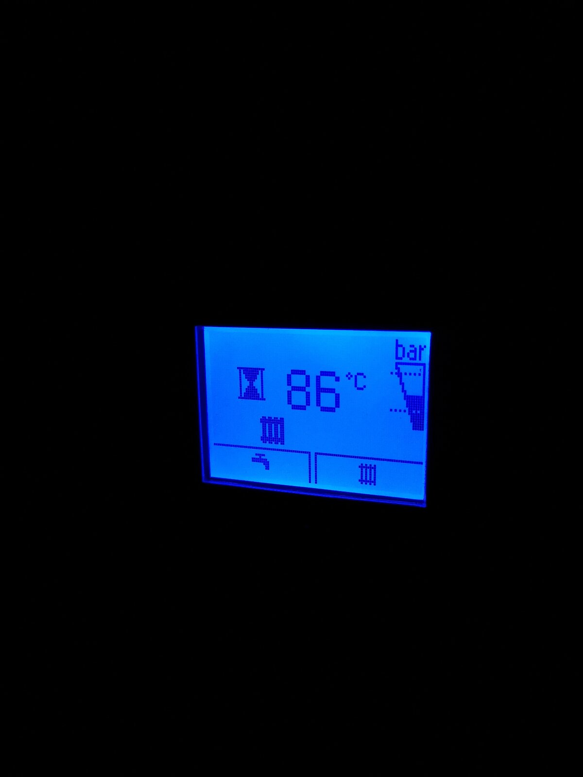

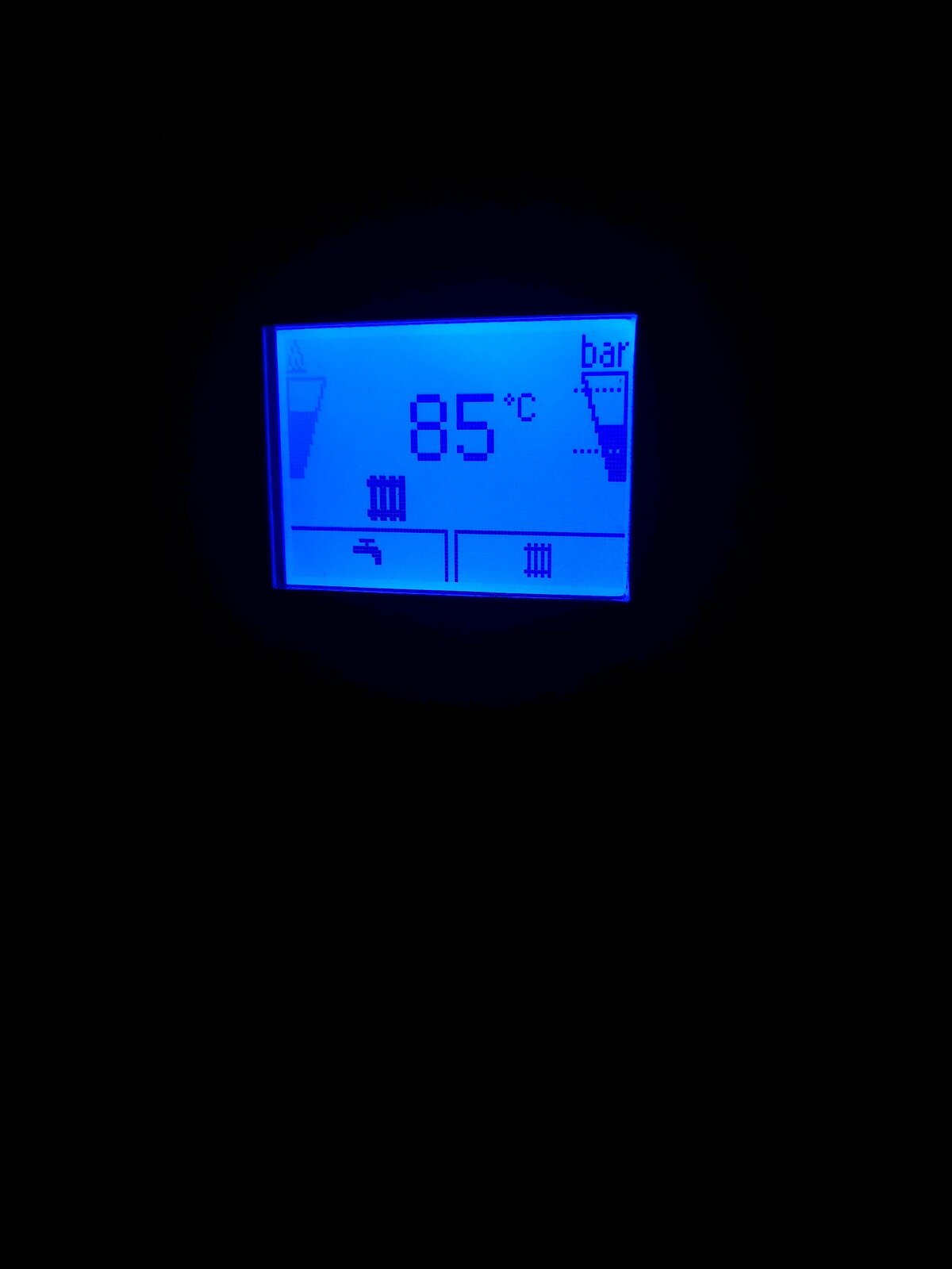

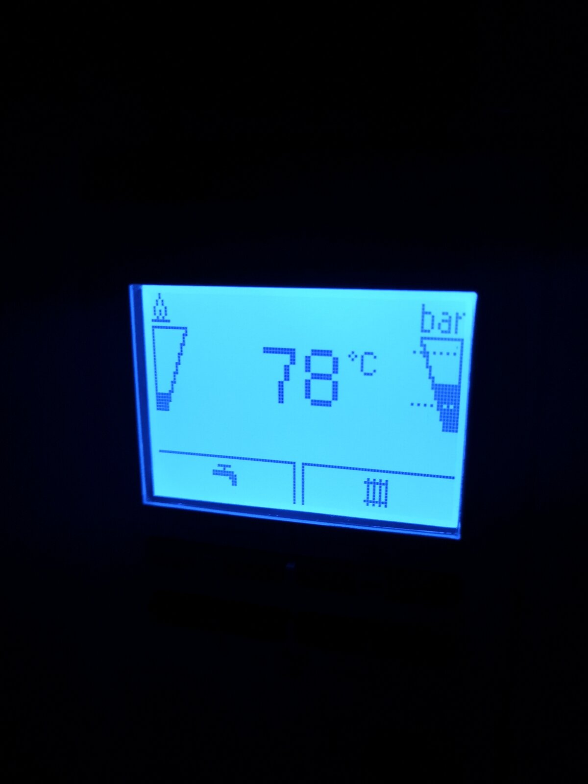

post pics of your controls and boiler panel when it wont fire

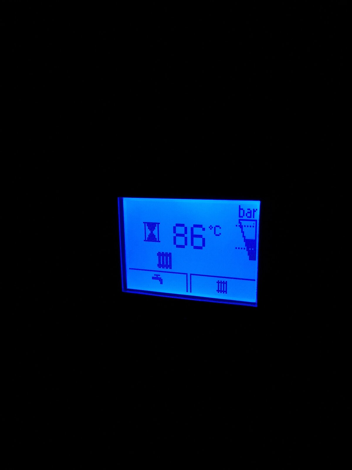

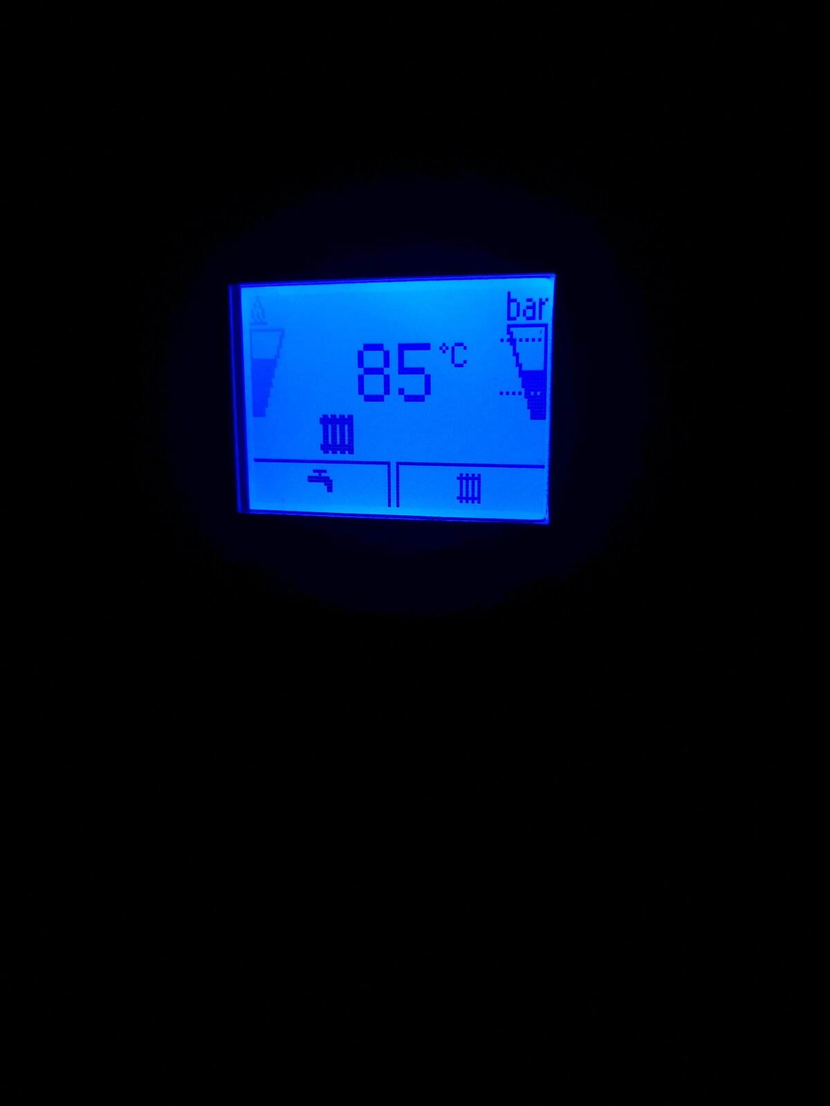

So initially I get the display with the bar on the left with flame at the top on left side of the display. Nearly full, then it shows nearly empty. Simultaneously the radiator symbol will flash. The bar on the left disappears. A flashing egg timer symbol then appears and when that goes off, there is just a static radiator symbol left. At that point it will show the s.07 code when I go into that menu.
Bit tricky to take photos as boiler is in the loft and no lights up there!

Do you have an onboard timeswitch too? Check the flow and return valves under the boiler too.

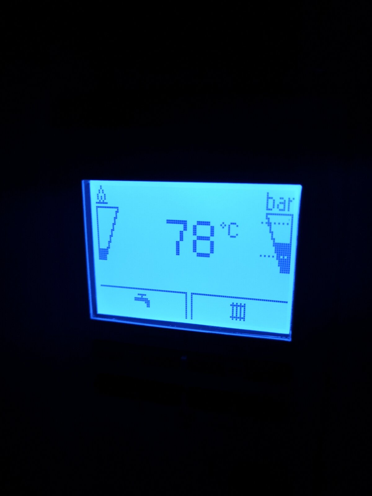

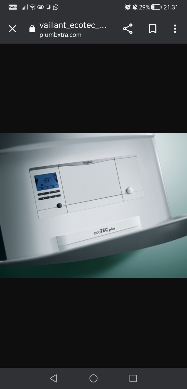

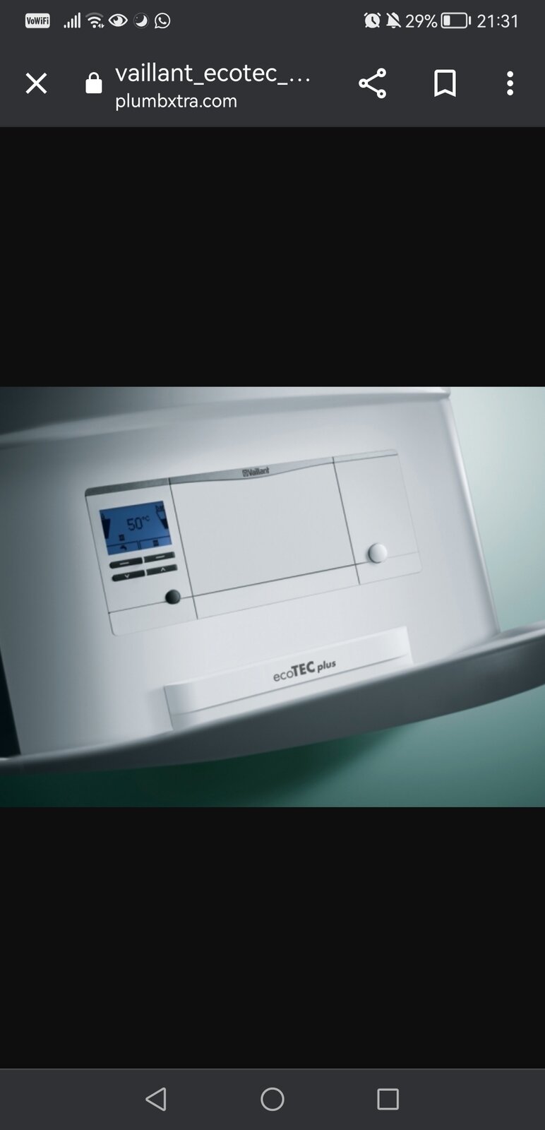

No timeswitch. Display looks more or less like attached photo.

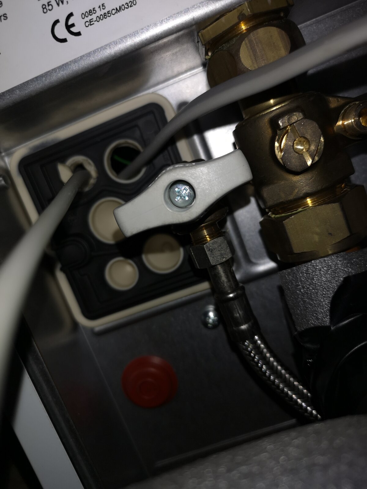

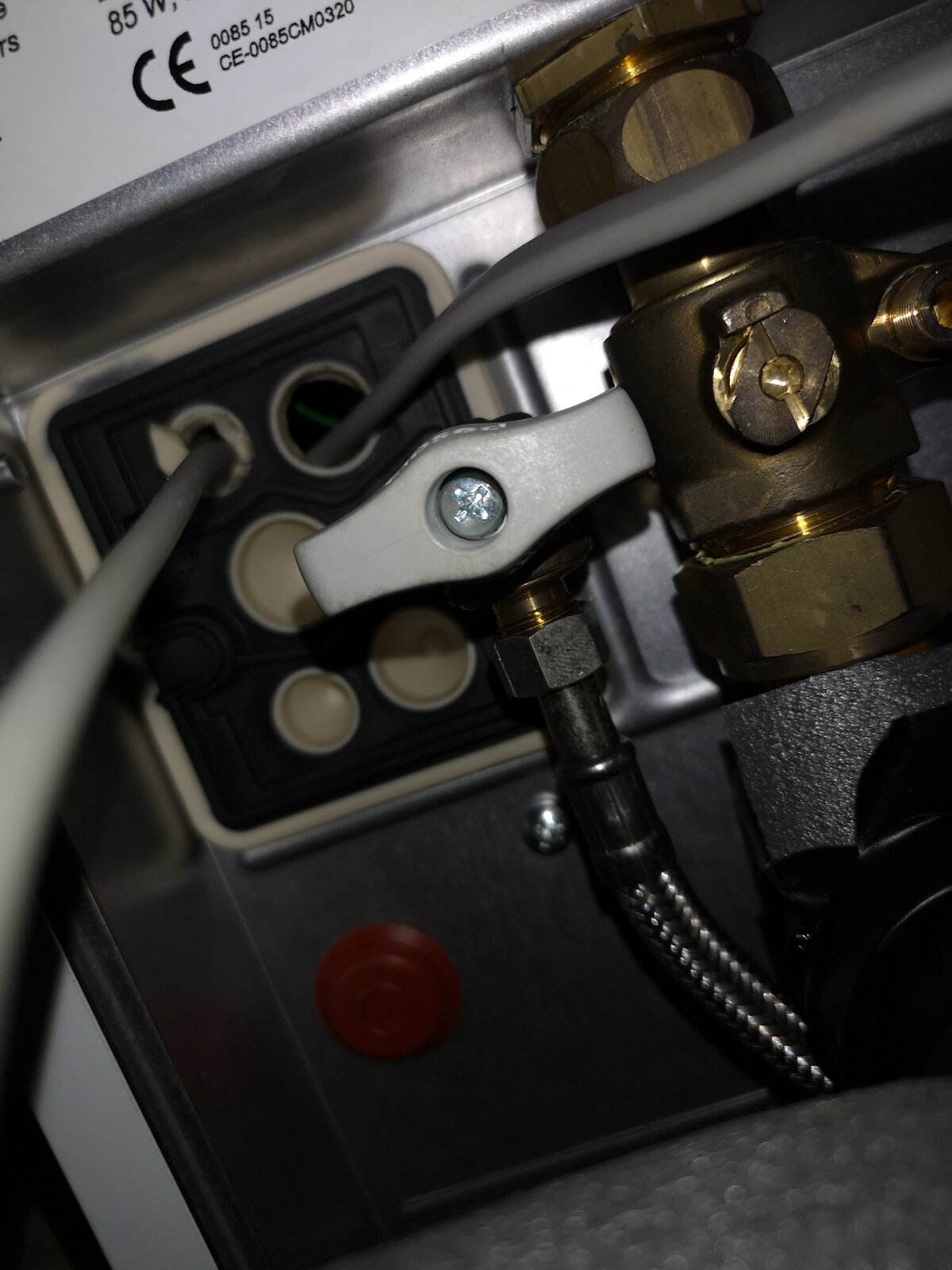

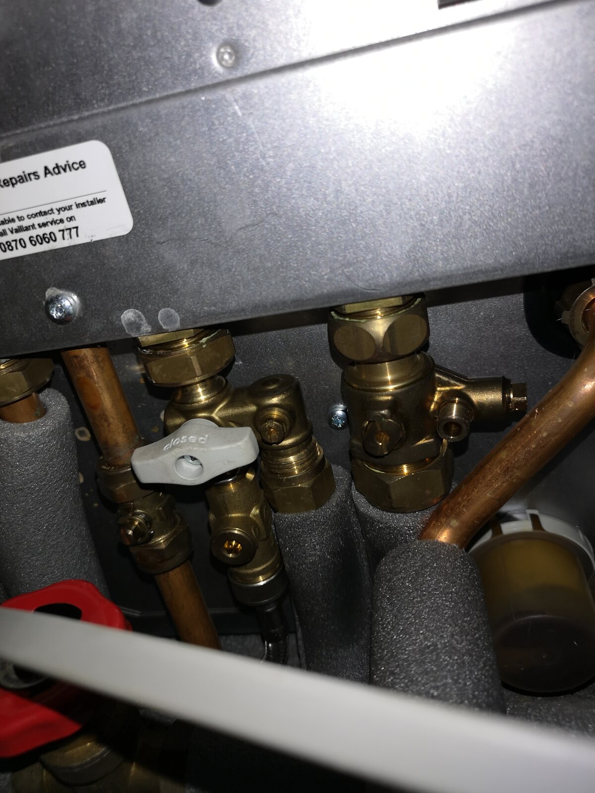

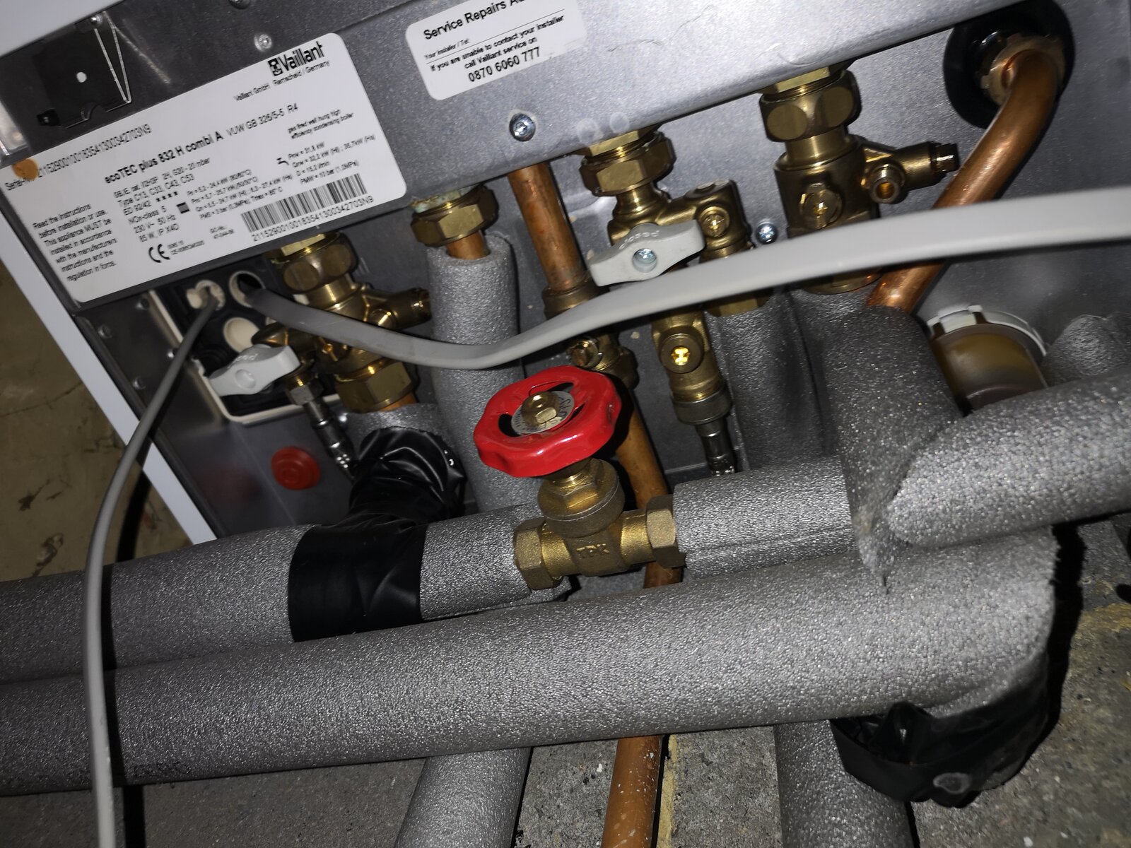

Did you check the flow and return valve under the boiler like I suggested?
What should I be looking out for/how would I know if there's a problem there?

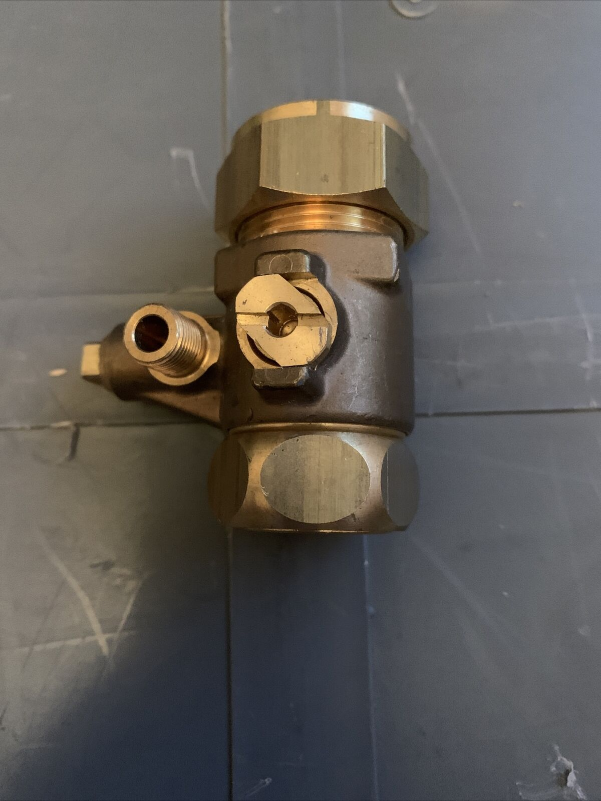

Look for one of these on each of the two 22mm copper pipes at the far left and right sides, under the boiler.
Picture shows valve in closed position. If they look like this they need to opened with a hex (allen) (?4mm) key or gurt screwdriver, turned 90 degrees so that the large slot is in line with the valve.
Yes 4mm or even 4.5mm

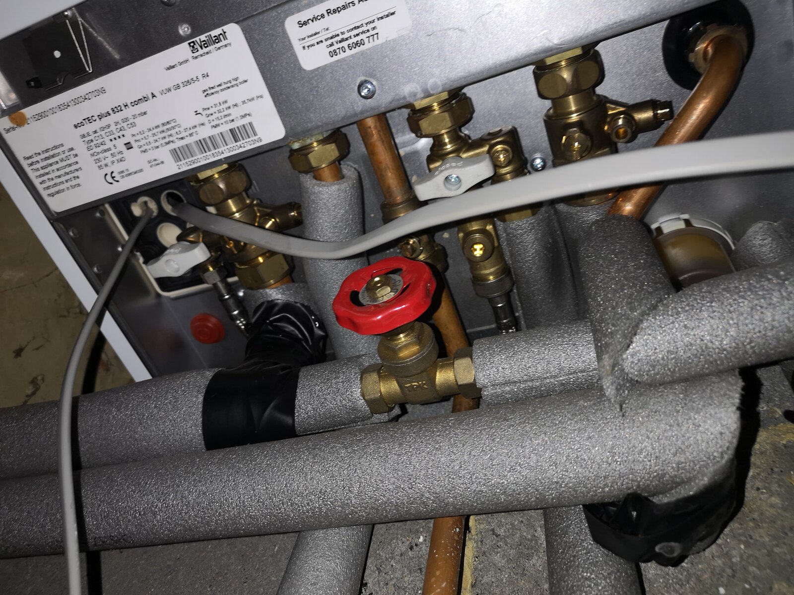

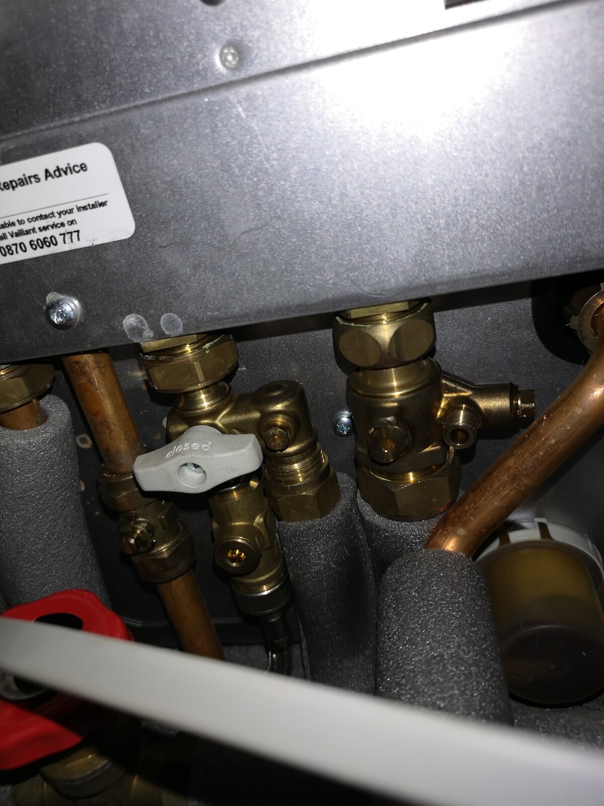

Thanks for clarifying. It looks like both are already in line, have attached photos.
Anything else I could check before British Gas (hopefully) turn up tomorrow? Thanks
