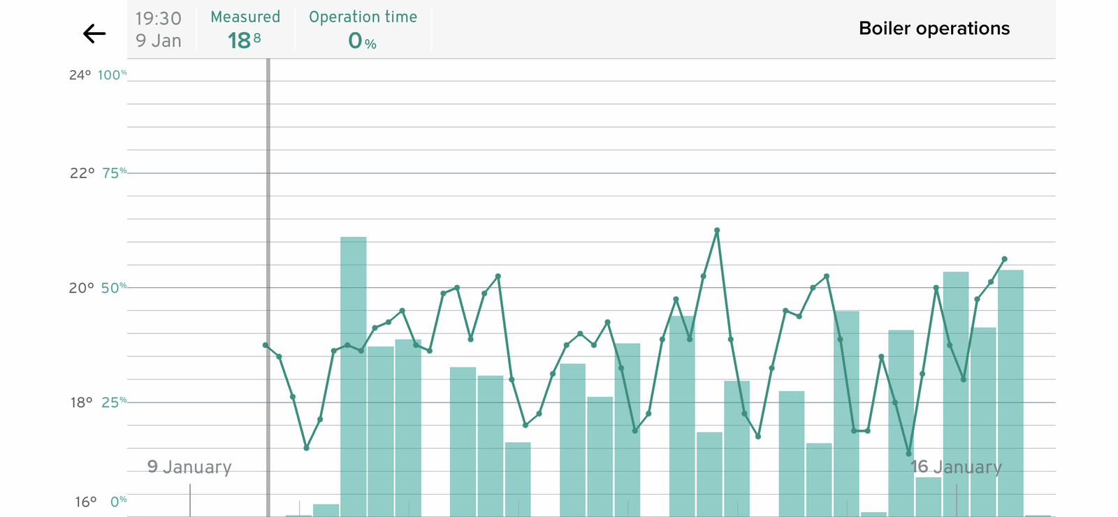

Hi all, I have an ecotec plus 832 and less than 2 weeks ago I installed a Vsmart thermostat by myself. The graph under information in the app doesn't look quite right to me and it looks like the boiler turn on/off instead of doing modulation. Am I missing something? Thank you.

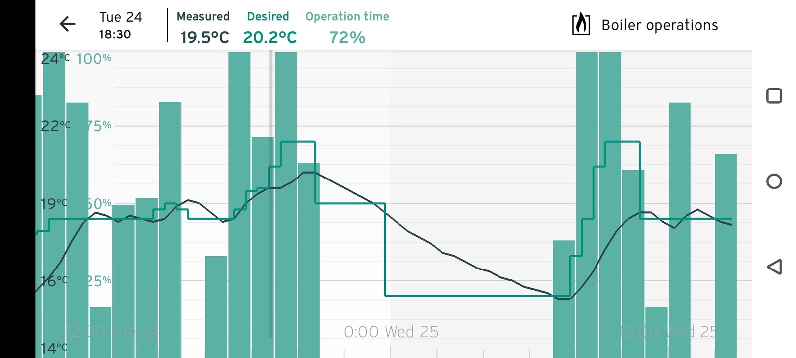

The graphs in the vSMART app are pretty useless, it just gives you the % of time during that time slot that the boiler was fired and providing heat. Your graph does seem to be missing the 'desired temperature' line, but otherwise looks normal. You can pinch/stretch the graph to see more detail for each day (see my graph below - android app). The boiler will be modulating itself as required during those periods. I have requested to the app developers that they add outside temperature to the graphs, and actual kWh gas use of the boiler, but I doubt they will. I think vSMART is a bit of a forgotten lovechild between Vaillant and Netatmo.

Thank you for your reply. I want just to figure it out why if my VSmart is doing something dumb or it's really smart. I set a temperature of 20* and when it reaches it it looks like the boiler doesn't maintain. The temperature after a while drops to 19.8 or 19.7 and then the boiler fires up again until I can see a 20.2 or 20.3 in the app. I thought it's supposed to reach the set temperature and then modulate to maintain it pretty much constant.

As you can see from my graph, it doesn't really get to temp and hold, it shuttles a bit. It's a compromise, you could set the heat curve lower so that it never quite reaches the set point, and then the boiler will be running all the time, but then it will take a long time from cold to get up to near the set point. If you set the curve higher it will get up to set point quickly and then overshoot and shuttle on and off holding it within 0.2C or so of set point. As the boiler itself cannot modulate below say 6kW, you may find you're using more gas when it's running all the time compared to a more on/off curve. On mine in the 'heating parameters' settings, I currently have the heat curve set at 1.8 using 'hysteresis' algorithm with a threshold of 0.2C. I have tried the 'advanced' algorithm, and find it calls for much higher flow temps from the boiler and overshoots the set point by a bigger margin and uses more gas overall, but the house feels warmer.

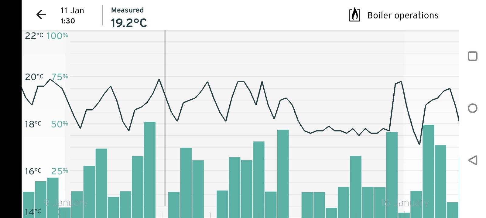

My graph for the same time period as yours. I see that the desired temp line disappears when you go to this scale, and you lose detail.
