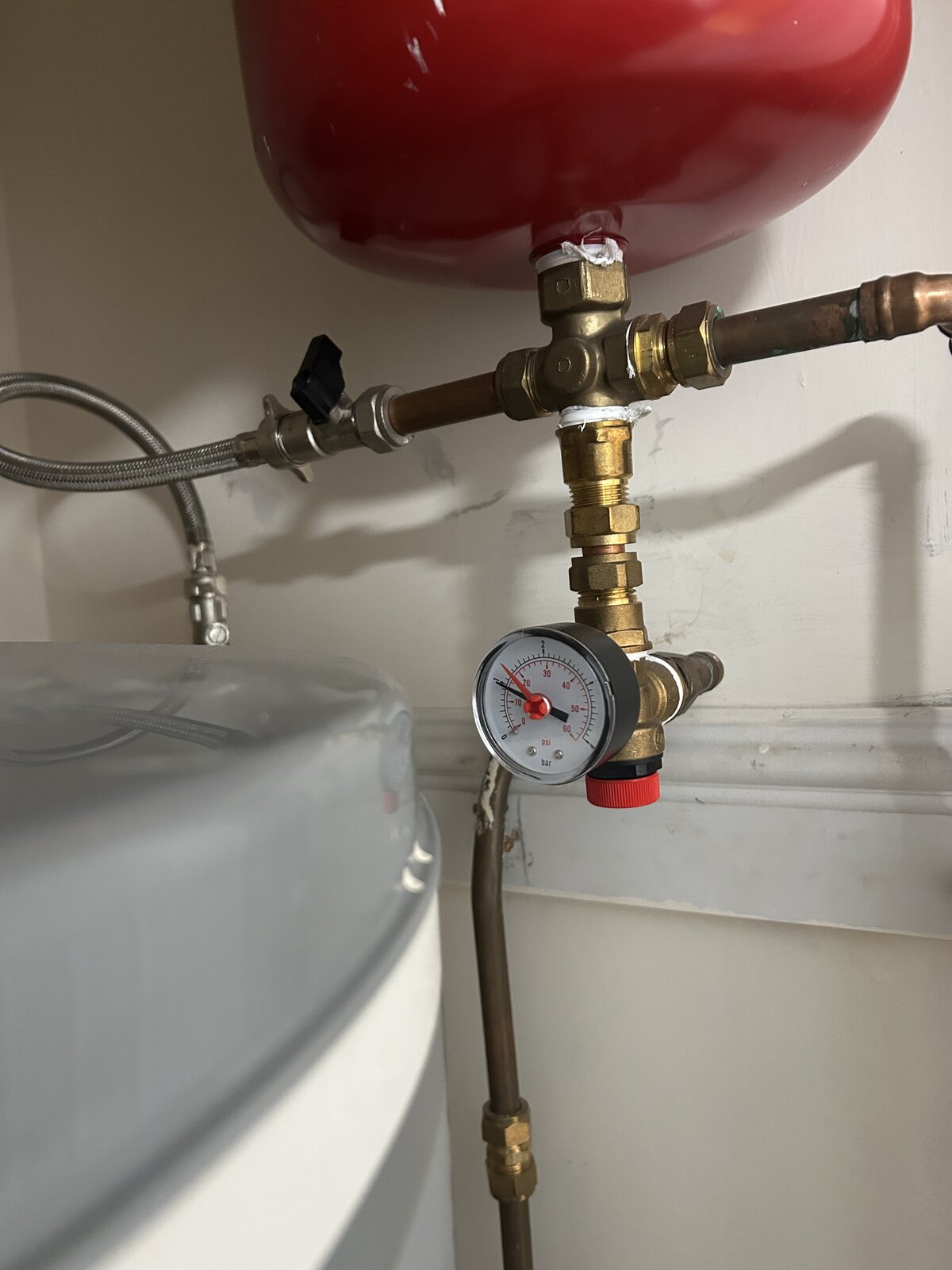

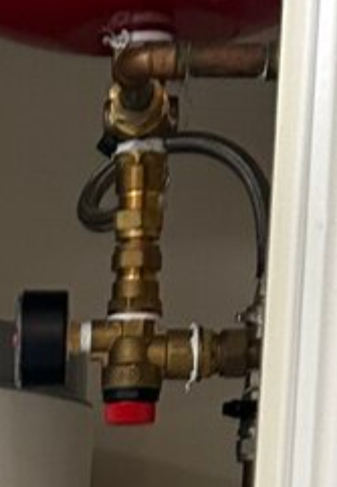

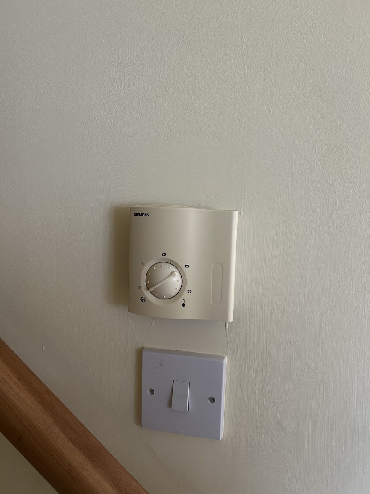

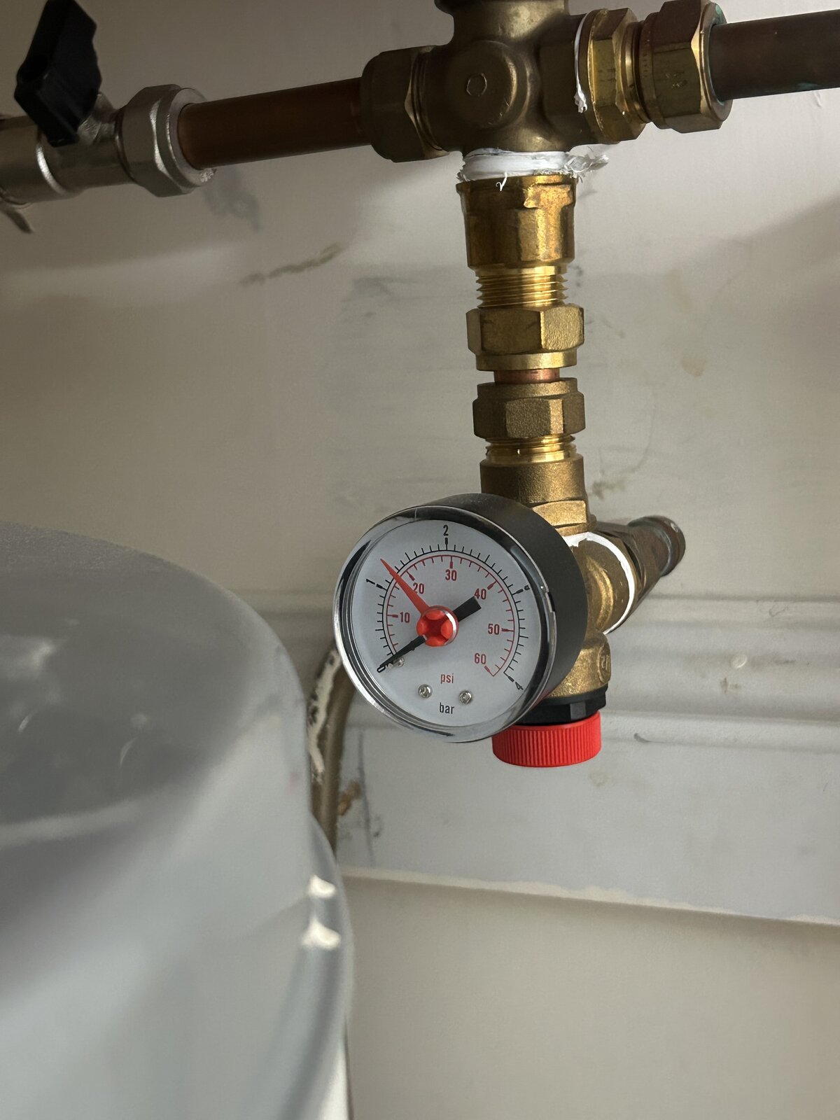

Moved into this property a couple months back and I had to bleed some of the radiators inside it. About 4 of them were cold at the top and warm at the bottom. After bleeding them they were roasting hot all around so the problem was solved. However the issue now is I’m not getting any heating on any of them although the central heating option is switched on. The thermostat is on also and they won’t come on. I’m getting roasting hot water on the showers and every tap with good pressure however the central heating just won’t turn on.
Any ideas and advice would be much appreciated fellas.

After bleeding the radiators, did you top the pressure back up? If yes, could be motorised valve failure.
Ok,fine. Does boiler now fire up for heating ?
Mate your a legend that’s the heating on now all the radiators are now warming up!!!
Thanks man. I was going to ask is 1 psi safe can I go higher and do I need to do this everytime I bleed the radiators?
1 bar is fine,pressure will increase when heating is in use ,shouldn't reach much more than 2 bar,and when cools should return back to 1bar. If pressure gets to 3 bar you have a problem.
Anytime rads are bled of air ,then re check pressure.
