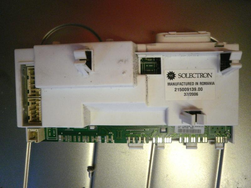

Here is the board still in its protective plastic casing, carefully press in the snap connector tabs along the sides and top edge to open the case.
The prize away two more snap connector tabs holding the circuit board to the case.

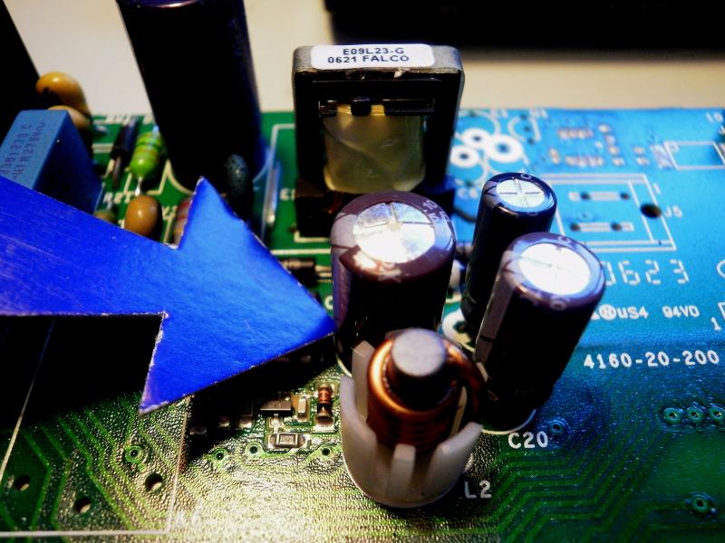

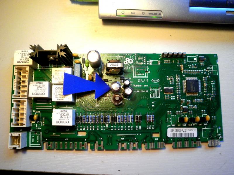

Here is the offending capacitor arrowed in the middle of the board at location C17.
Close up of the capacitor

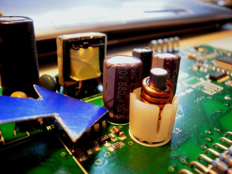

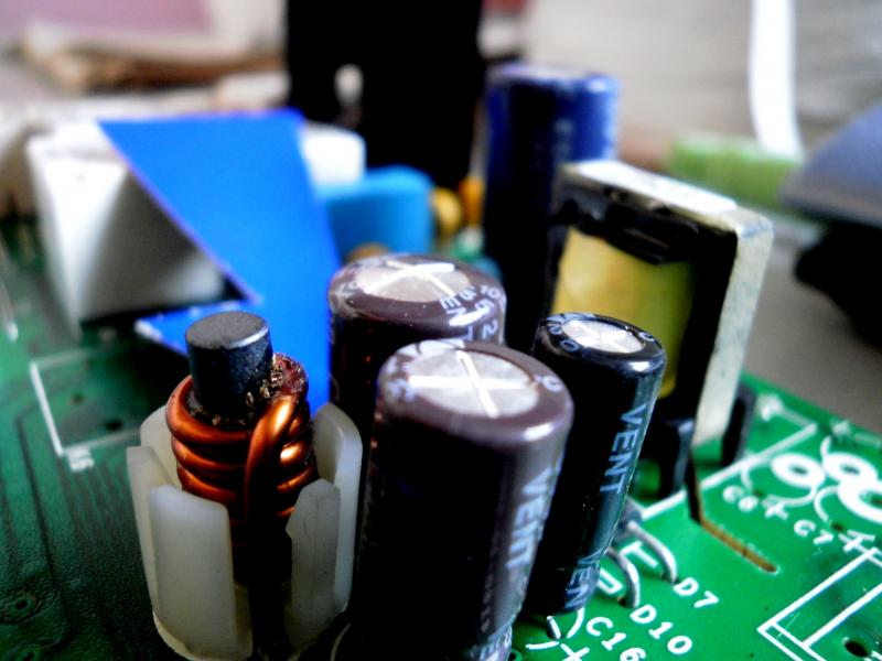

Here you can see as compared to the other capacitors in the group the slight doming of the failed 680mF capacitor.
Note the negative markings in relation to the board.
Again from the opposite side of the capacitor group showing the doming of the failed capacitor more clearly.
