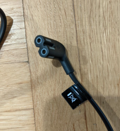

1) a really long power cable for the TV - it looks like this and I think it will be easy to find say a 3m long version:

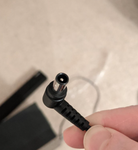

2) a really long power cable for the soundbar - it looks like this, any idea what it is?

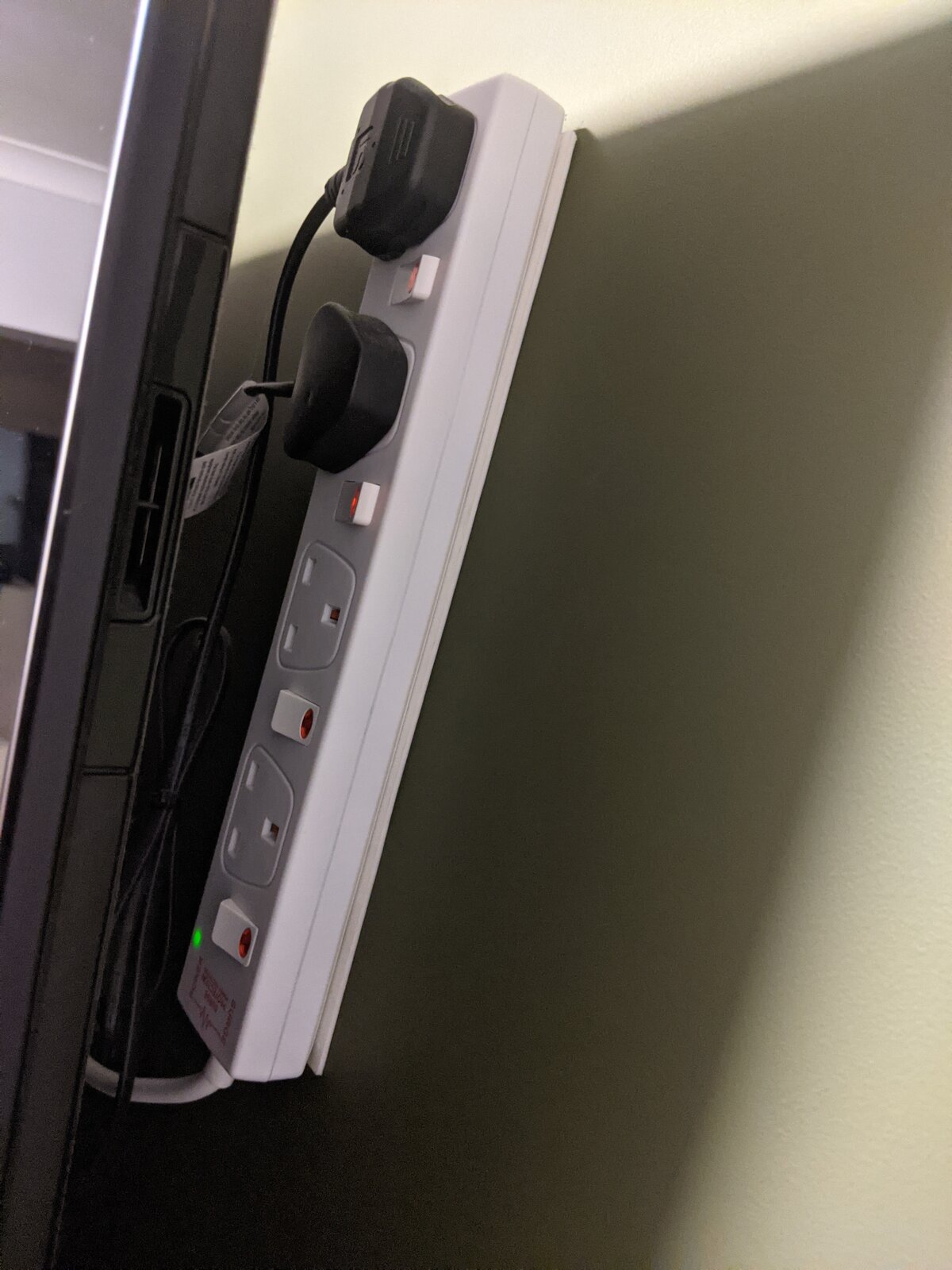

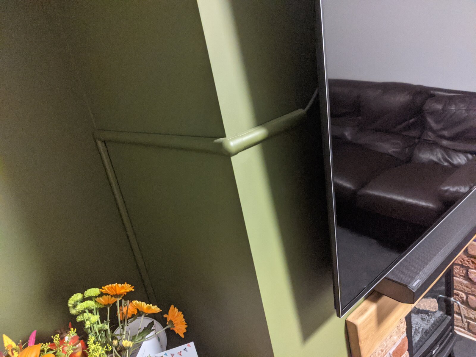

Use D line trunking from the purple unit to behind the TV painted the same colour as the wall.
In the trunking I'd recommend a long 2-4 way extension and 2 HDMI cables incase you ever use more devices in the future.
Connect the TV and soundbar to the extension behind the TV. You'll also need to connect another HDMI lead from the soundbar HDMI out to the ARC HDMI 2 on your TV this will enable sound from any other HDMI device to play through the soundbar. For this run a little trunking between the TV and the soundbar to hide the power lead and HDMI.
You'll now have 2 HDMI leads at the purple unit ready for your TIVO and any other device. These along with the sub will be powered using the other socket you have free behind the purple unit.

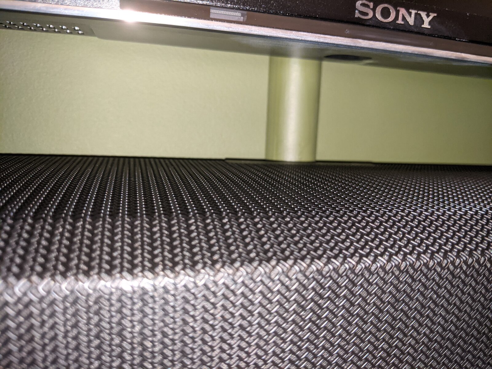

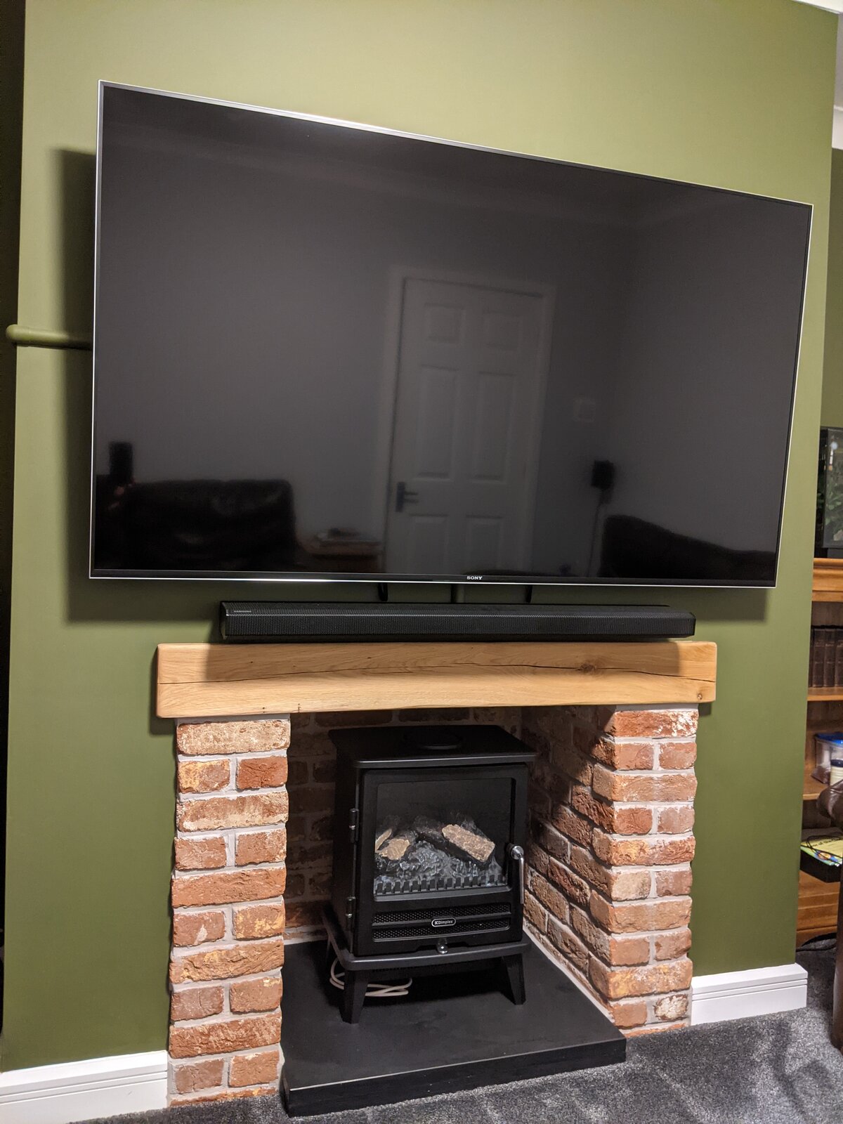

I did something very similar I'll post couple pics.

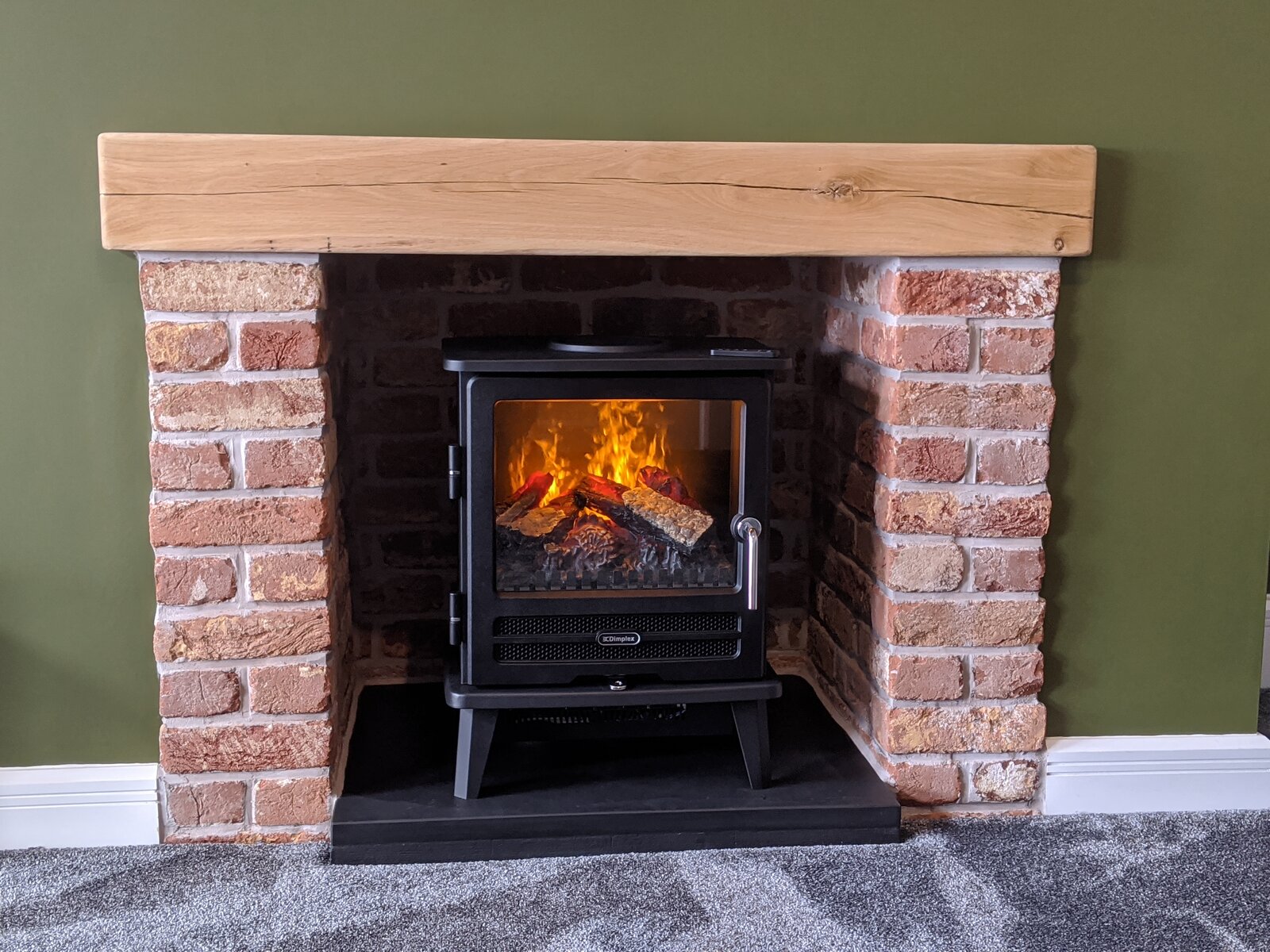

I don't know what other choices you have but that TV is too high, you will get a crick in the neck. The other problem is heat rising from the fire will not do the TV any good. If you don't use the fire consider getting rid of it and putting the TV lower. That would also make running cables from the unit easier. Don't forget an aerial feed as well, you didn't mention it.
Depending how for your sitting away from the TV it shouldn't be to high. I had those concerns in the pictures above but it's never been a problem even coming from a TV fixed a fair amount lower previously.
It's all personal preference but take a look at recommended TV heights to seating distances they're higher than you think.
I'd never put a real fire under the TV but an electric downward firing fire or stove similar to mine won't be an issue.

Thanks all.those pics are great- essentially show exactly what I had in mind. We will likely put shelving in the "bay" where the violet unit sits too which will further mask the trunking.

Yeah your never going to get away with a proper wood burning stove beneath a TV.

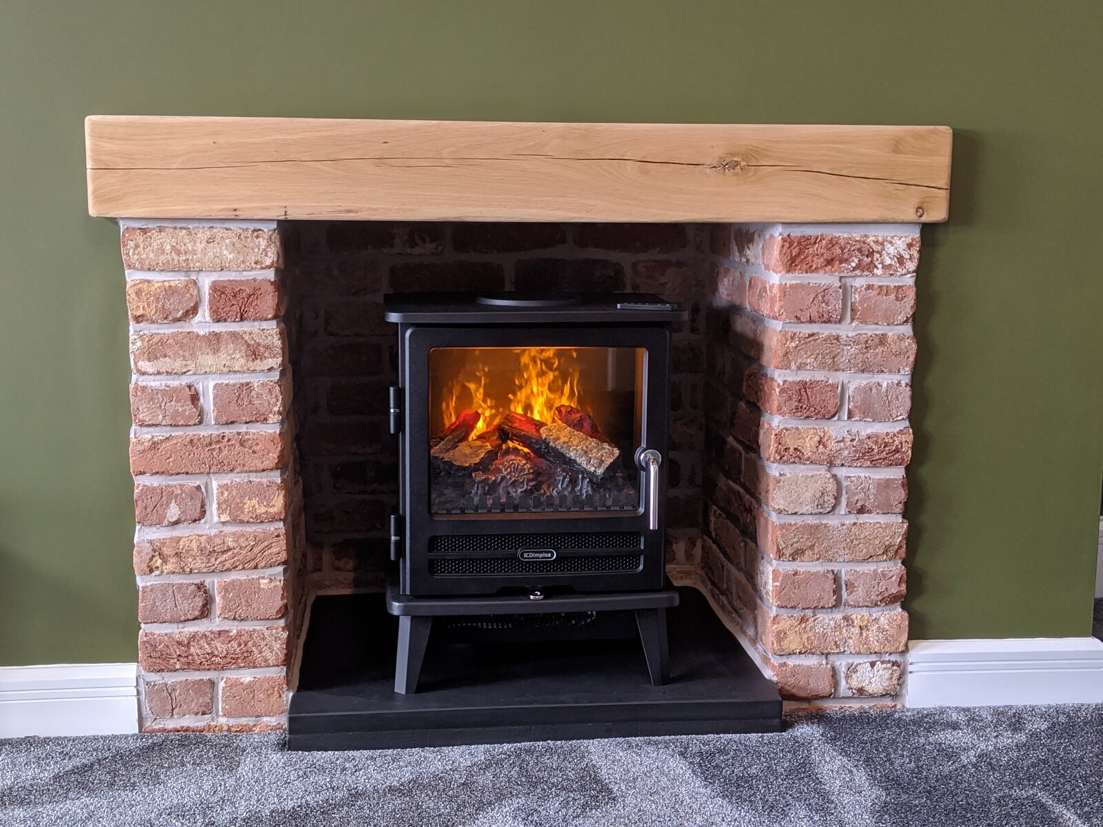

The one I fitted is electric but with a real flame effect called Dimplex Opti Myst. It's real good works on water vapour. The heat is pumped out via the bottom so has dispersed by the time it hits the soundbar/TV.

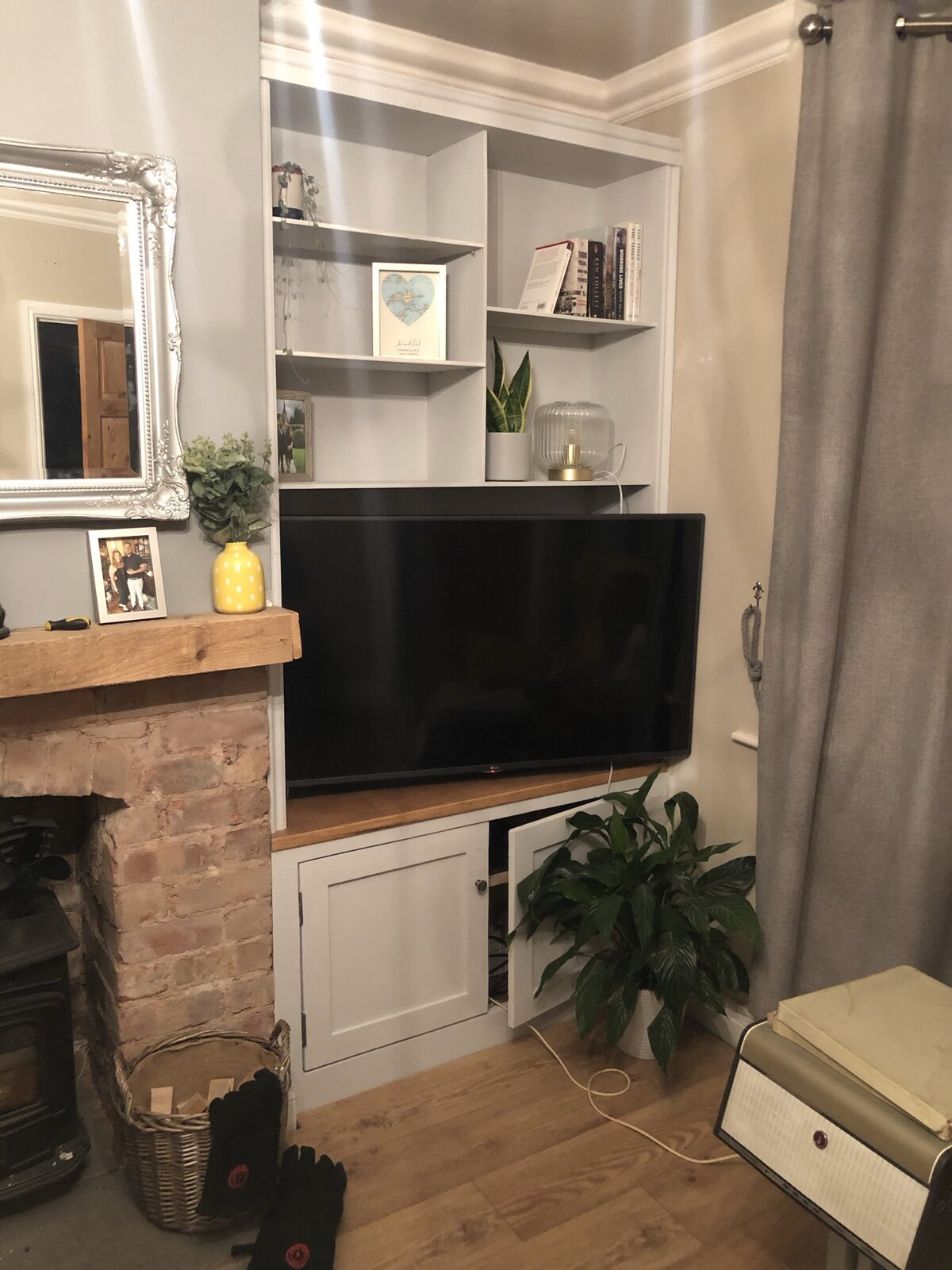

When we bought our place the TV was above the fireplace and it was horrible. I know I sound like I'm being a n*b but all you saw when you walked into the room was a huge black rectangle on the fireplace -- your eyes were automatically drawn to it. It was also a poor viewing position.

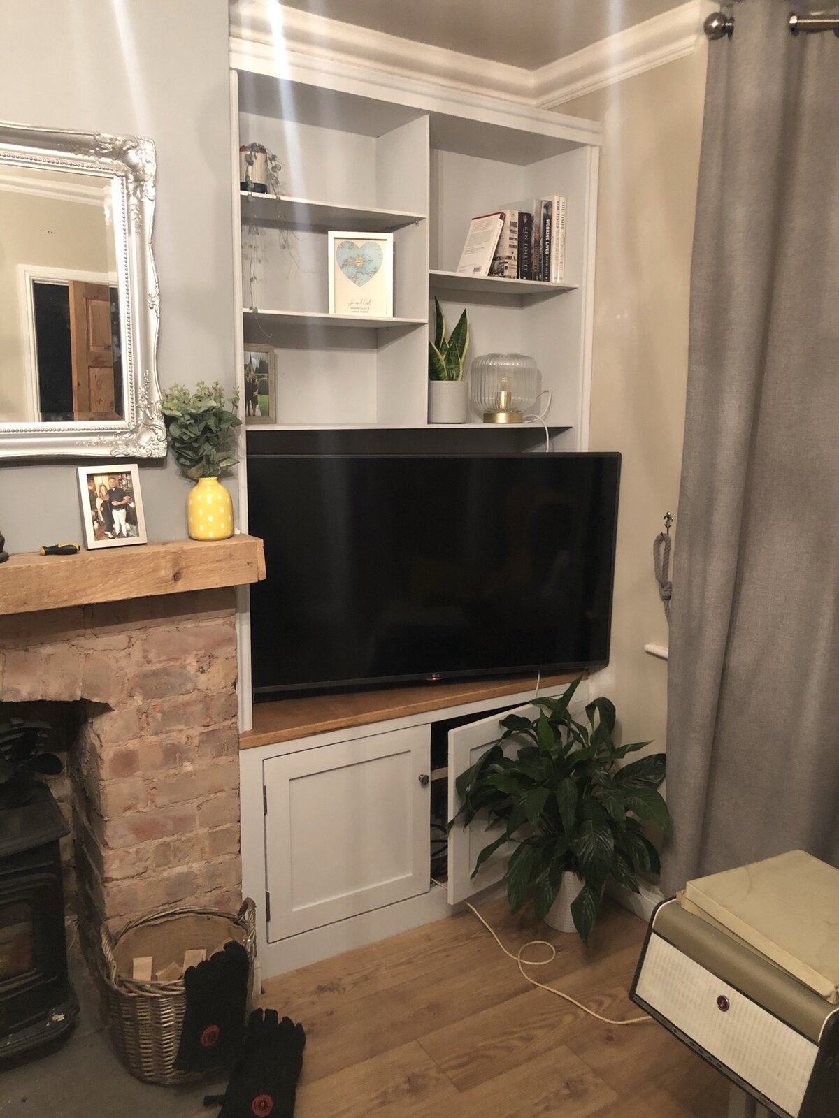

I moved it to the alcove, put it on a movable bracket and built a cabinet around it. It probably cost me about £180, but I did go rookie and go to Travis Perkins and not the timber yard. All the wires for the router (on top of the cabinet), the lamp and the TV go in the paneling on the sides where the wire is ran in conduit (pic taken before completion).
I would - having experience of the same - do something like this. Even if it's just stuck on a bracket with a shelf or cabinet below it'll be much better.

Thanks. I get the issue with the big black rectangle. What i really need is one of those Samsung "the Frame" tellys that look like artwork most of the time. Not only would it look appropriate at this height, but it's fed by that clever little box that you plug all your soundbar, Sky/virgin box etc into so you can hide all of that stuff away, and then there is a single cable from teh box to teh telly. And in reality I may well get one: I can then move this TV into the kids room; and their TV into the spare room to replace the telly in there that just broke... let's see what Black Friday throws up.
AS regards alcove: that is absolutely my preference and where I really wanted to put it. Your unit looks great. But in this room the alcoves would only accommodate a 42 inch TV. And the whole point of the room is to watch telly - its not our main living room, we'd only ever sit in it once the kids are in bed!
