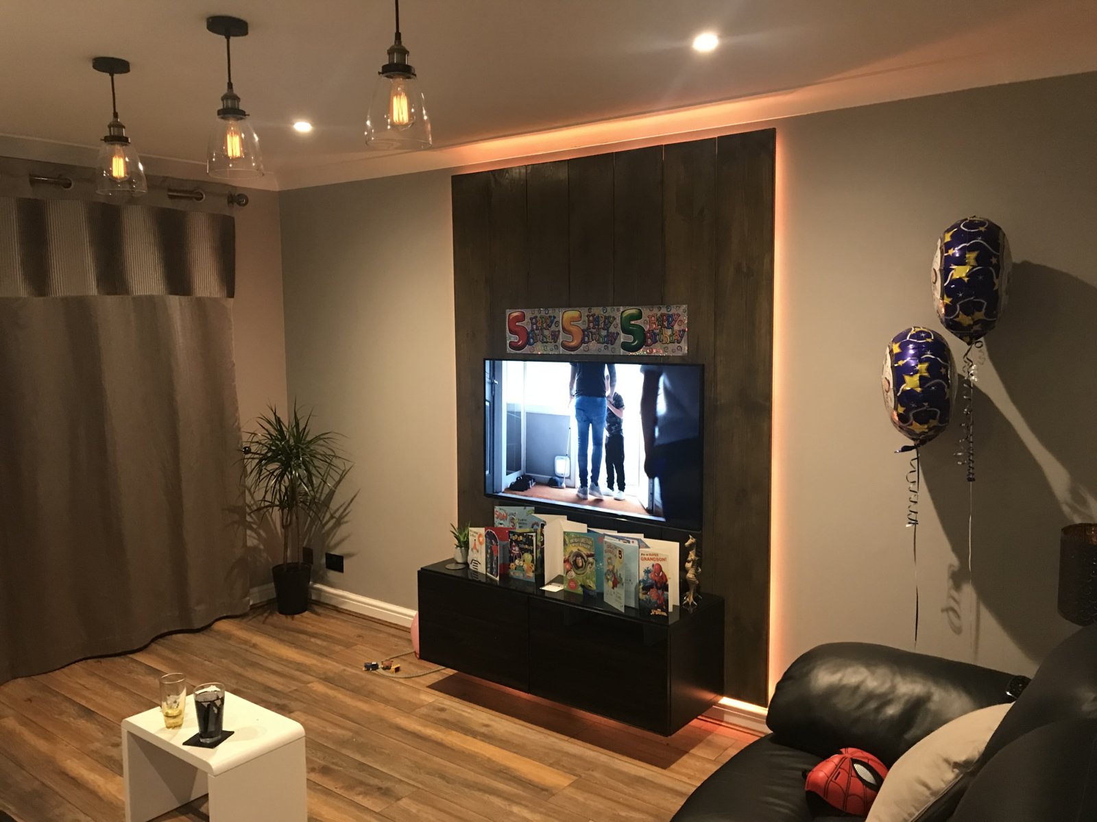

You could do a floating panel up the middle. Mine is wood but they look good with split face tiles on as well.
The wires for mine I had buried in the walls when we first moved in but the tv looked lost against the wall. Wife would t get a bigger tv so we opted to do the panel to break the wall up a bit.
Would hide all the wires easy enough and make the tv look more flush
