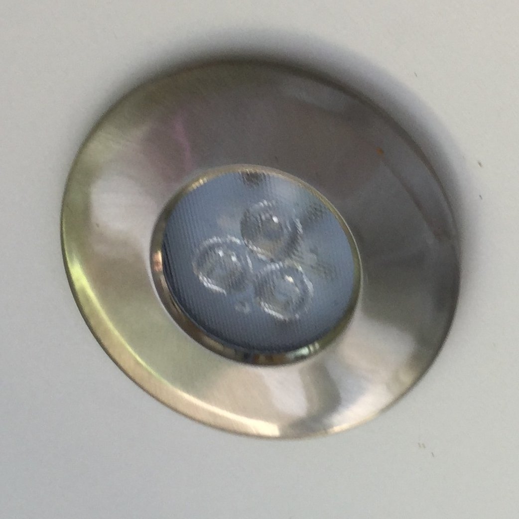

I cannot find how to replace the bulb (picture attached).
The housing pulls down around 1 cm. There are no clips or springs etc visible to me. The metal rim does not seem to unscrew - unwilling to use excessive force without knowing that that is the correct thing to do.
Any advice?

Alot of LED fittings do not have a replaceable 'lamp'.
When the unit fails to work then its end-of-life.... replace the whole unit.
It's probably an integral unit. No 'bulbs' to replace. The whole unit probably needs replacing, and they probably don't make them anymore. Could be wrong of course.
Some downlights have spring clips on the circumference that bite into the plasterboard- try turning the bezel clockwise or anticlockwise (if one direction is much easier than the other then combine turning in that direction with a bit of downward pull and that should do it
Others have butterfly clips (usually 2) that are sprung & bear onto the plasterboard. Downward pull should get some resistance but shouldn't need massive force
And as others have said good odds the LED is a 1 piece thing with the bezel, not a replacable lamp.
thanks all - I will try a firm twist and if that fails remove the thing and look for a new set of 6 lights :-(.
