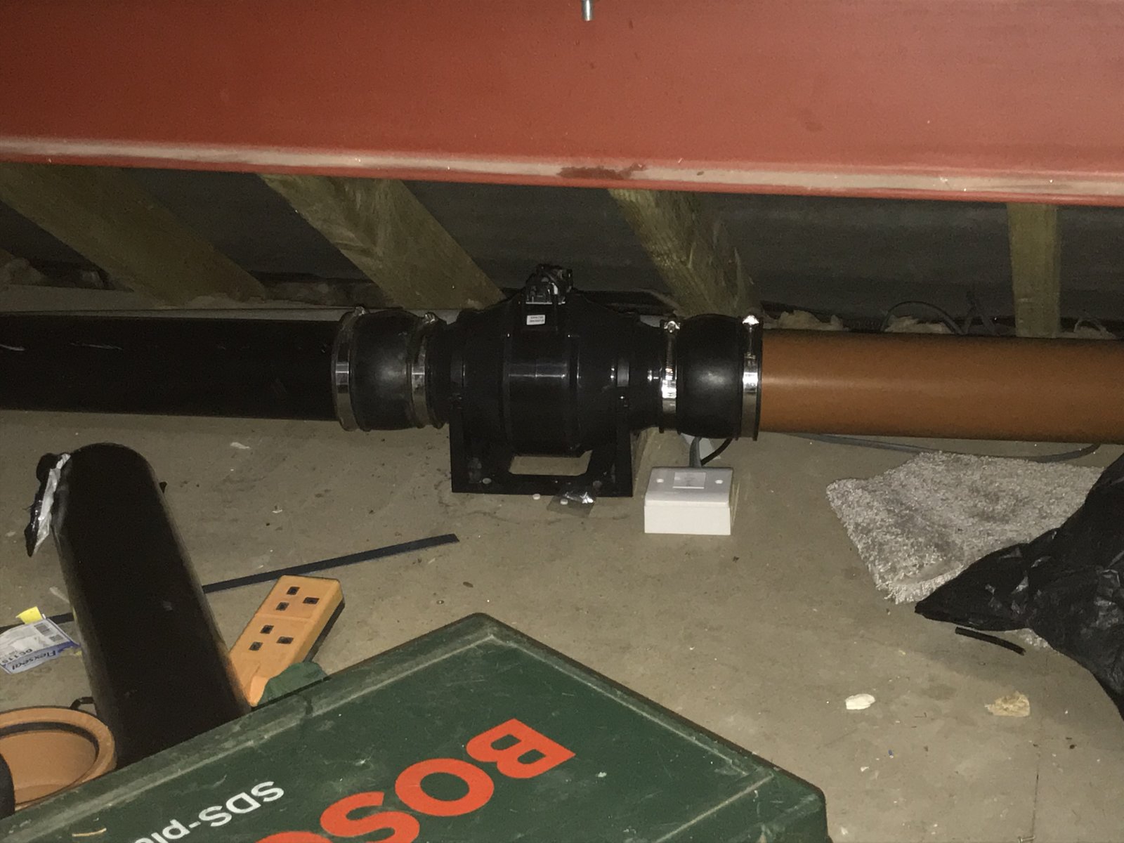

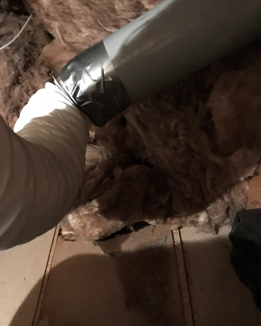

I've installed an in-line extractor fan (brilliant idea that came from this forum) for my bathroom extraction. It has the white duct which then connects to a solid pipe (this was there previously).
I've just noticed that there is a water drip where these pipes join. I slipped the white duct over the solid pipe and then wrapped some duck tape over it.
The lighting isn't great in my loft but I've attached a few pictures.
How do I achieve a water tight seal please.

You need to make a proper seal where the flexi connects over the hard plastic pipe - Best way to do that would be with the bespoke connectors linked to previously or alternatively large jubilee clips. Wrap the end of the plastic pipe in several layers of duct tape to take up a bit of the gap, then push the flexi pipe over it and tighten the jubilee clip down. The tape will give a softer area for the clip and pipe to seal down onto.
Those rubber flexiseals won't work with the flexi pipe, better suited for the hard pipe. There would need to be a hard liner in the flexi for then to grip to and then you are back to the same situation
Just be careful not to pierce the flexi pipe as that would just defeat the purpose. As suggested though that condensation from a bathroom extractor is common in these situations especially with longer runs and where the air velocity can be reduced, so you may have to find someway to cater for it.
