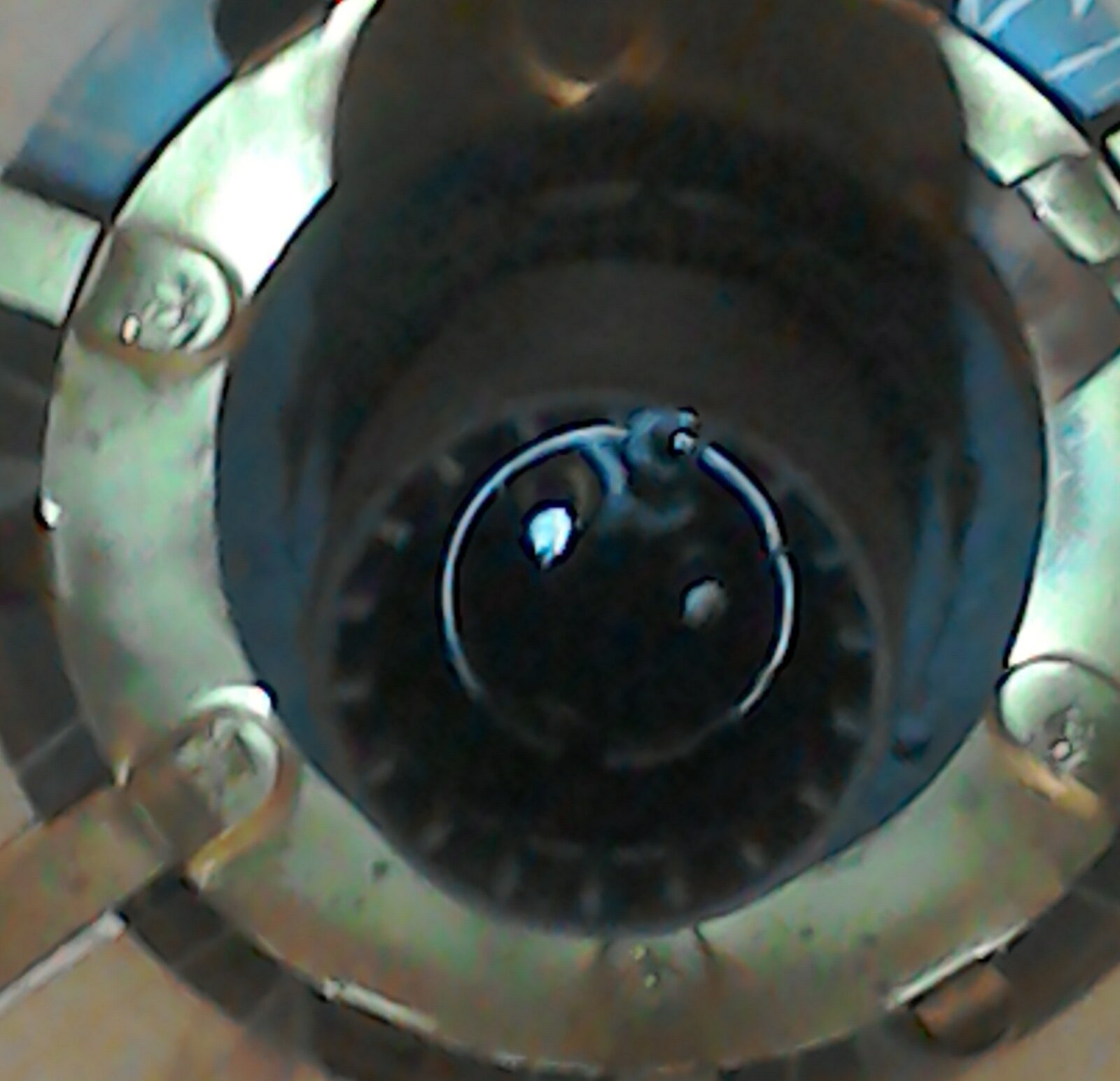

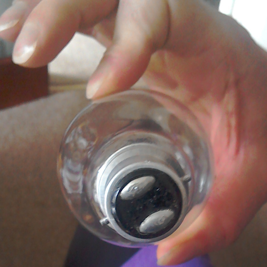

Remove the lamp and take a pic of the contact end of the lamp, and of the socket that the lamp connects to.
Post the pics on here.

Here you go. I've also just noticed that on the glass end of the bulb it says "220-240v 100w". Does this mean I'm good to go?
