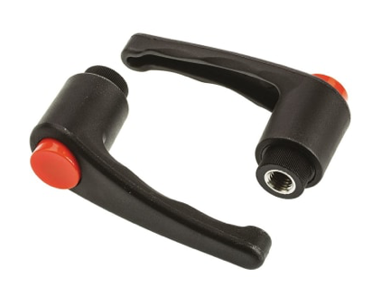

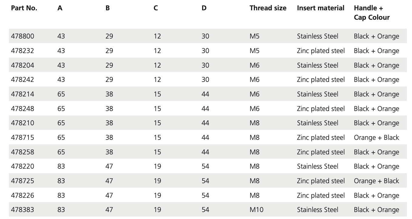

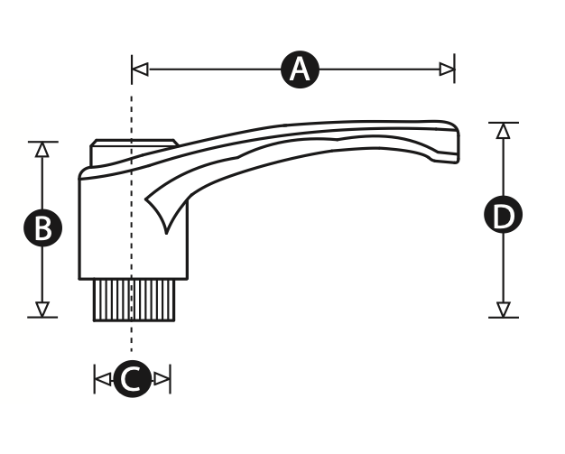

I have an M10 threaded rod 90mm length and I want to screw it into a clamping lever. How do I do this without damaging the threads on the rod and ensure it is as tight as possible? The lever will receive a lot of force in both directions during use so the rod needs to be rock solid. Hope someone can help. Cheers.
show us the lever, indicating how far the pivot is from the hole for the studding.
Here you go. Does this help?

is the lever intended to pull the studding up a short way? And the studding screws in and out of it? You wind it round, like a car window winder? It looks closed at the top, so the studding can't project through.
If the winding handle is only 83mm long, you won't get a lot of force on it with your hand.
Put 2 M10 nuts on the threaded rod, (sometimes called stud iron), slightly further back from the length of thread you want to screw into the handle.
Lock the 2 nuts together using two 17mm spanners. Run the rod intp the handle as far as it will go by hand. Using one of the 17mm spanners turn the nut which is furthest away from the handle until either the rod is fully inserted or you have reached the desired length. Using the 2 spanners you then unlock the 2 nuts and run them off the rod by the opposite end.
If you want to lock the threaded rod into position in the handle you can remove one nut and use the remaining one to run down to the handle and lock it tight using the spanner. This will prevent the rod from coming loose and falling out.

The studding stays fixed inside the lever, it won't move up and down inside the lever. The lever is there to give leverage to tighten the stud into a hole the stud is screwed into. Not sure what you mean about not getting a lot of force.

Thanks. Sounds good. I do need the stud to be locked in, but I don't want a nut to hold it in. It needs to be screwed in as tight as possible without a nut showing underneath. The lever will receive a lot of force in both directions when in use, so needs to be tight enough that when it receives that force the stud doesn't start undoing.

You just screw the studding in and give it a nip when it bottoms out.
If it comes undone when you undo the lever put some locktite on the thread.
Female levers work fine on studding.
Obviously you need a big washer between the lever and whatever you are tightening down onto
Loctite on the thread in the handle.
