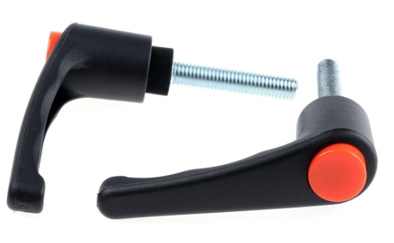

How do you install a threaded rod into a clamping lever?
Not sure what you mean by 'giving it a nip when it bottoms out'. And also what do you mean... 'If it comes undone when you undo the lever put some lock time on the thread'? Sorry I'm a total noob when it comes to this DIY talk lol
A nip is a bit of a turn with a spanner, enough to lock off, not enough to smash the lever handle.
Yeah locktite....stoopid iPad autocorrect.

There are lots of different types of loctite. Loctite 270 needs heat applying if you ever want to undo the joint. It's that strong.

Wow, sounds good. So would this provide enough resistance so that with a lot of force applied on the lever it keeps the stud locked in? The lever will require some heavy turning by hand, in and out, so the stud staying put is essential.
Red loctite has caused many mechanics to consider a new line of work. It can be impossible to undo.you need to make sure that the metal is clean and free of grease, allow time to set
the lever will receive a lot of force in both directions when in use, so needs to be tight enough that when it receives that force the stud doesn't start undoing.
You could drill a small hole diametrically through the handle and studding and insert a pin/rivet/grub-screw to lock the studding into the handle.

It's often referred to as "stud lock" by engineers but it's the same stuff.
Spread a little evenly on the part of the thread that will go into the handle. Once you screw the rod into the handle the 'stud lock' will begin to set because you are removing the air from the thread. It's the absence of air which activates the glue. If you ever need to remove the thread you will have to use the 2 nut method as I described above but in reverse. i.e. lock the nuts together and then undo by using the nut nearest the handle.
John D is asking if you can show a picture or drawing of what the other end of the stud is going to be screwed in to. So far we know one end is going to go into a handle. What is the handle going to operate at the other end?
