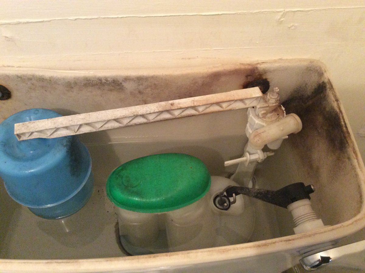

Hi, I'm inexperienced with plumbing but keen to give it a go... also female so don't have man strength or many tools, but have a few! My toilet makes loud foghorn pipe noises after flushing that is resolved when I lift up the ballcock arm. I think the washer may need replacing (after googling it), but I think it might be easier for me to replace the whole ballcock/valve thing. Two questions: 1. is it easy enough for for an inexperienced (though very practical) person like me to tackle? 2. What tools will I need? I think I need a tool/spanner to undo the plastic nut underneath the cistern, anything else? Thanks for any help! I could call a plumber but I'd feel annoyed it it's a simple job that I could manage!

Post a pic of your old one please. It might be side-feed or bottom feed. Side is easier.
You can get a new one of modern design which can be very quiet.

Thanks very much JohnD for your advice. Attached is a picture. It's a bottom-feed cistern. I wondered whether I should replace like for like (because the fit should be the same) or whether to get one of the newer styles? I'd like to give it a go if I can – I've done quite a bit of DIY in the past.

If quite handy at DIY then this is an pretty easy job.
Buy one of these -
http://www.diy.com/departments/fluidmaster-pro-fill-valves/34489_BQ.prd
and a 1/2" tap fibre washer
Turn off cold water
Flush toilet
Sponge out any water left
Disconnect supply pipe from bottom of valve, change the fibre washer on the supply pipe connector
Remove plastic nut securing old fill valve to cistern with adjustable spanner and remove
Dry off inside cistern at the valve hole
Fit new valve, orientate so the float doesn't catch on the flush syphon body, rubber washer on the inside, tighten plastic nut up hand tight (see instructions for nut orientation and if pressure reducing insert is needed) then a further full turn with adjustable spanner/grips - hold fill valve so it doesn't twist when tightening.
Attach supply pipe - with new fibre washer already fitted.
Turn on and adjust float level to fill cistern correctly (see instructions).
Check for leaks at nut to cistern and at supply connector to fill valve brass shank.
Thanks everyone for all your kind help and advice - pleased to report that I fitted the new ball valve this morning, all fine, easy job and took me less than an hour from start to finish, including reading and re-reading fitting instructions and having a cuppa midway! Chuffed that I did it, thanks to your good advice
