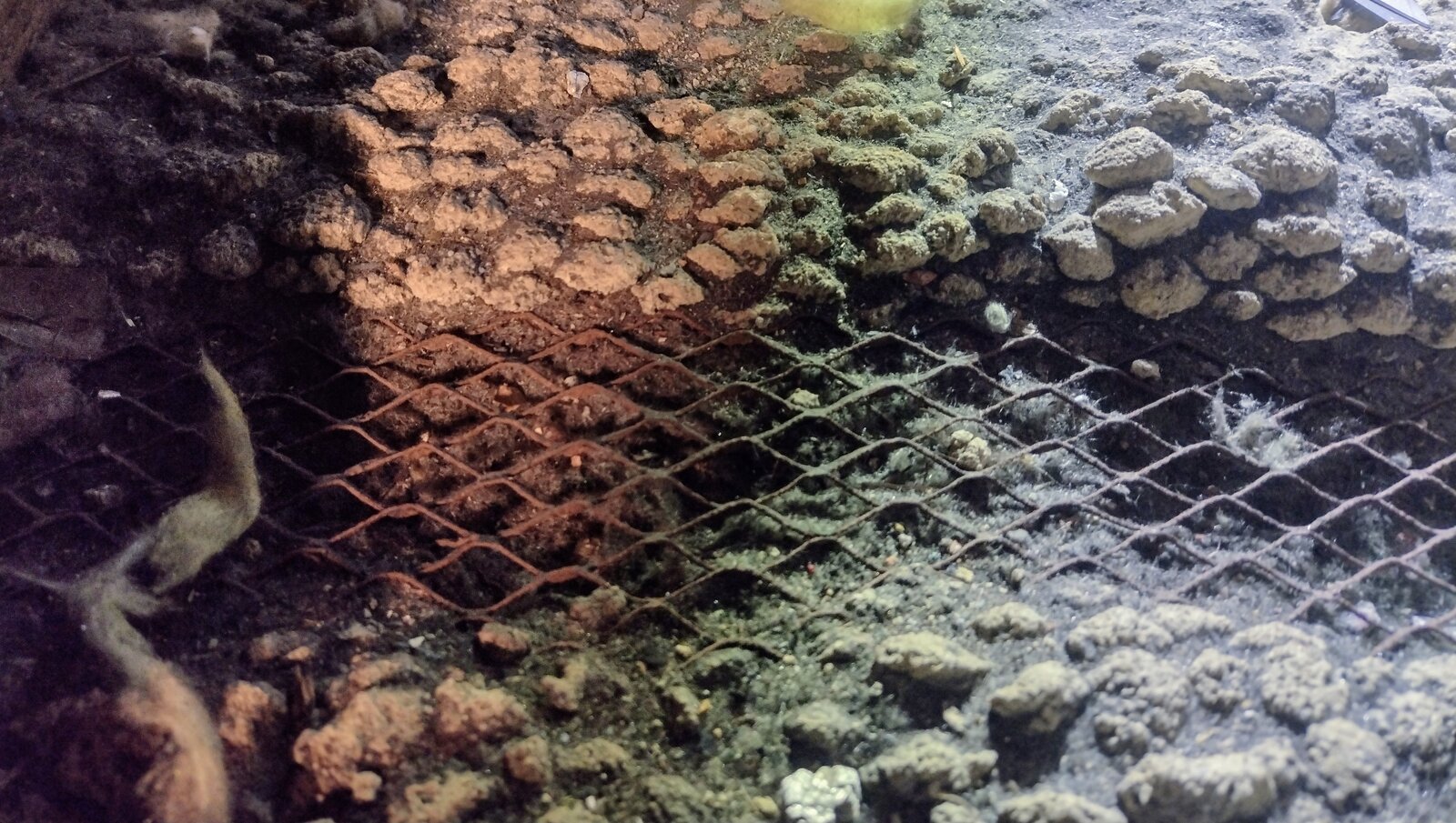

Can anyone tell me how my ceiling is constructed? eg what materials were used?
Picture is from the other side of ceiling as seen in the loft
The material is very solid.. And it seems to have metal mesh embedded in it

looks like chicken wire -I guess as an alternative to lathes
I guess it must pre date plasterboard -which has been around for about 100 years

The metal lath is in fact a roll of expanded steel mesh - aka ex-met . Rolled out and nailed to the joists.

This method of ceiling construction is incredible. Far superior, stronger and durable than standard PB.
Assuming the metal is galvanised, this is better than wooden laths (not susceptible to damp, rot, insect attack etc)
The ceiling is at least 30mm thick

It’d normally be done as a repair to wooden laths, I don’t think anyone would ever mesh the entire ceiling and plaster onto it

Looking at my ceiling, I do not see any signs of wooden laths
It was used quite a lot in the USA for ceilings before plasterboard. The galvanizing can break down over time leaving the laths open to rust and failure.
It's a lot quicker to skim plasterboard than fill EML or timber laths.
It was quite common from around 1920's upto around 1950's but I've mostly seen it in non-residential buildings. Plasterboard was available at this time so you tend to see that in smaller residential properties. I don't know why, maybe the lathe and plaster was cheaper or maybe the plasterers were more familiar with the lathe and plaster technique coming from the old timber lathes?
It has similar problems to timber lathe and plaster in that the plaster de-bonds from the lathe and starts to crack although to a far lesser extent and the expanded metal lathe or fixings can corrode allowing the ceiling to sag.
I think it was a post-war thing where there was a lot of steel and production capacity. Whole ceilings were done by this method, not just repairs.

Yes, it's a real beast. Super solid and thick.
