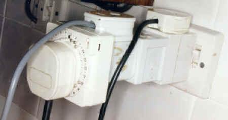

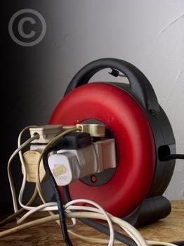

I would add to the above advice to make sure you always use suitable converter/adaptors according to the manufacturer's instructions. No matter how low your load, the following is not considered good practice... :D :D
Meh, the manufactures instructions often make inane statements like telling you not to daisy chain period rather than trying to explain when it is and isn't a good idea. Either that or they give virtually no information at all.
Agreed, it pays to give though to the physical stability and cable stresses in your configuration. Plugging together doubles/triplers/adaptos/heavy wall warts is generally a bad idea as is plugging in any configuration that prevents plugs being inserted fully.
