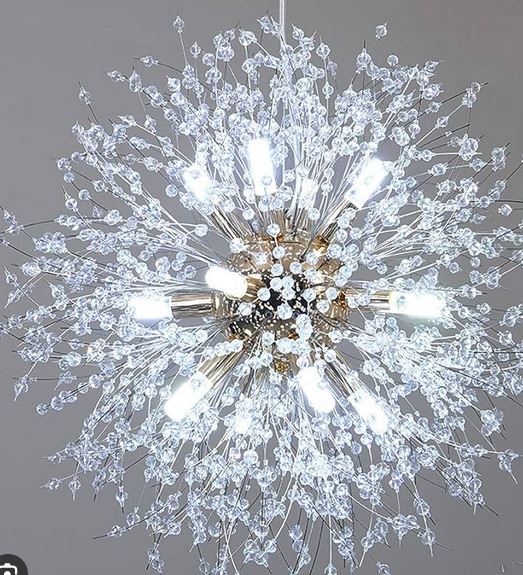

I have a problem with LED g9 bulbs not lasting very long, and they are in an open bare exposed bulb situation similar to this fitting. Most of the house are GU10 LEDs
