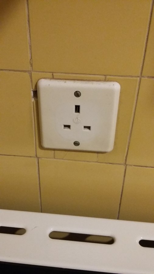

I've seen many of those surface mounted cooker sockets over the years, though not so much recently, but not seen one with that little door with the two screws.
What's the door for, a cable outlet perhaps??
EDIT, it's got a 5 amp socket instead of the more the usual 13 amp socket.
The door must be to house a 5 amp fuse then, IMO...
I think it is a 15 amp outlet though it is difficult to tell from the picture. They were quite common with 15 amp outlets and 5 amp would not be enough for a kettle that they were primary used for.
Don't know about the panel.

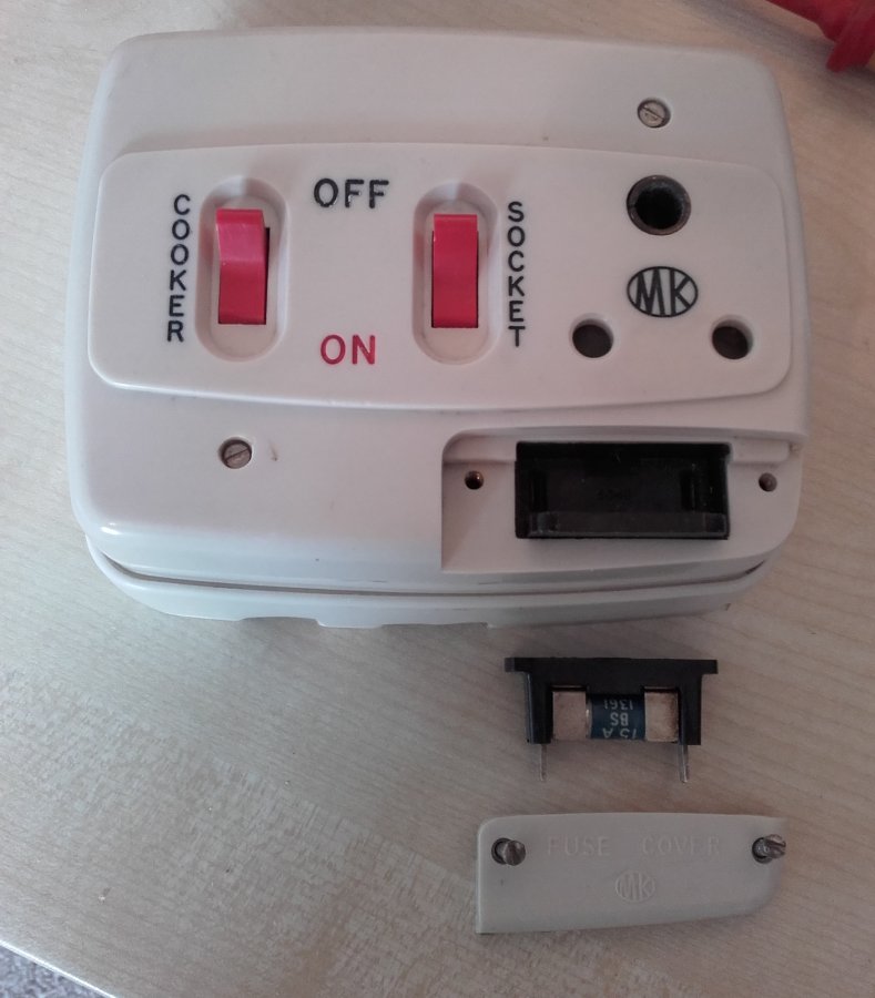

It's a 15A socket and there is a 15A fuse under the panel, I know as I have 2 of them here! The 13A version of the same type does not have the fuseholder. Here is a photo of the one I refurbished, when I got it it was entirely covered in nicotine stained gloss white paint!
The vintage kettle I use in my kitchen is rated 4.9A and is designed for 5A circuits.
