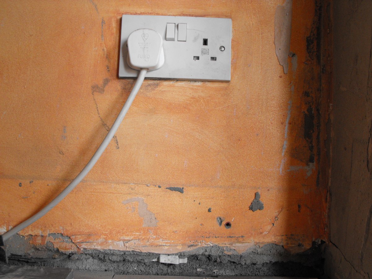

1. I need to sink a back box into a new thermalite wall before render/skim go on. Approx. how thick will the render/skim be? (how far proud of thermalite face should I set the box?)
2. What is that plastic cable protection that goes under the render called? Is it still legal? The image shows a very short length just showing at the bottom of another wall, below a socket.
16mm-ish is the 'usual' depth for wet+skim. I say usual because it can vary on the same wall. I very rarely chop in a 16mm box (unless asked).
So if you chop 10mm off the thermalite (for a 25mm box) that should be fine. But check with your plasterer.

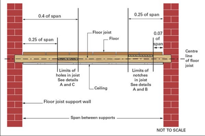

I'm putting one socket into a new thermalite wall, and one or two more into the other original conc. block walls. The room is on the 1st floor and the room below has no ceiling yet, just the exposed joists so I'll be running the cables along the joists and then vertically up the walls to the sockets. Are there any rules about where to site cables on joists? They're 200 deep, I thought mid height would be ok?
That's fine. BAS is referring to concealed cables in walls.
If you're dropping down vertically to each socket that's fine.
What you cannot do is go diagonally at any point etc.
If you google 'cable safe zones' there's diagrams that will show this clearly
