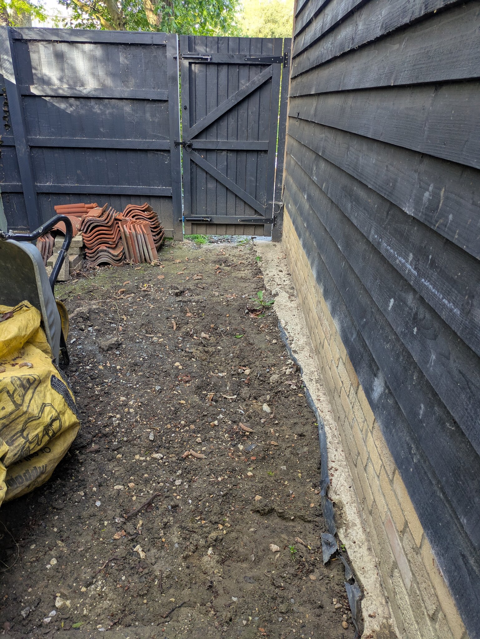

Hi,
This bit down the side of my garage is just begging for a path to be laid.
What's the best way to approach this DIY.
My concern is how to adjoin the pad foundation without compromising the single skin (double leaf) wall (which doesn't have a DPC at the bottom only at the top).
Path to be either concrete or paving slabs. No ACO needed along the wall, it'll just fall away from the building. Length is only 4M so at circa 1M width shouldn't need planning.
I wasn't intending to leave a backsplash gap for pebbles because a) the lad foundation is in the way and b) the wall has a DPC at the top which the timber sits on. The front of the building is open to air )cart lodge style although I'd love to put a garage door on it one day.
Which is these is best:
Lay concrete path to same height as pad foundation, with a jagged edge, sloped away from wall.
Lay on top of pad foundation? (Do I need to decouple with foam or similar?)
Something else?
Cheers v much.
Slabs. Concrete paths are ugly, why go to the hassle of mixing concrete and waiting for it to set, when someone else has gone that trouble for you and will sell you the final product (slabs) for not very much money.

He could colour the concrete to blend with the shed and dwarf wall and pattern it to look like slabs.
How large an area?
The area shown could be home mixed. But if it goes back 50 feet then it needs a different approach.
I tend to agree with slabs.

It's not a long area, barely 3 or 4 ft back from the camera.
Ill go with slabs then, on top of the foundation pad, with no foam.
How about DPM under the slabs? My concern is that water will draw up into the slabs, over the top of the old foundation (which has DPM underneath) and I to the wall. True, as already said, there is DPC between brick & timber but I'd rather not get a mouldy wall on the inside? DPM under the whole path?
lay slabs - but i would not want the slabs resting on the foundations for the garage, have them just on their own compacted base.
So I would either cut away a little of the protruding concrete (just the top 2") or / and move the gate a little bit further away from the garage, then the path can be indepedant of the garages foundation

Munroast - it was feeling the same that led me to ask the question in the first place. I'm just not sure why.

what is ever under the slabs needs to be exactly the same density, can't see it ever being a long term success if part of the slab was on another foundation - how would you get it level in the first place ?

Just lay it on the concrete. We are not talking Hoover dam or Brooklyn bridge here for heaven sake.
