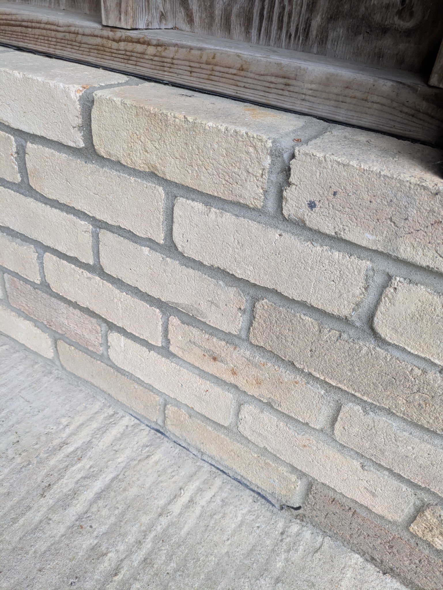

Inside of the wall pictured below - note DPC at ground level and also at the top. Seems odd to me.
External paving will bring the exterior level up to one brick above the lower DPC but well below the upper one. Until recently their was earth heaped all along here (half way up the wall) but I dug it back, cleaned up the wall and have already coated with masonry cream.

Load bearing on these is fine - I've got a path at the other side of the house which I laid with these 4 years ago with no issues.
20mm porcelain. Going on a 25mm bed of reinforced mortar (with priming slurry on the back of the tiles) and that'll be on compacted type 1. Am edging with 50mm concrete edgers.
If they're lapping over the concrete then they're going to have a rigid base on one edge, while the compacted rock beneath will inevitably sink over time.
They'd be OK on concrete or on compacted rock, but not spanning the two.
