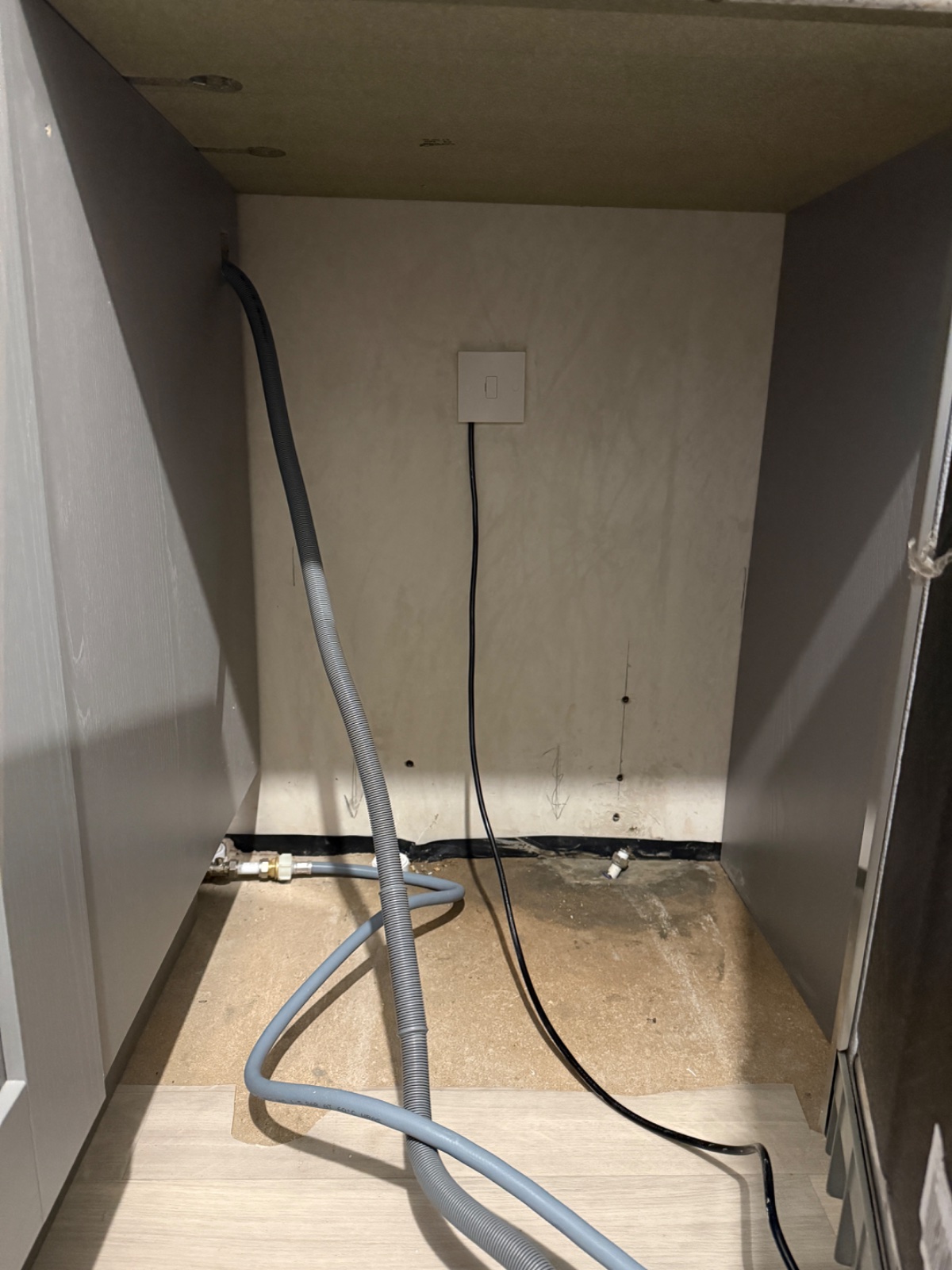

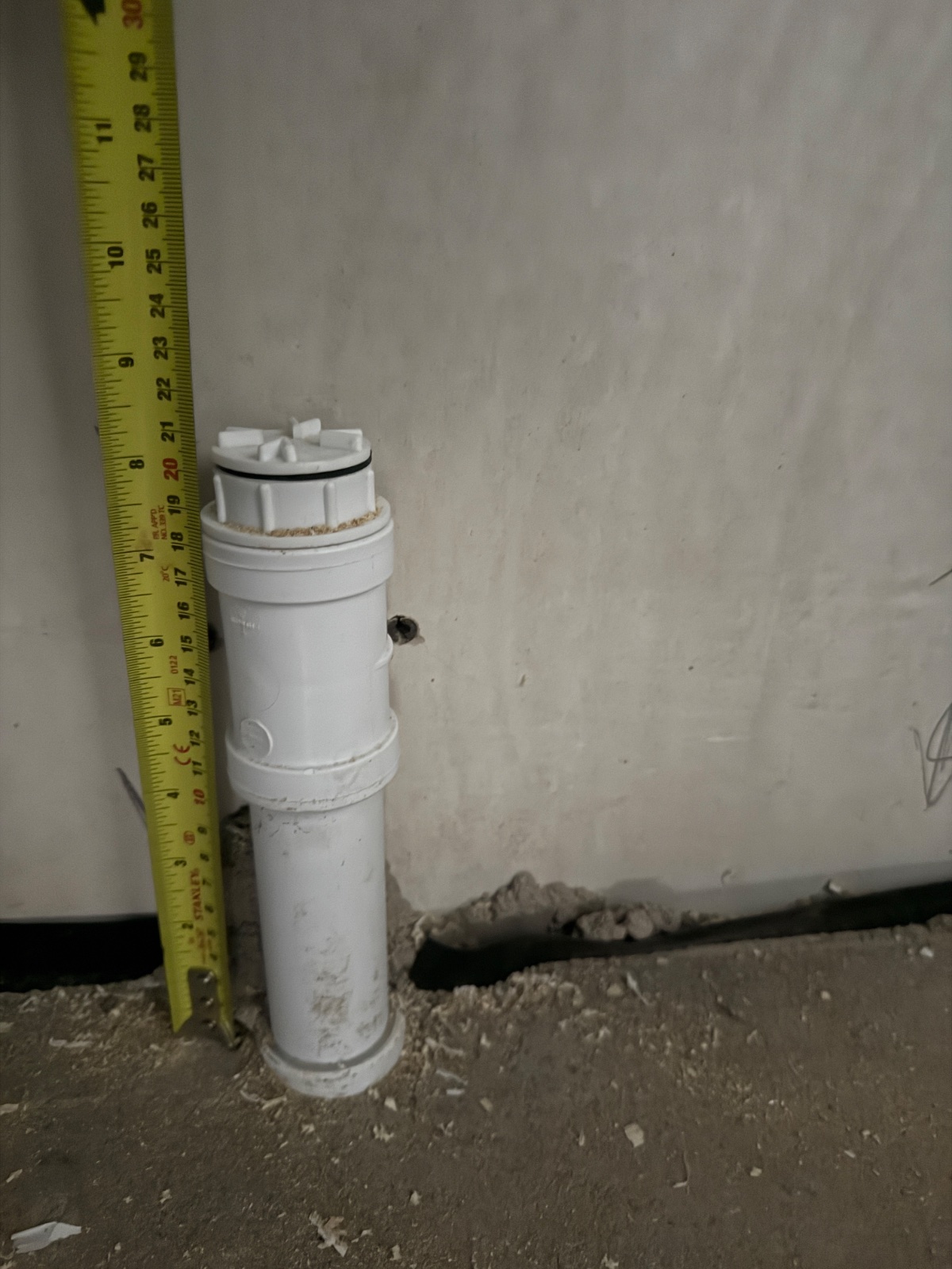

Any ideas on how I deal with the waste pipe? If I cut it down to below 120mm so it slots behind the dishwasher, then how to blank it off? Currently it has a screw cap.

Is it a push fit coupler that's on the pipe with the blanking plug in it?
It was, and the 40mm pipe was inside a push fit sleeve coming from the floor, so I just removed the pipe and used a 40mm push fit socket plug (£1.50) to plug it. A very easy solution to what I thought was going to be a difficult problem.
UPDATE:
In order to get the dish washer flush with the wall I swapped the plug socket with a fused spur, removed the waste pipe that was coming up the wall and plugged the outlet at the floor with a 40mm push fit plug, and bypassed the underfloor water pipe by disconnecting it at the inlet and running a separate pipe with valve under the cupboard. Now the dishwasher goes right in tight.
I wasn't sure if it was pushfit but I did see that socket in the floor and thought if it was, you could plug it flush to the floor ;)
