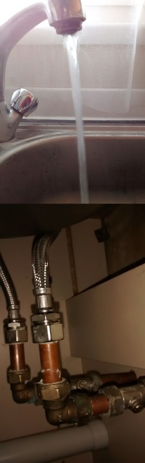

The hot water comes out too thin and I'd like to change it.
Thanks.

It appears that the isolators are not fully open, Also if you can remove the flexies and pipe direct to the taps in 15mm copper that will help, and this will also give you purer water.(flexies harbour germs)
Which part do I untighten? I tried the silver part but it wouldn't budge.

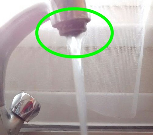

where the spout narrows at the end, that should unscrew. Is it all scaled up? you may need an adjustable

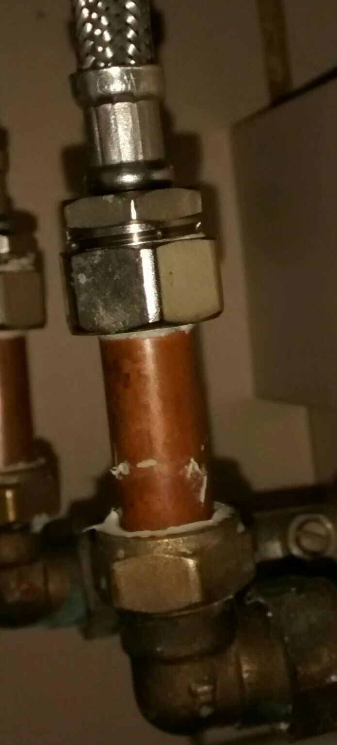

look at the screwhead in the bottom off that picture it needs to be horizontal -------------- and its a bit ----\
But if you are going to undo the bottom nut make sure the little slot is vertical first!

Before a flood is caused, these are what can be done:
This piece at the end of the tap highlighted in green can be unscrewed and either cleaned, or replaced with a new one.

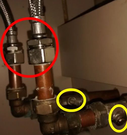

If that doesn't do what you want, then the silver screws highlighted in yellow here should be turned with a screwdriver so that the slot is in line with the pipe:
The third item is to replace the braided hoses with solid copper equivalents, which involves removing them from the fixed pipework circled in red, and also unscrewing them from the tap itself, which will mean removing the tap from the sink as well. There are several sizes of those available and it may mean alterations to the other pipes as well, so if unsure, do not attempt.
Do NOT undo the red circled items without turning the water off first, as doing so will cause a massive flood.
Water is turned off by turning the screws (yellow) so that the slot is across the pipes.
