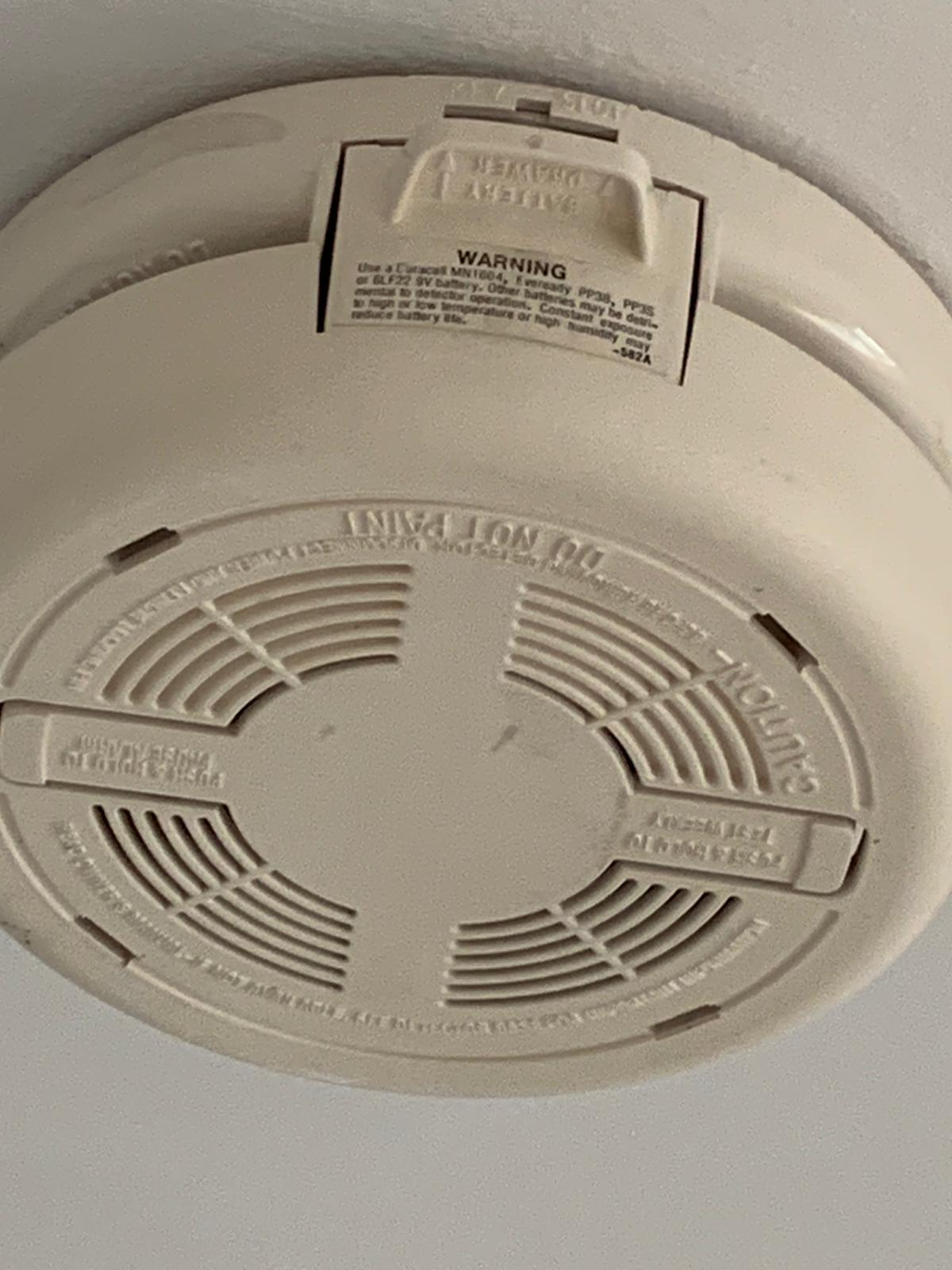

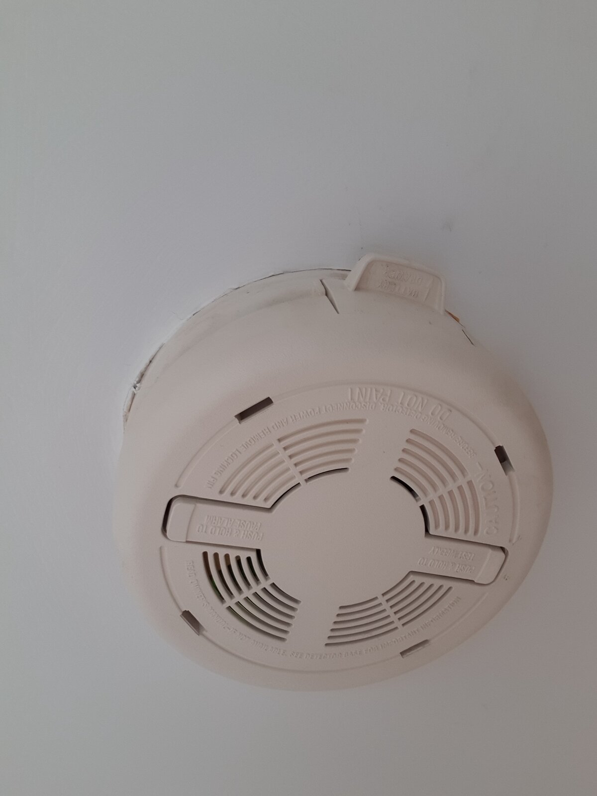

Hi All,
My smoke / fire alarm has been beeping over the last day & I assume that this means that I need to change the battery. It looks like there is a battery compartment which I need to pull out to replace the battery, but it seems to be stuck & I can't pull it out. I tried to Google it, but it's an old alarm & there is no indication of the make or model. I’ve attached some pics of the alarm. Does anyone know how I can replace the battery on this? I noticed that there is a “key slot” above the battery compartment. Is this of any relevance? Note that I don't have any “keys.”
Any help would be appreciated.

I have seen similar ones that need a small screwdriver inserted in a slot to release the drawer. Some lift a tab up some down or some just pushing in is enough.
Looks like a likely slot above the drawer on yours(y)
So I managed to figure it out. I had to twist the alarm until it detaches from its base, then press a large flap down with a screwdriver & then the battery case comes out. Strange because it is hardwired as well. Either way, opening it up exposed the brand & model of the alarm & it turns out that its from 1999, which is when the building that I live in was constructed (model NL3602). There isn't any literature for this model online. The alarm still appears to be working (I pressed the test button & it seems fine) but I think I should probably change the entire alarm given that it is 20 years old.

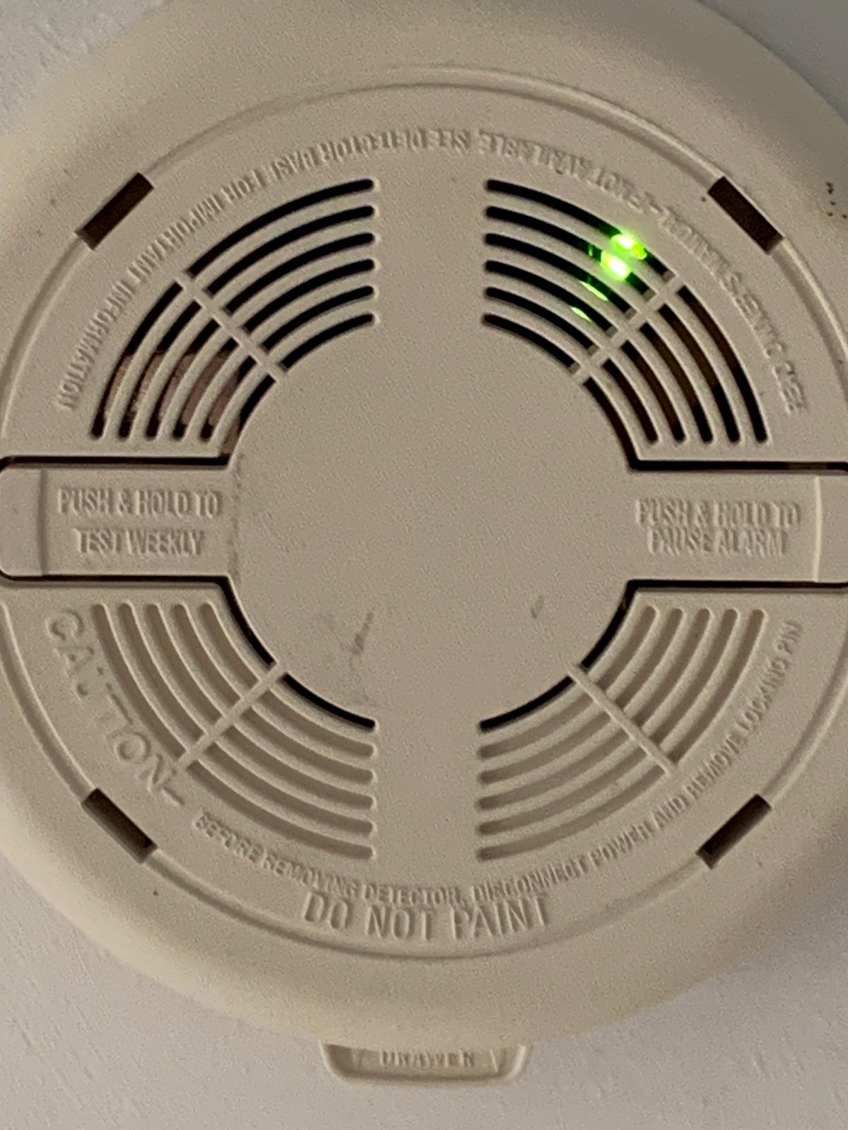

Hi Ducky, my smoke detector has been beeping away last few days so think it needs a battery replacement. It looks the same as yours. I don't have a key for key slot and can't figure out how to remove the battery carriage. Please can you let me know exactly how you managed to do it? TIA
Hi, I did manage to get it done after a considerable amount of trial and error. If I remember right, you need to twist the main unit until it detaches from the ceiling mount. After that you will see a flap where the battery casing is, which you need to push up (I used a screwdriver to push it up). Then pull out the battery casing and replace the battery.

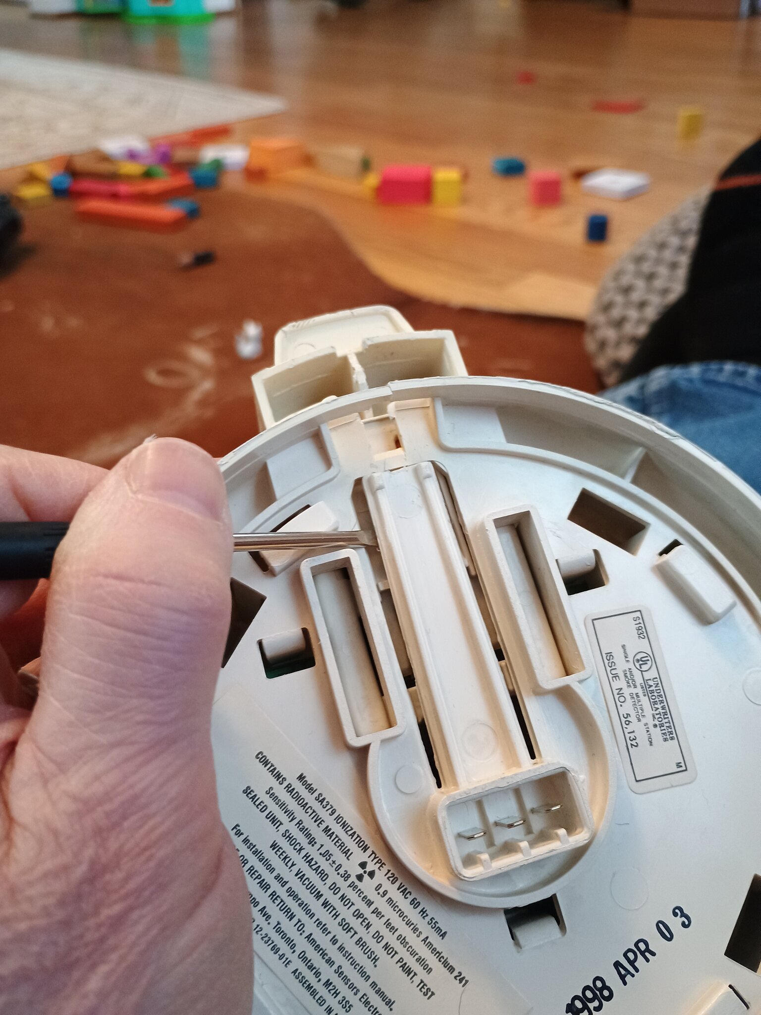

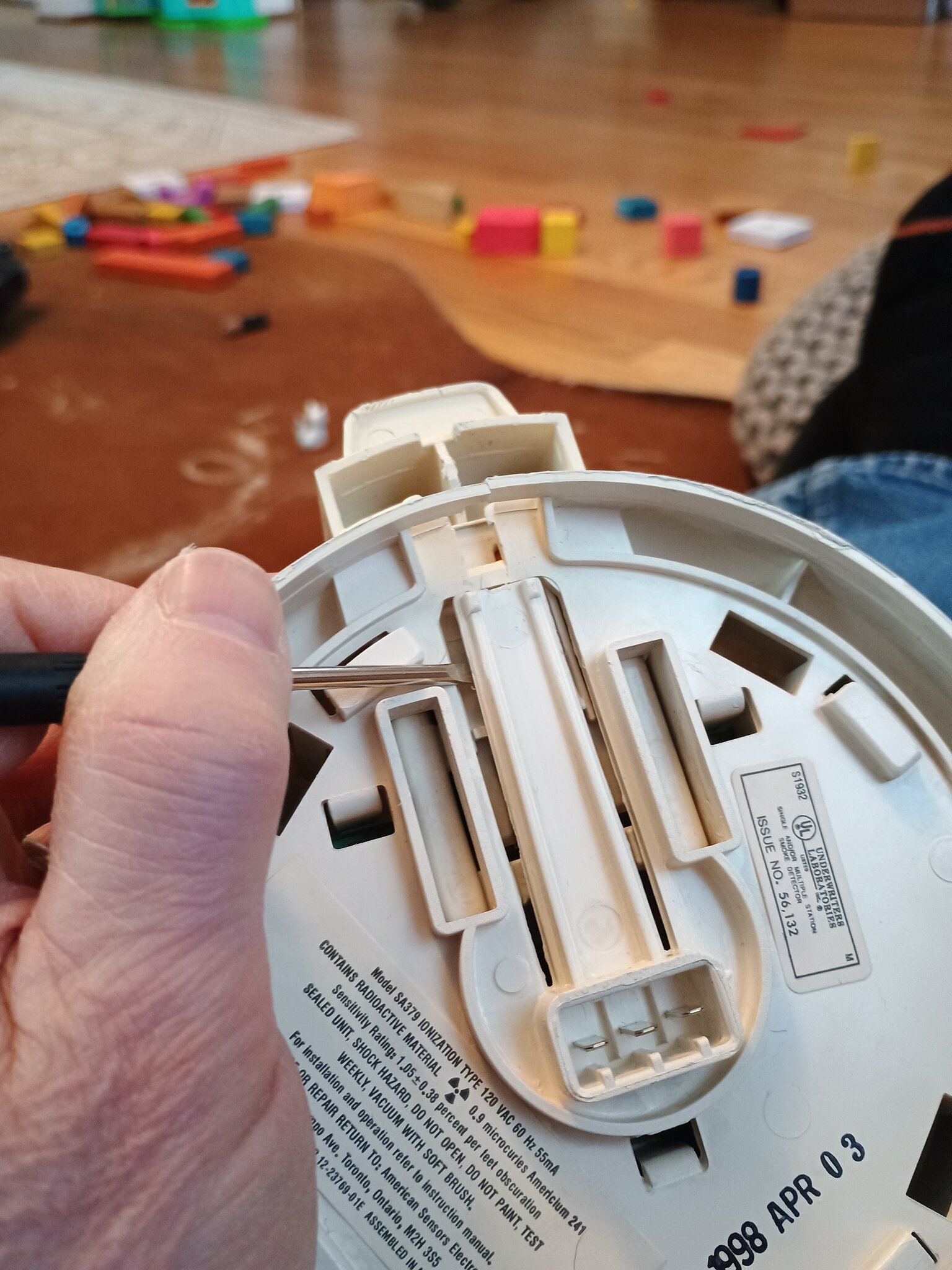

Thanks for all the comments here. I got it by turning the smoke alarm over and putting a screwdriver underneath the edge of that panel, as folks are calling it, to pry it up. Hopefully, I'll be able to attach a helpful picture to this post.
Thanks for all the comments here. I got it by turning the smoke alarm over and putting a screwdriver underneath the edge of that panel, as folks are calling it, to pry it up. Hopefully, I'll be able to attach a helpful picture to this post.View attachment 410739

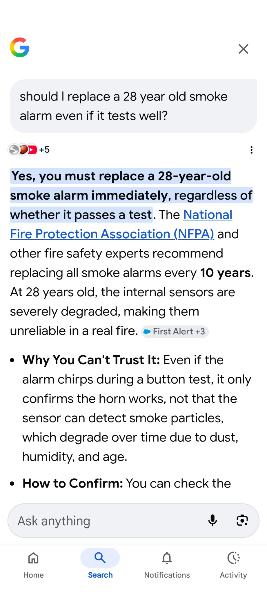

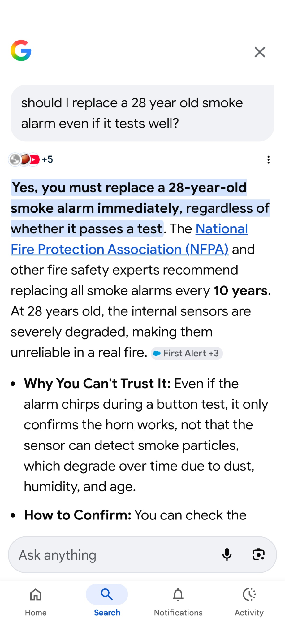

AFAIK, smoke detectors should be replaced every 10 years. I am guessing that 1998 is the year of manufacture.
Yes, I googled that before I reinstalled, and should've left a post here. I'm glad you replied with that. I'll do the same with the other thread.
