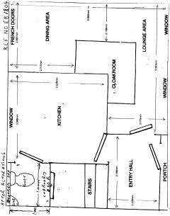

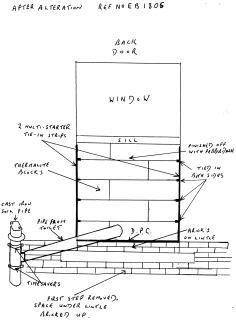

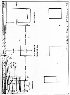

Hi all,i applied to glasgow council for a building warrant for infilling doorway with blocks & putting in a small window at the top,fitting a cloackroom toilet behind infill, i was wrongly informed that i could do the drawings myself on A4, they were rejected, my question is do i have to fork out for an architect to do them, or is it possible to do them myself with software and them be accepted, and if so how would i get it onto the proper scale of paper,perhaps somone knows a few sites that will help me do the drawings

i put a lot of work into them, & gave as much information as possible but they just showed me examples which were bigger than my A4s & had more details on them,

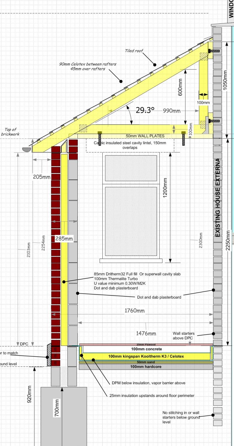

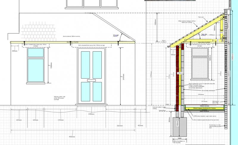

I did mine using Visio. The most important thing is that they need to be to the scale specified, and each sheet should have a date, scale, version, filename, direction of north (or is that just for planning permission...)

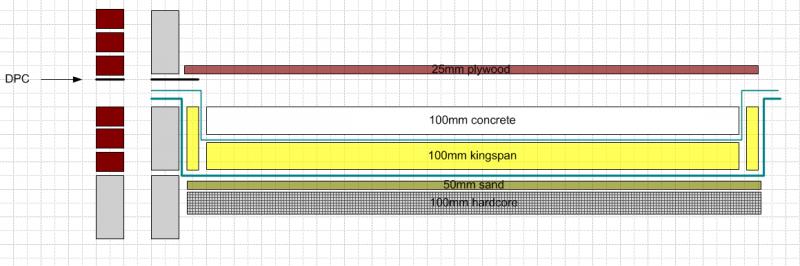

Obviously they need to show the required level of detail too - so show wall cross sections with cavities rather than just single lines.
Can you scan/post what you submitted and we'll give you feedback?
Edited to say - mine were pretty much as you see here, but I've cropped them down for use on this forum:
(plus some floor plan diagrams, drainage, etc.)
