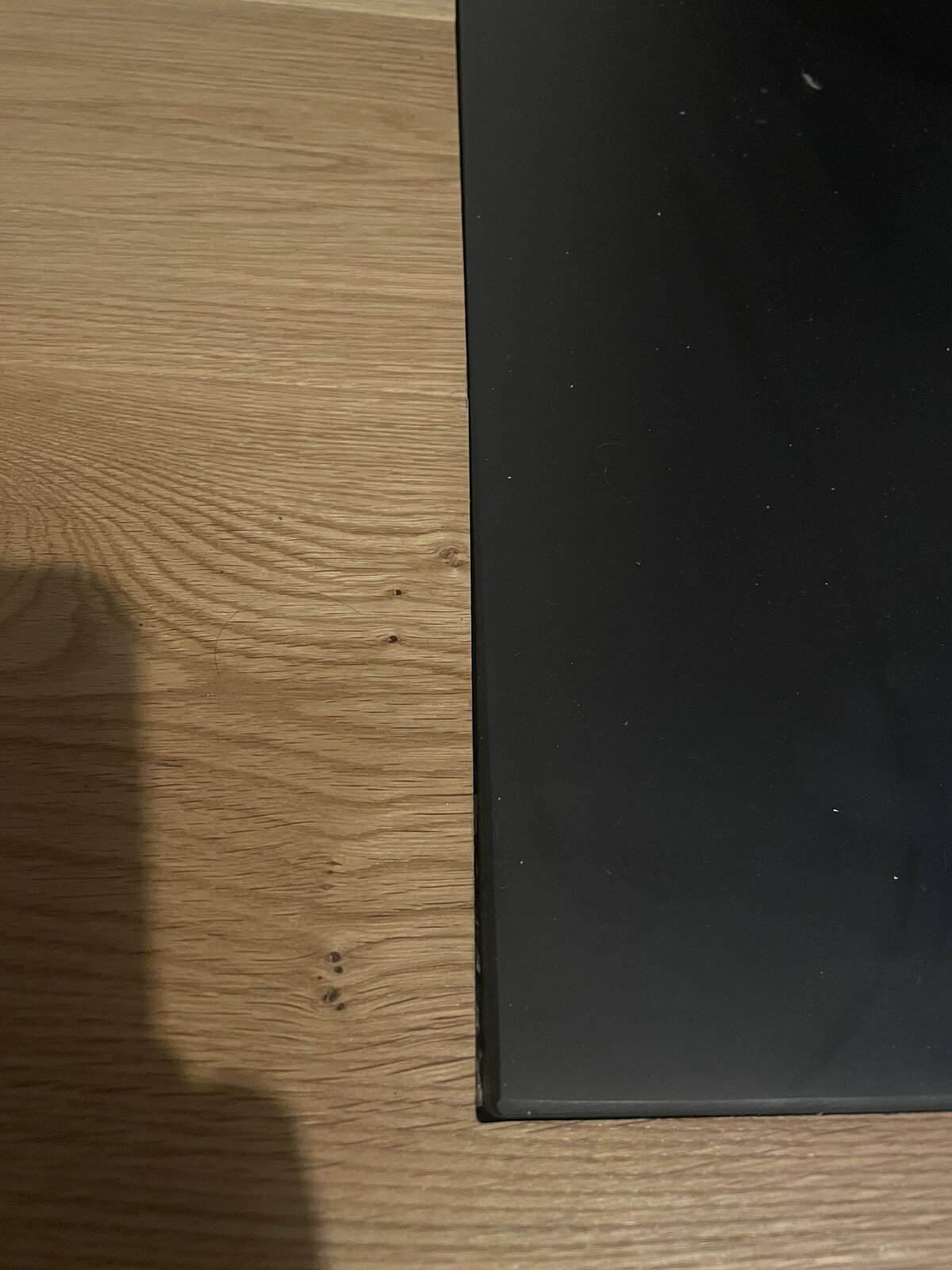

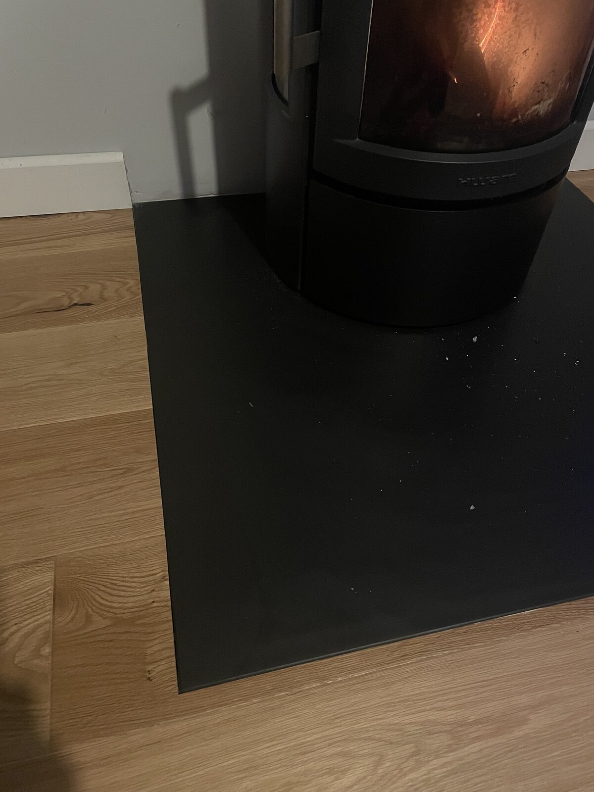

I want to fill the gap between a slate hearth, and a floating engineered oak wooden floor.
We have a wood burner, and ash has a tendency to find its way into the gap.
How should the gap be filled please?
Hope you have left a big expansion gap on the walls as that wood is to close to the fireplace. You should cut it back 30mm then put a solid oak T bar doortrim in
