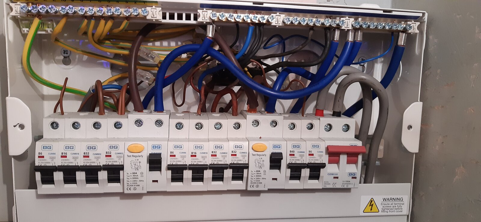

how to find earth leakage in light circuits

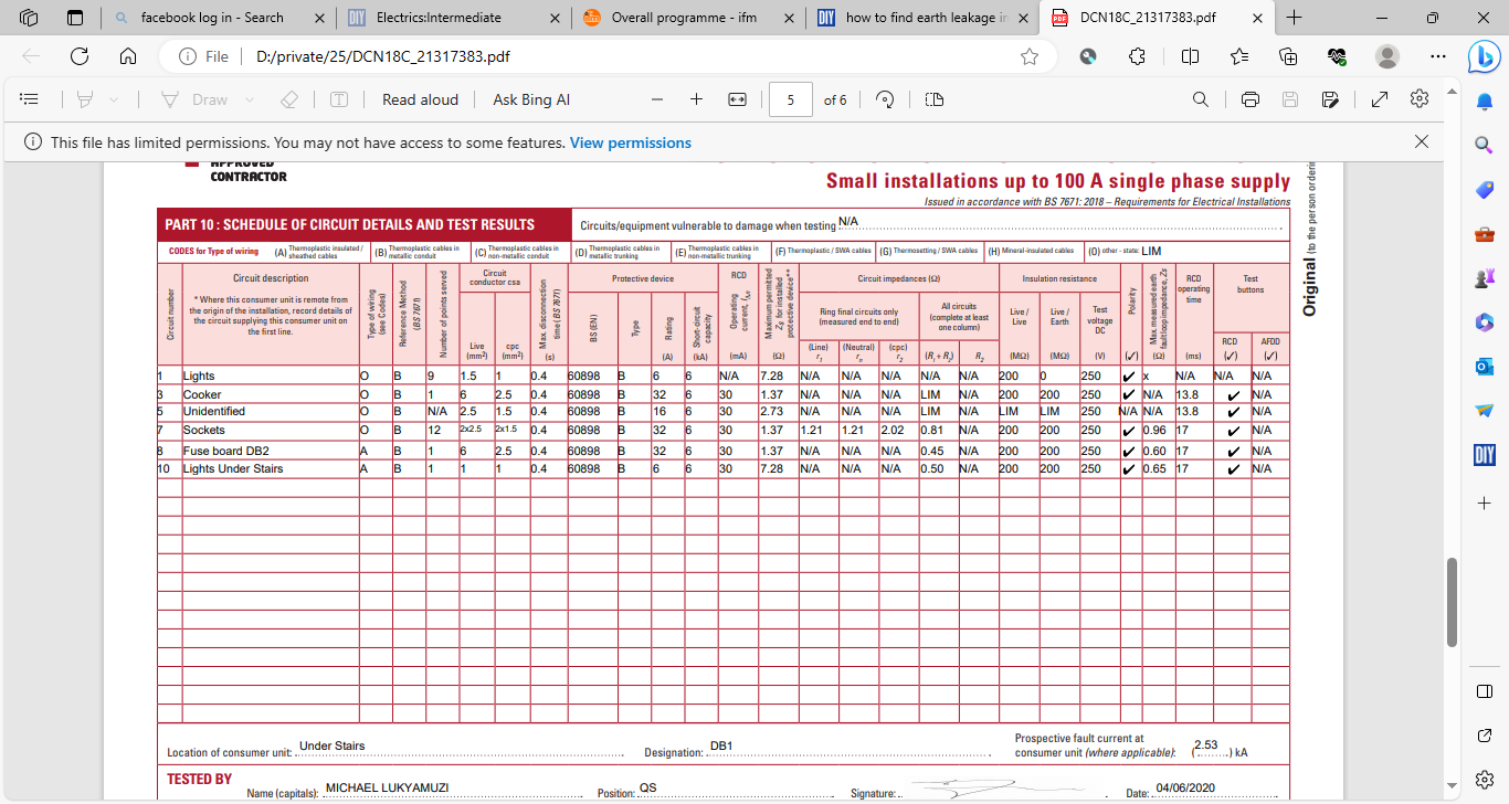

In view of that picture of the consumer unit, (a bit different than the description and certificate) I would hazard a guess that you might have what we call a borrowed neutral on the stair landing light circuit.
If I am correct, this will indeed require some rewiring of one of the lighting circuits.
Not 100% sure I agree with this.
you could find the fault, fix it and replace the MCB with a RCBO for all the lighting.
How old is the property ?
Why fix it now?
waiting for the tenants to move out so that we can rewire the whole property. However, they have been looking for alternative accommodation without success. And I do not think they will move out soon as thier daughter with her 2 years old son just got divorced and moved in with them. however, I was told is not a serious issue...
this is the inside of the CU. the 1.5mm wire on the far right next to the main Switch is the only wire for both upstairs and down stairs light. one of the ways I would start Tshoot the issue is to move from the far right MCB to the fifth from left RCBO, switch all then lights off and then switch them one by one and see which one trip the RCBO. do you think that would work?
Leave it alone and employ somebody competent
Whats the one on the far left then?
