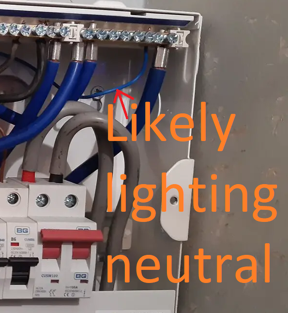

If the fault was a borrowed neutral there would be two circuits which are not RCD protected, since only one we can discount that. Other cause is where electronic switches are fitted which need a neutral, and some one has used an earth instead, so I would look for any dimming switches.

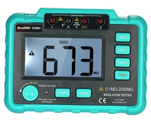

The next is the fixing screws in the switch pinching the neutral, this needs a tester, and removing all switches, there are two ways to test, one is use an insulation tester

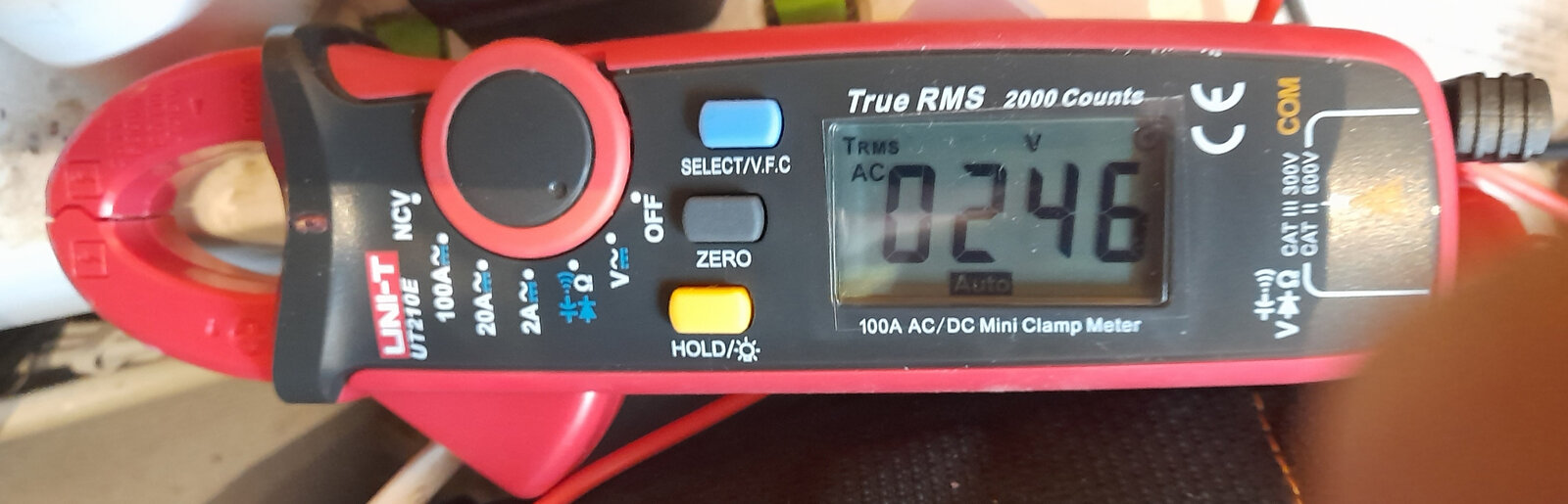

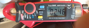

the other a clamp on ammeter
both the ones I show cost £35 when I bought them, and need some skill to use them, and also likely some time, what we need to do as electricians is:-
1) Turn all lights off and remove bulbs, disconnect neutral in consumer unit, and test to see if line or neutral, this can half the tests further on.

As said putting the clamps around the meter tails you can see the total leakage. I find this is a good start point, my tails show about 22 mA total leakage, which over 14 RCBO's is not a problem, but not really going to work with just two RCD's. However your paperwork says zero so it would seem a direct short rather than overall leakage.
both the ones I show cost £35 when I bought them, and need some skill to use them, and also likely some time, what we need to do as electricians is:-1) Turn all lights off and remove bulbs, disconnect neutral in consumer unit, and test to see if line or neutral, this can half the tests further on.
