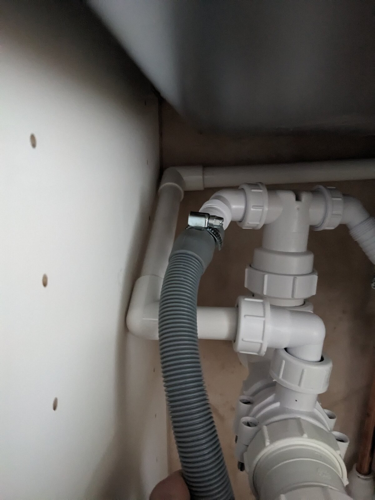

There is another white pipe connected to the waste pipe, is that not the condensate pipe?

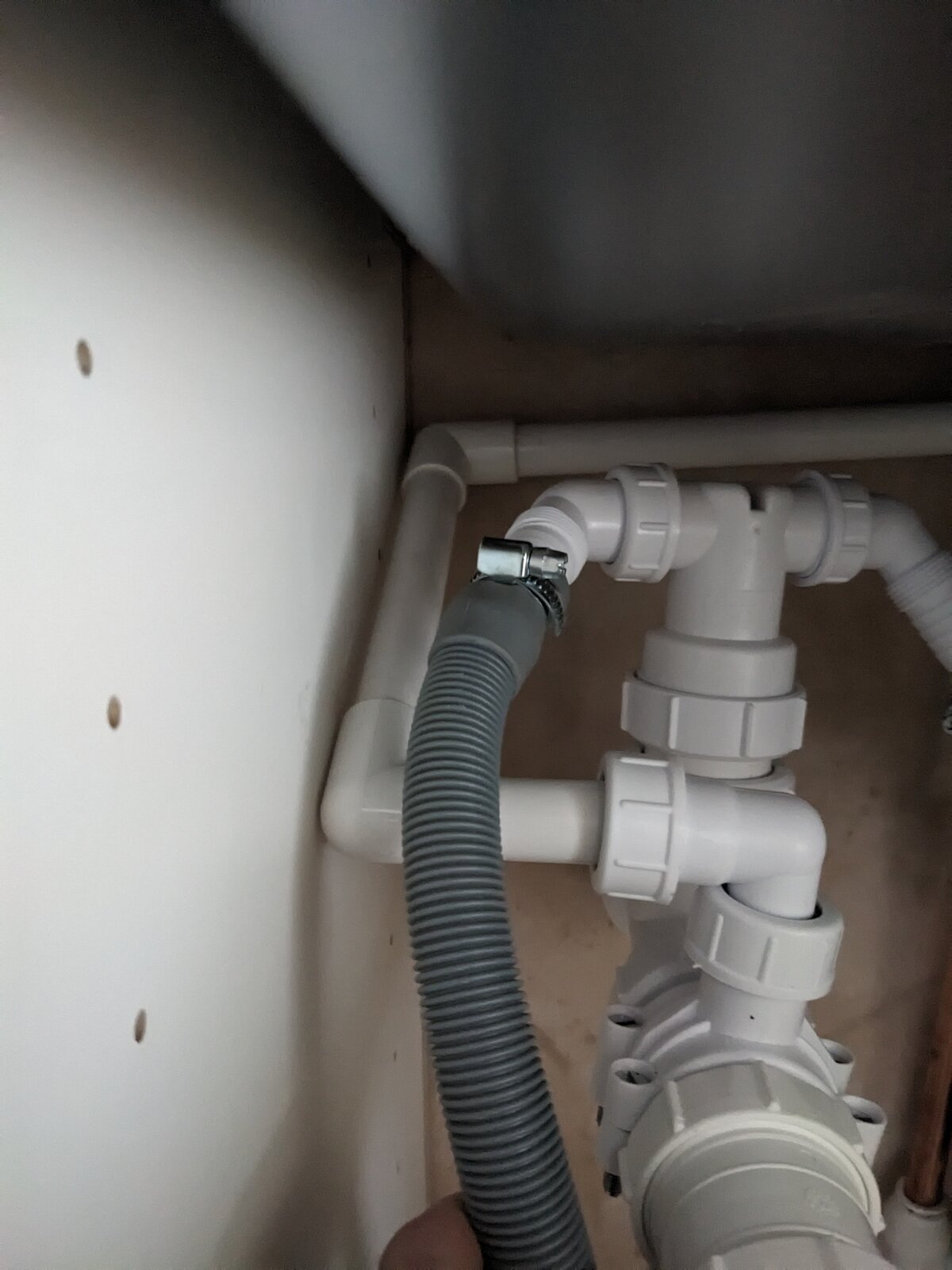

Ah, could be the angle...is this a better shot?

This looks like a kitchen fitter trying to do everything and failing badly at the plumbing.
OK @thomasbrig - I'm really sorry to say - that all needs redone -properly
1) At least he's used copper water pipe but has push fit when it could have easily been soldered and it needs to be clipped properly. Especially @ the appliance valve, as that will move.

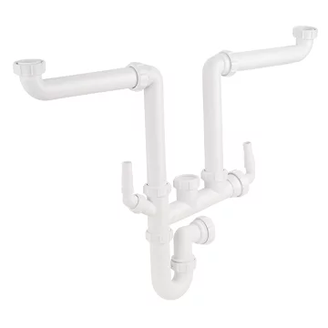

2) That IKEA waste and flexi pipe will be guaranteed to cause problems, how long is anyone's guess but probably sooner rather than later - that needs all that grey crap ripped out and a proper McAlpine 11/2 sink trap/waste system fitted (pic below)
3) that new sink trap setup comes with 2 appliance spigots so that double connector on the left outflow can be removed. The appliance drain hoses will need to be raised up properly. They usually come with formers/supports to allow the pipes to be raised up and over (pic below)
4) The condensate (from the boiler) should really have an air break, given it's plumbed into the sink waste like that. Typically then can block up with all the stuff that's typically thrown down the sink. It looks like it needs to be clipped properly too
What's the white pipe behind the waste trap in picture 2 from?
That's the condensate run by the looks of it m8 - you can see it tracking along the back, then heads forward and down at the left corner behind the drain hose and then across into that saddle clamp.

The Mcalpine waste/trap setup will fit any standard sink waste outlets. Well most of them, some seem to be a little tight into the sink waste hole and need altered a little.
