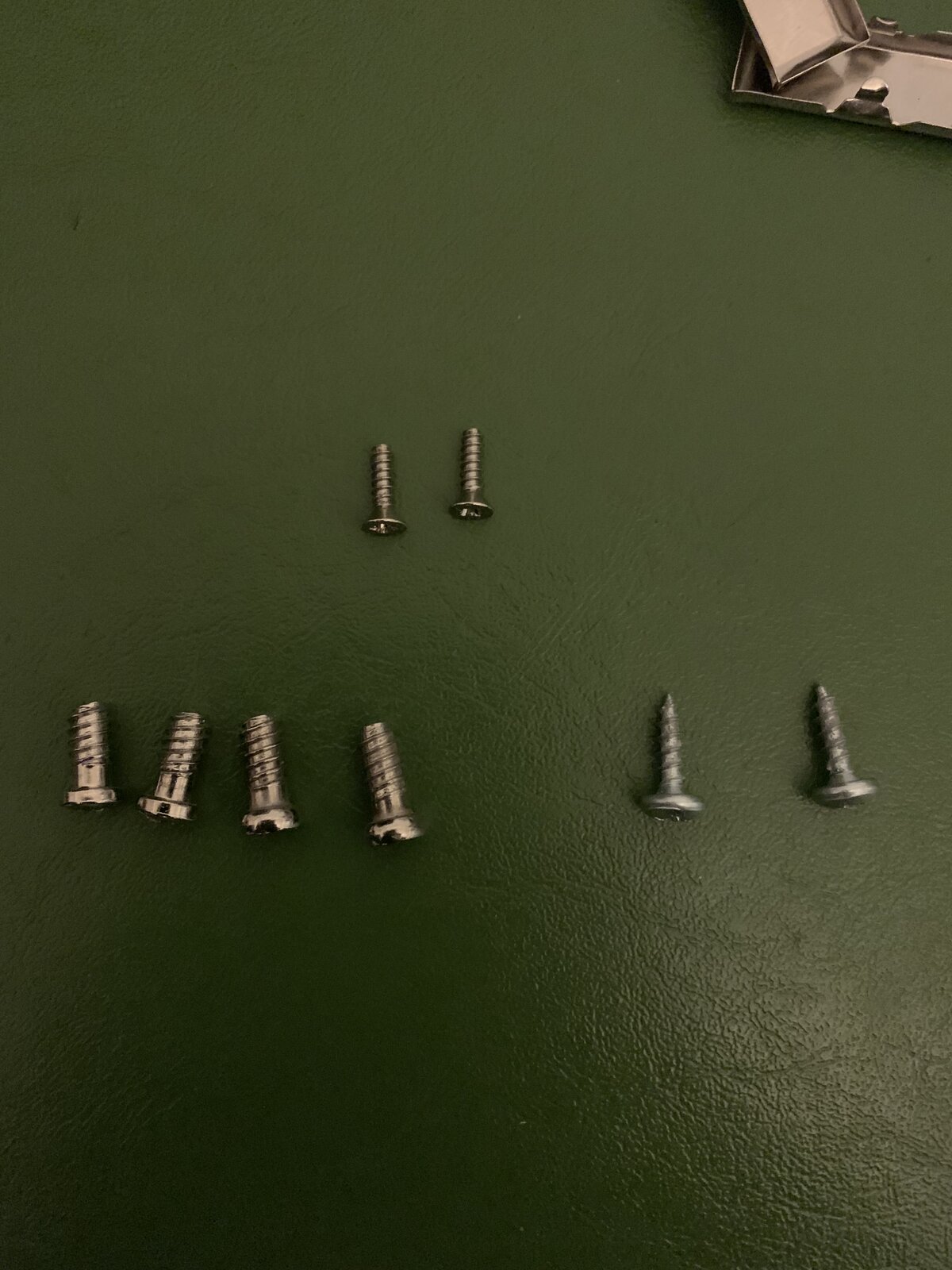

Please show us the screws you have.
I think your absolutely right so instead of messing around anymore I’ve found this cheap drill on Amazon which am gonna buy tomorrow:
Hoping this will do the trick? It does come with some drill bits but I’m not sure if it will have the right size drill bits so I think I’m just gonna get some. Do you need to buy specific drill bits for wood? Here are the screws that I’ve currently got. I’ll need to get the dowels and wood glue too. Any idea what size dowels I should get?
Attached is a picture of the three different types of screws I’ve got.

The four plated Euroscrews will be strongest, driven into pilot holes.
As they have no points, their pilot hole is the diameter of the shaft, excluding the thread, and has to be the full depth of the screw.
They are not used with dowels.

If the screws are not used with dowels what am I suppose to use to fill the holes first before drilling a pilot hole?
Before you start glueing in dowels, what is on the other side of the damaged cabinet hinge side? Can you access it? Could you use longer screws to screw into that or better still, drill all the way through and bolt the hinges in place?
The euroscrews john refers to are designed to give a good hold in the low grade particle board kitchen cabinet carcasses are usually made in. If you glue in dowels, which are solid wood, normal screws will suffice.
Nothing is on the other side and i can get access to it easily. Am buying a drill anyway am not messing around with fillers etc as others have suggested. I've already messed it up by screwing all the way through to the other side by using longer screws. Am gonna drill all the way through glue in two dowels and use a flush cut saw to cut any excess and then use to small wood screws to fasten the hinge. Hopefully that works and thanks to everyone who has helped really appreciate it.
If you've already "broken the seal", as it were, then I would bolt through to the other side. Can guarantee it will never tear out then, unless subjected to unreasonable forces.
