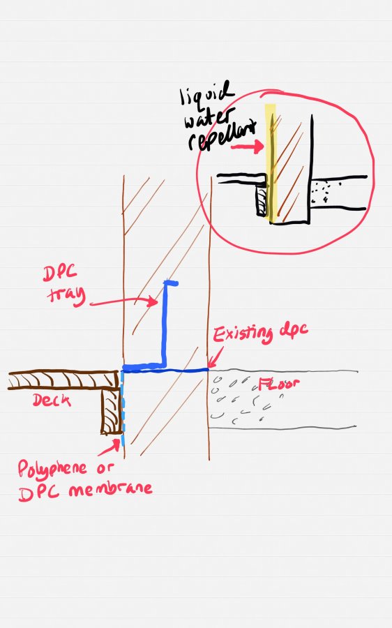

I suspect that your expert is not really one.
There will not be a vertical DPC in that wall because it would not be possible to have installed one, and one would make no difference at all to damp from decking.
The only DPC that would make the slightest difference would be a horizontal tray. This would be difficult but not impossible in a 9" wall. And it would certainly be evident from the removal and replacement of bricks.
No need for a new thread, I know what you meant, but it's your expert that is confusing things. And I wonder if his other conclusions are correct.
Here we go.
The main pic shows what your expert probably means but it's not practical.
The pic in the circle is a more practical solution with a quality water repellent brushed onto the wall.
