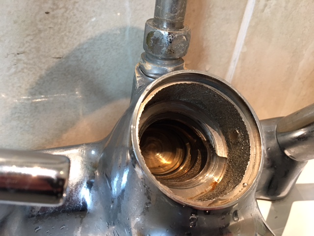

Apologies for reviving this thread. Managed to get the centre tap head off this weekend, however I am now stuck with another problem. The hexagonal nut (32mm) is sunken into the tap hence I cannot use a wrench to undo it. Any ideas what sort of tool I would need to get this off?

As @Burnerman mentions a tap backnut box spanner would usually be 32mm ended, try one of them.
I'll keep you guys updated once I manage to get my hands on a box spanner!

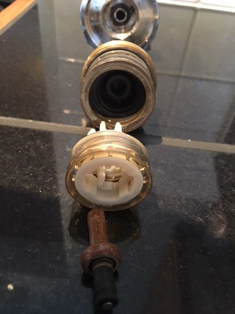

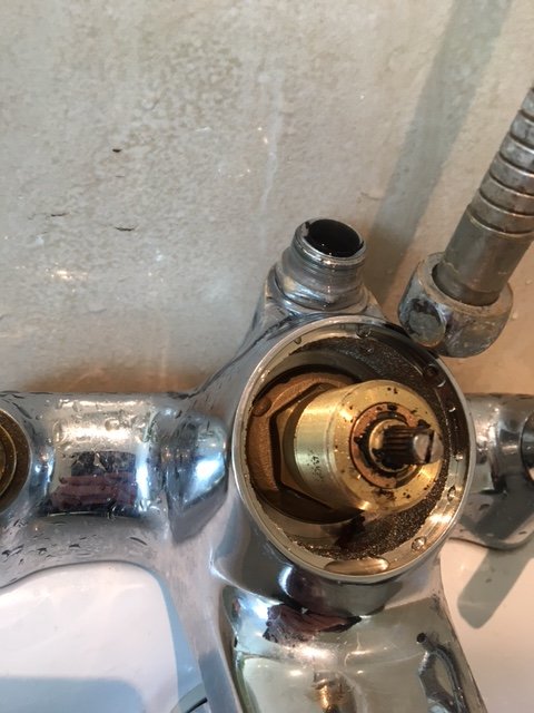

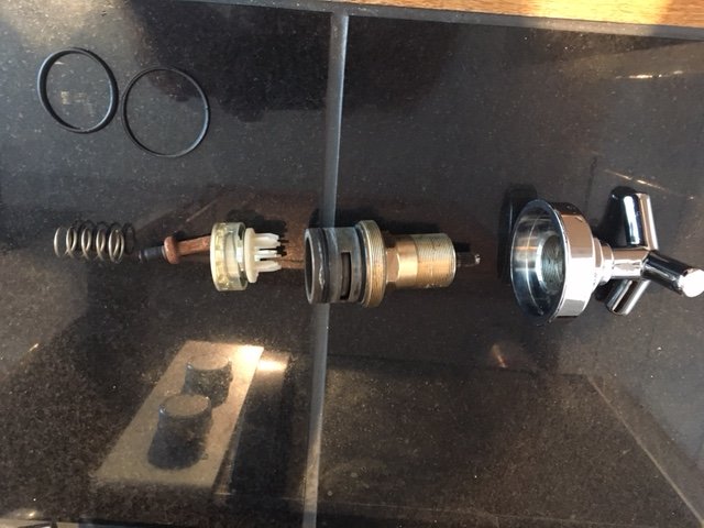

I ordered a new box spanner and managed to (albeit the box spanner being too big), using the coin trick, undo the nut. Underneath the nut there is a cartridge, see below.
I took the cartridge to Plumbase and although they could not identify it, Plumbase told me I need a new cartridge. Looks very similar to https://www.showerdoc.com/sirrus-1503-series-thermostatic-cartridge-assembly-skbq1503-973c however they are kindly going to investigate!
hope you remember how that all came out :sneaky:
It'll be that bottom rod piece that controls the water flow with the thermostat being higher up, it'll be the lower piece that needs serviced/replaced if it was a drip you were getting but it may come as a complete set.
I was just about to say the same thing madrab. Hopefully that's the part you need I'm shocked by the price though it's no wonder taps are becoming throw away and replace.
